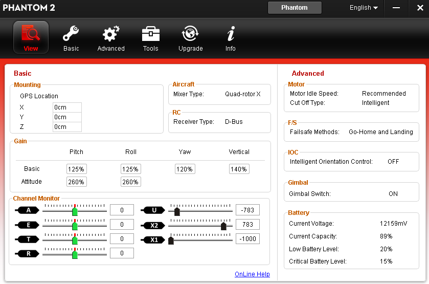

Connect the P2 to it's software and check which Mode you're in either Phantom or Naza. You'll find that on the line of the software.
Here's what you should see during the compass cal. Now I did a complete circle for both the horizontal and vertical just for a demo. Make sure the S1 switch is at the top.

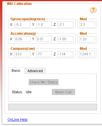

Then what you need to do is connect the P2 to its software and check the compass raw MOD settings under the tools tab. If the setting is below 1300 or higher than 1600 you may have a magnetized compass. But first, do an advanced compass calibration not basic nor IMU status. If those numbers are lower or higher watch this video.

That IMU MOD number isn't good at all. Should be around 1400.
