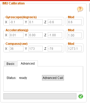

Do another advanced IMU calibration and post a screenshot of the results. The IMU should be done on a level surface.

I already managed to leave the values correctly. However, when the flight starts, the drone does not remain stable and after a while they turn on a red LED. Really fly it is totally impossible

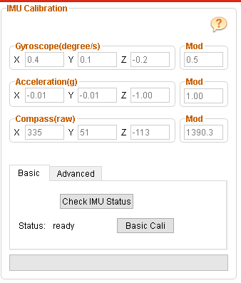

Now since you have had in the air I would like to see a new screenshot of the IMU compass MOD. With the S1 switch in the upper position (GPS) and it will not stay put when hovering that screenshot will tell me what might be wrong.
110647
That IMU compass MOD is so far off you will never have any control over your P2. The compass is magnetized and until you demagnetize per the video there"s no way anyone can help you.
