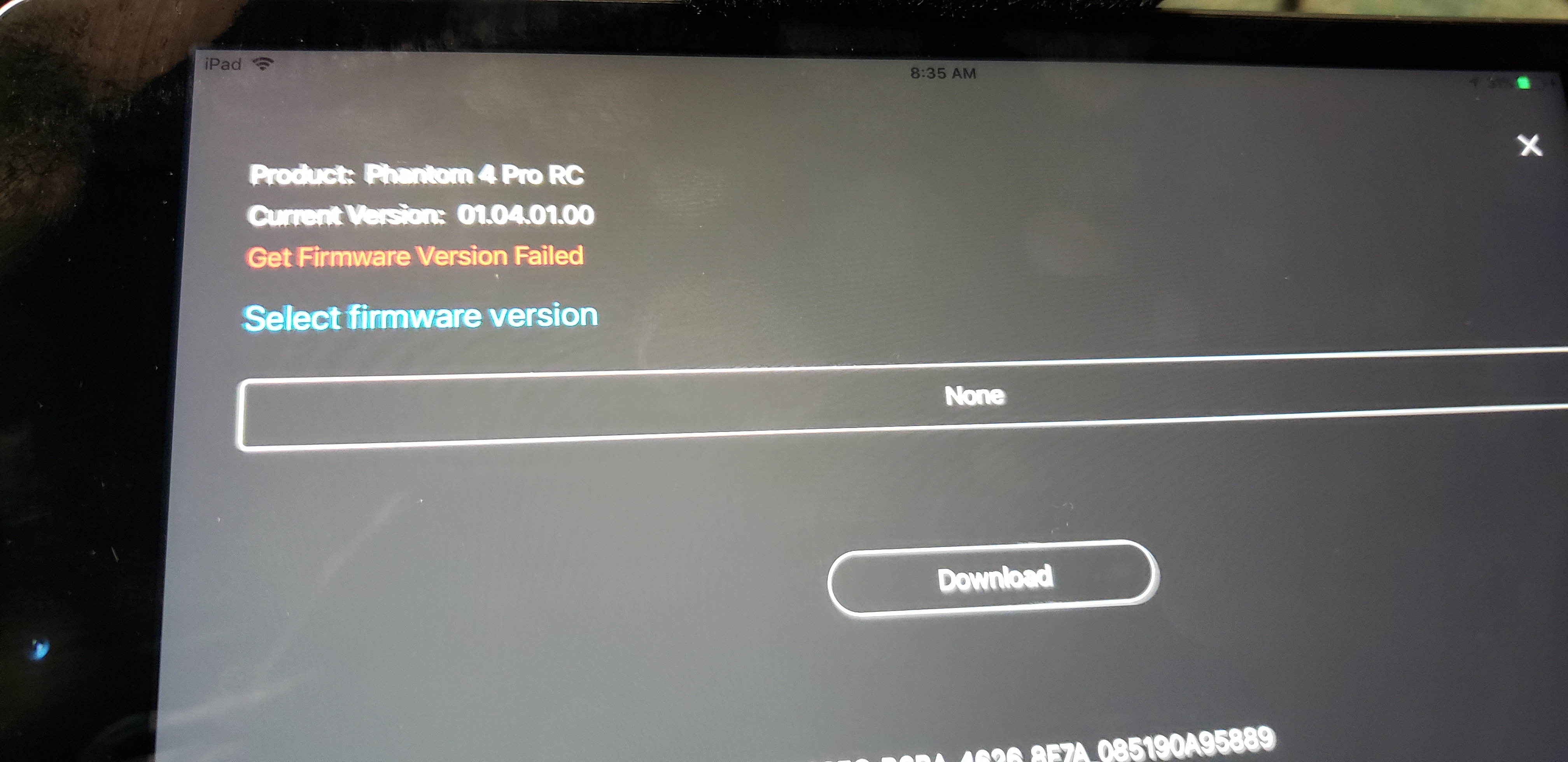

I did this and it wouldn’t Let me go back to earlier FW and at first it didn’t want to refresh the current firmware. It kept saying “you’re on the latest FW however I kept pushing and holding over and over until it asked me did I want to reinstall the current firmware. I did and it fix my problem. I’m using an iPad mini 4 with no problems. I also deletedo a lot of pictures out of my iPad to give it more space as well. Basically just refreshes the current FW.
I guess the only thing I can do is try thank you
If my aircraft is turned on at the same time it won't connect. If I turn the aircraft off it is fine but then tells me to stay connected with the aircraft throughout the installation. I must not be doing something right
I had to keep trying over and over before I finally got a prompt "Do you want to refresh your FW" and I clicked yes. X-out and then hold down on the 3 lines until you get the page that has the none like your screen shot, then hold down on the "none" and see if you get the prompt that I did.

It's my understanding that this just rolls back your RC firmware, and not the bird. I only have experience with the Inspire 1. Is this not the case with the Phantom and Mavic series?
Oh...okay I see... I didn't know that you hold down the none
