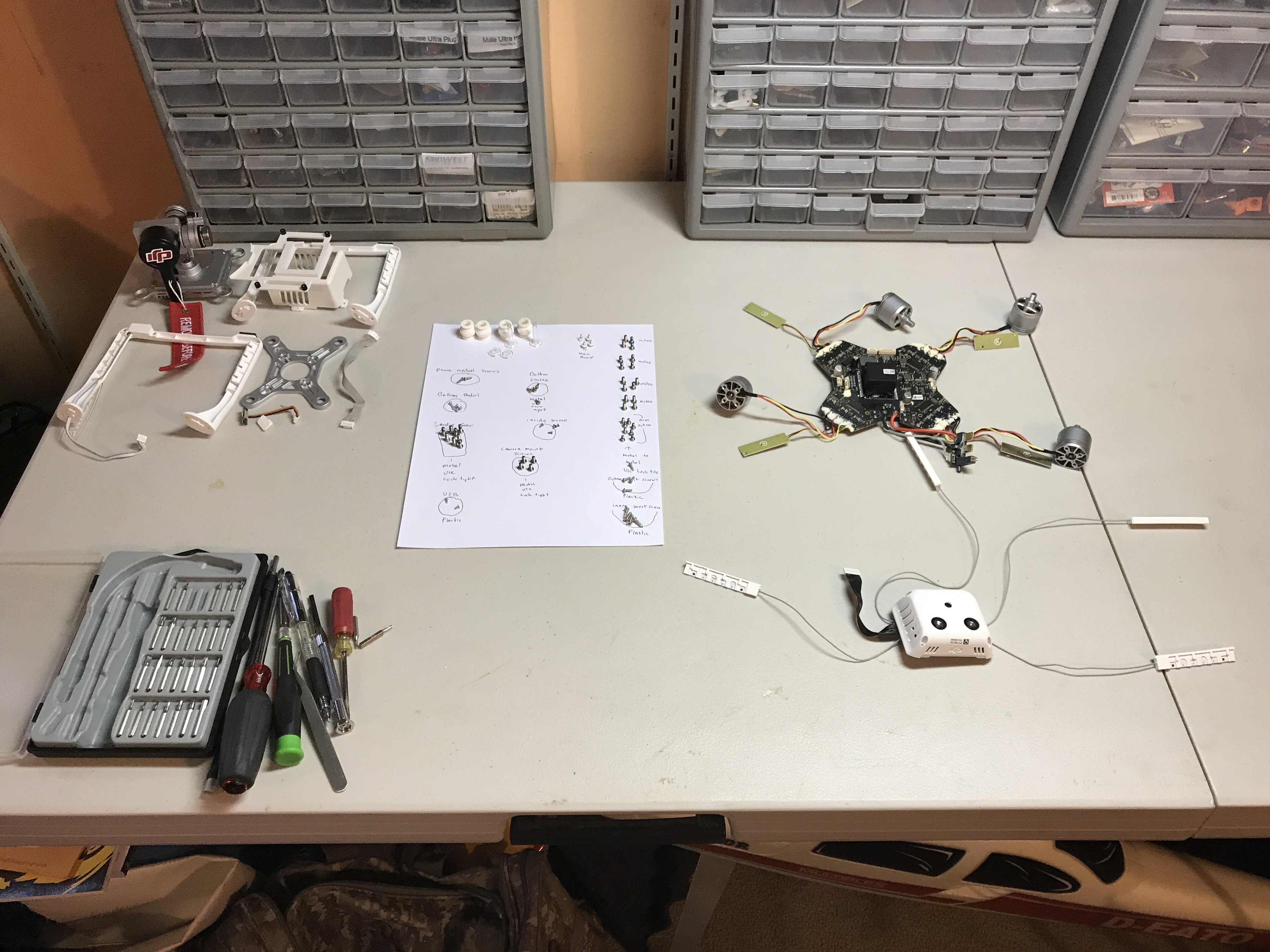

What a difference a good night’s sleep makes. I woke up in a much better mood and ready to disassemble my P3A. With the help of iFixDrones video I now have it completely apart. Hindsight being 20/20 and with that video it wasn’t as bad as I was anticipating. The only part I haven’t removed yet is the GPS module from the top shell. I want to keep that together just so the sticky foam cover/shielding doesn’t pick up dirt and dust while waiting for the new shell.
BigA107, you are right. I found more cracks around just about every screw mount that has the threaded metal inserts. I am glad now that I went with a completely new shell. I will follow your example and carefully strengthen the new shell before reassembly.
Sorry for ranting, I may have had a lot of bad things to say yesterday about DJI but I do have respect for their electronics. The inside of the P3A is a lot more impressive than its outer shell.
