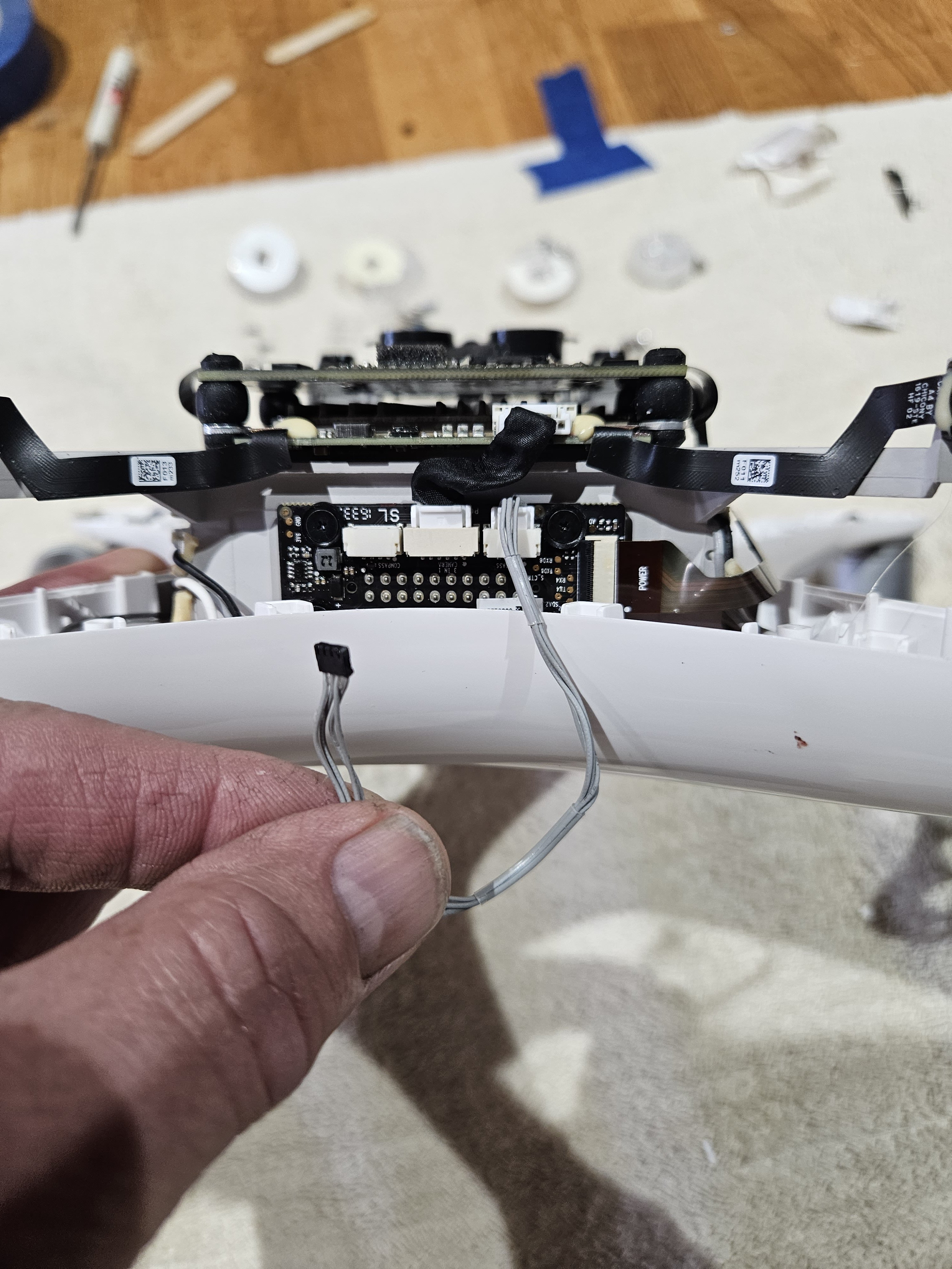

Good day everyone. I was given my brother's crashed phantom 4 to repair.
My first DJI phantom. Thanks to this website and videos I was able to disassemble the broken shells and make needed repairs to broken plastic. I'm ready to assemble and I have a mystery wire conection. I need some
help to find where it goes. I thought it would be an easy question for you smart people! Thanks for any help!

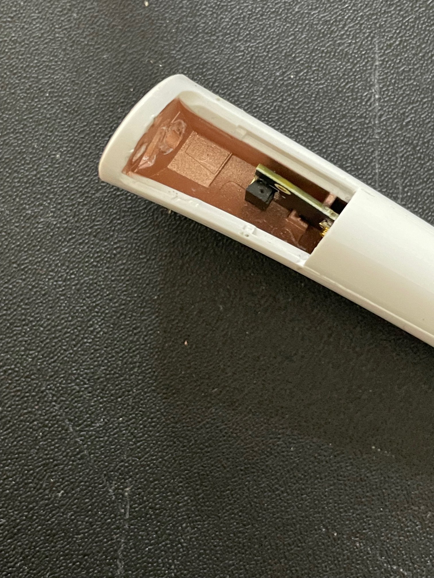

Yes that is the compass wire. It connects to the compass which is in the leg on that side. If you need photos let me know
