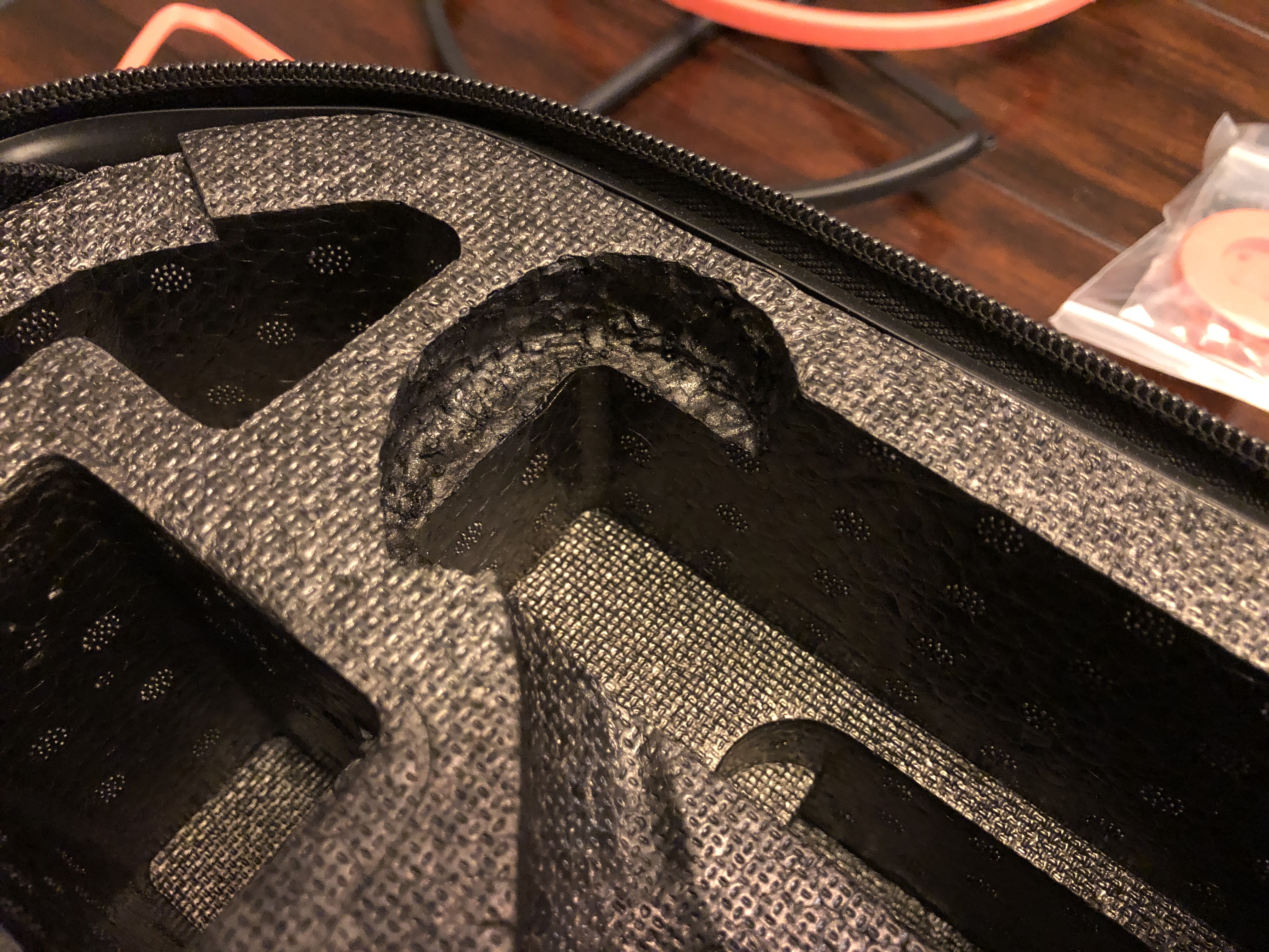

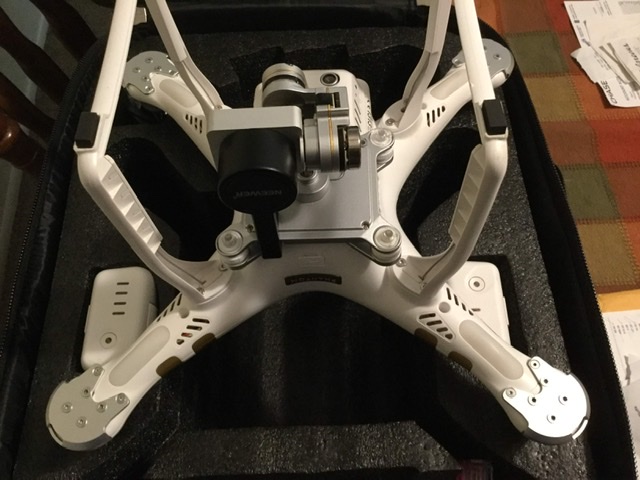

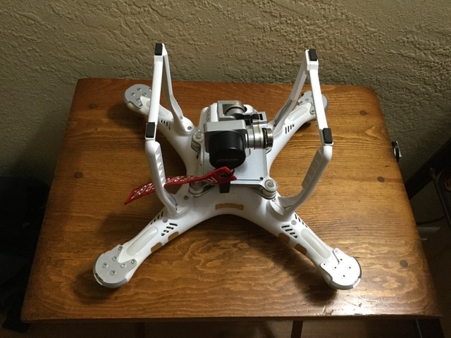

Glued, sanded, reglued a couple spots, and strong arms installed. Hopefully this is the end of that issue, but what I didn't think about, is that it now doesn't fit in the case. So I need to enlarge the holes where the motors go.
Yes, I had to do this with my P3P backpack case with foam insert. I used a heat knife to make it as clean as possible.
That's the same backpack I have. How much did you have to take out? I haven't started but was hoping maybe an 1/8 inch or so. I don't have a heat knife so I may just try a utility knife.
Based on your photo, I suspect that the profile of my prop guards is wider than your reinforcement plates, and I'm not exactly sure how much I ended up taking off. Your best bet may be to set the Phantom down in the foam as far as it will go, then draw a line on the foam around the edge of your plates. Then cut right up to those lines. I'm actually currently selling my pack and other P3P accessories; listed in the classifieds here on the forum. I had two of the exact same DJI backpacks, and modified one but kept the other stock, in case I ever took the prop guard mounts off, which I ended up doing.

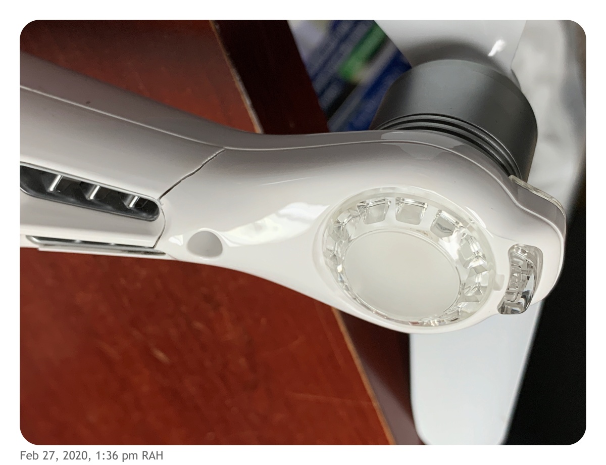

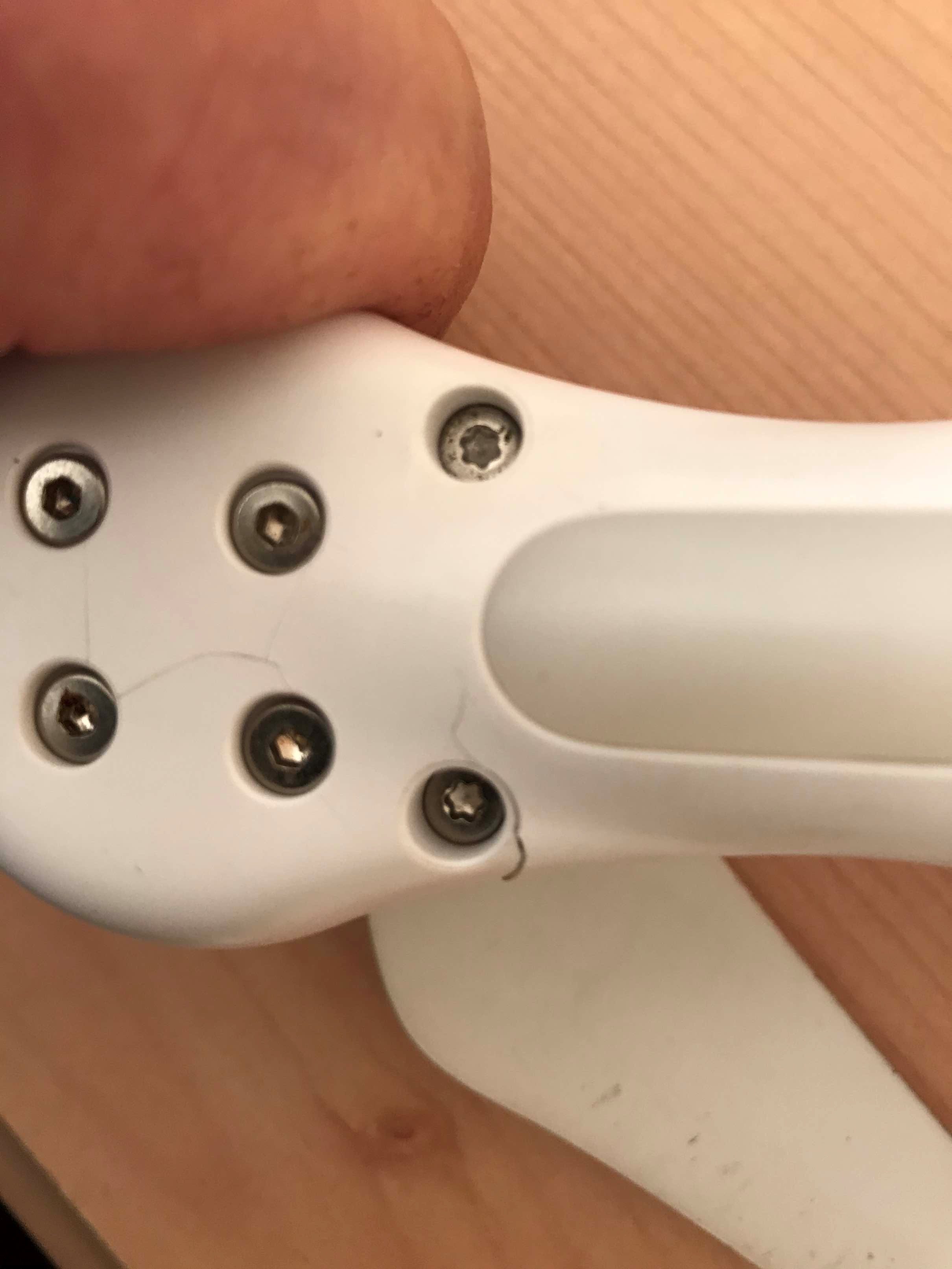

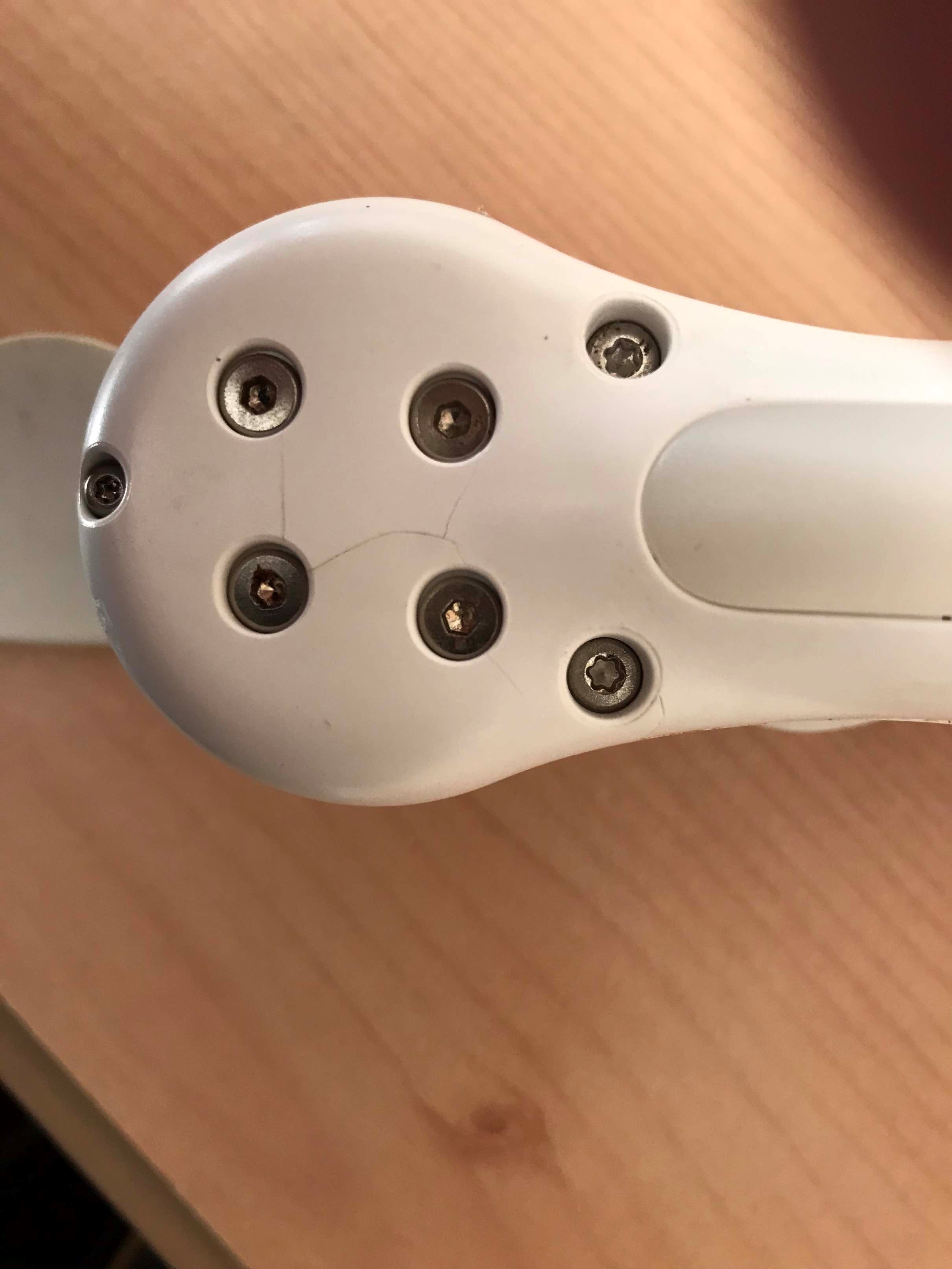

I've had cracks round the motor mounts on my elderly P3P for around 4 years, but they don't appear to have got any worse UNTIL a recent close inspection with flexing the rotor arms by hand revealed this crack beside the shell screws. The photos are of the same arm, the second one is with the arm flexed. This is an alarming development, and will need to be repaired. I'll pop off the top shell, (YouTube is useful here) remove the motors and use Plast-aid, working from the inside and forming a 'puddle' of well diluted Plast -aid around the cracks, flexing the arms while it's still liquid to ensure it works into the cracks. IMHO, Plast-aid has to be better than superglue and baking soda, as it actually fuses into the shell material. Both the rear arms are in the same condition, so I'll repair them all.
This way I don't need to completely dismantle the P3, but I do get a robust and neat repair. I'll let you know how I get on..
