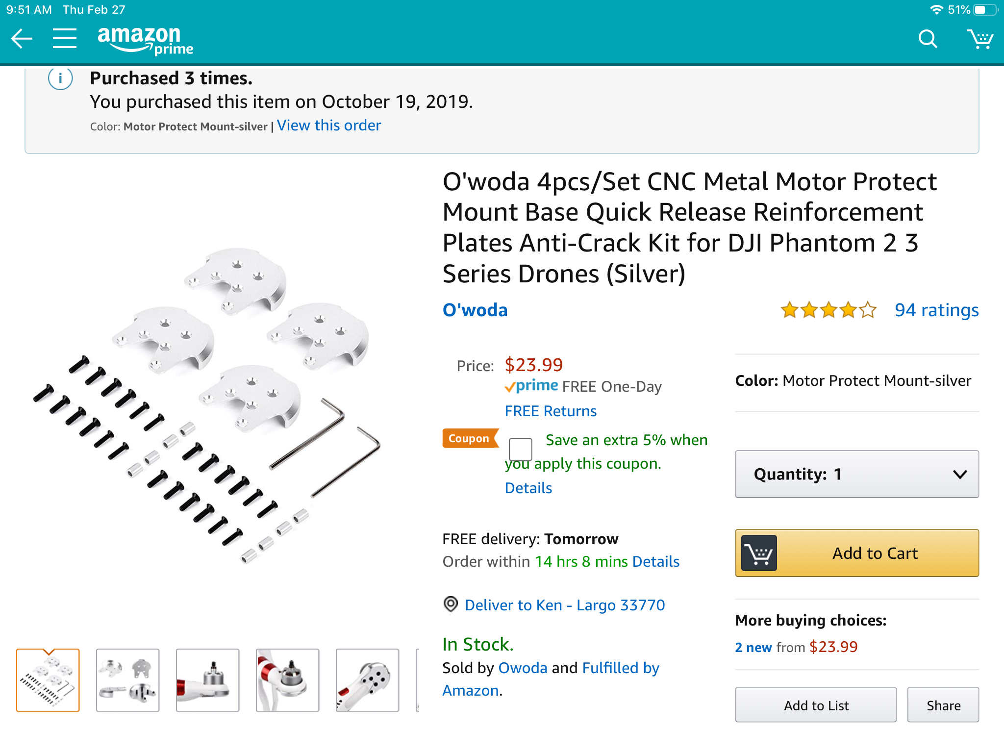

Tried-and-true Owoda brand aluminum motor supports. Inexpensive and no glue needed. And they look awesome.
Just a couple of the several I have done. No P3 left my house without them.
