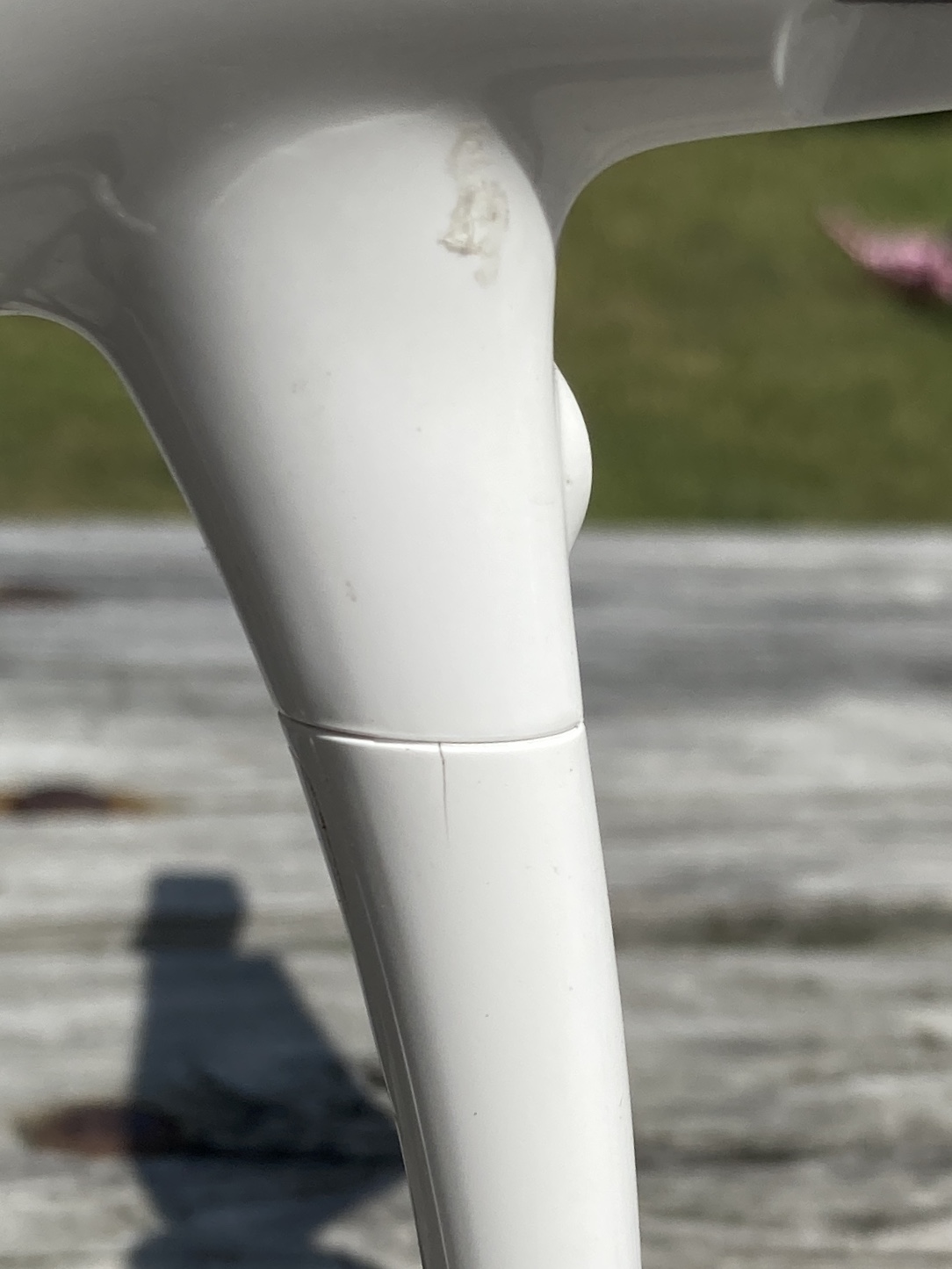

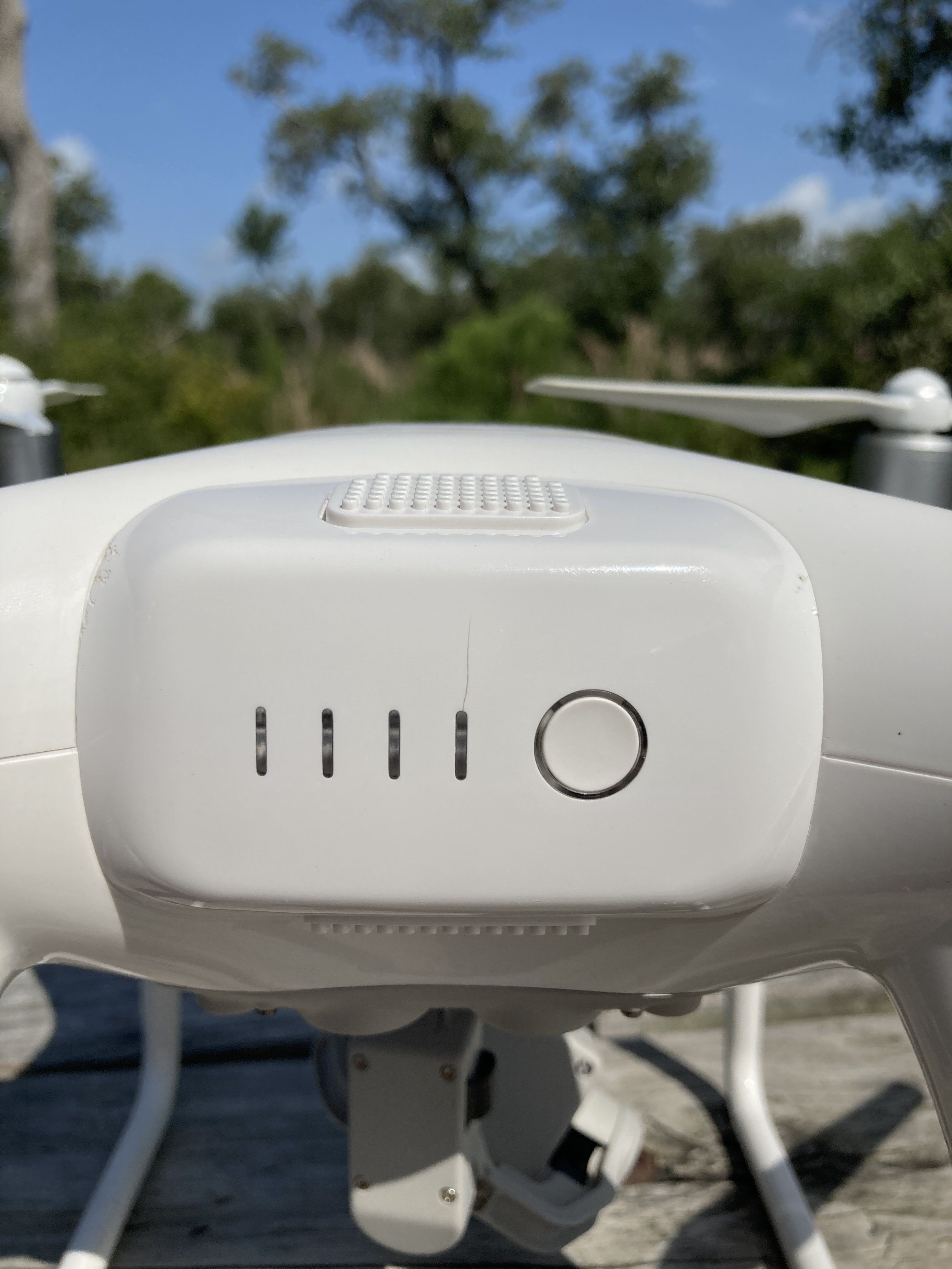

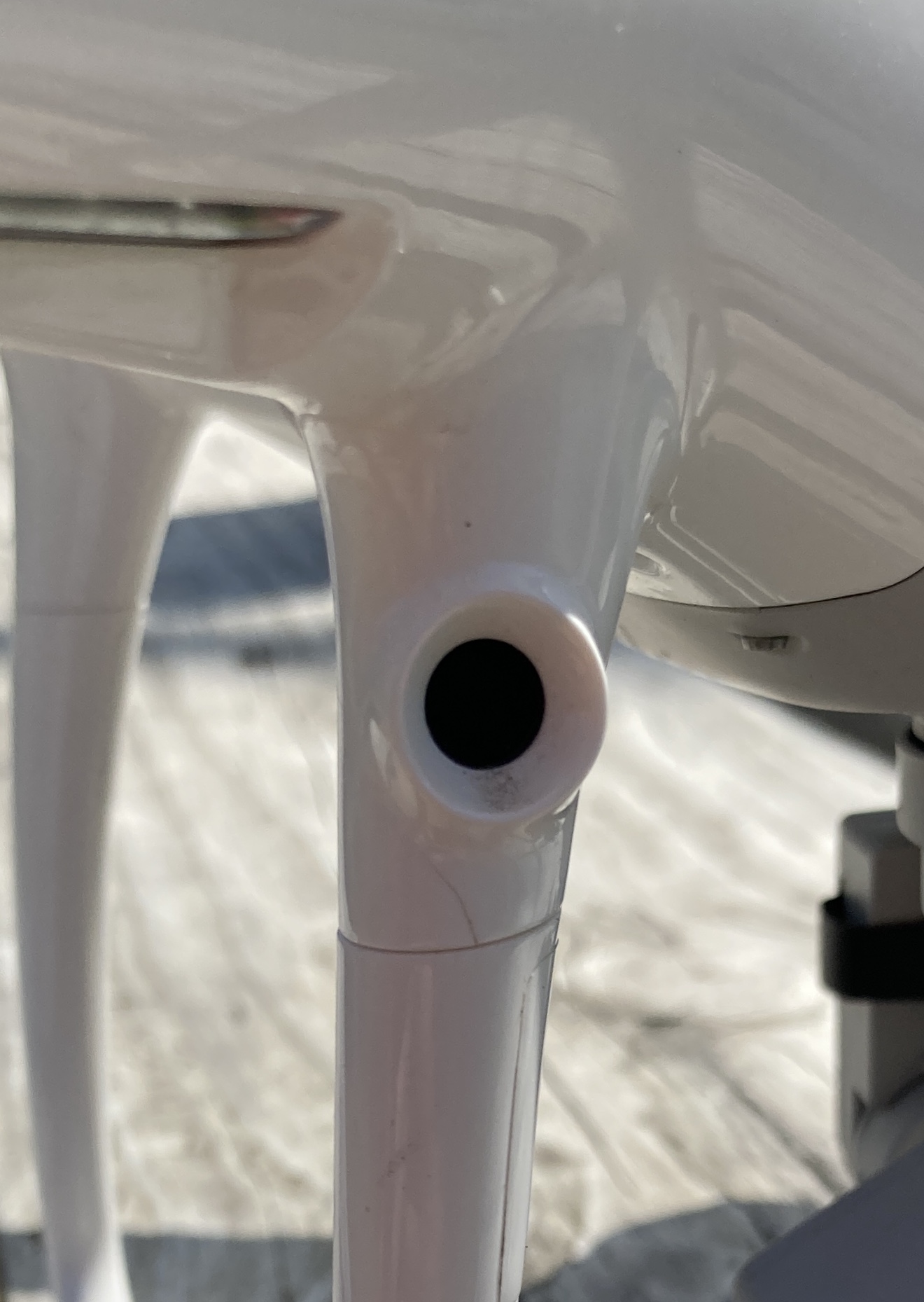

I’ve had my Phantom 4 pro since late 2016. It had been it storage in my home for about a year and when I landed the other day I noticed several small cracks on the landing gear. I also noticed a crack on the battery casing. Should I be worried about this? It has not impacted performance at all yet...but is that something I should be concerned about? I don’t really have the money to send it in for repair right now, but is there something I can do to keep the cracks from growing and becoming a problem?
The crack in the battery is a known flaw with DJI phantom batteries. Some people take the cap of the battery off and reinforce it. Most people just keep on flying with the crack. There are many post in the archives on how to repair the cracks in the plastic. Cracks in the legs will never affect the performance, Just be careful of the wires that runs down in side the legs. It should be fine the fly at this point, just monitor the situation.
Haven’t seen it personally and I’ve owned several. This issue seems to show up occasionally from a bad run of shells. The flaws you show should not cause problems but is disappointing. Some have claimed it’s worse, or even caused by, hand catching. Up to you, be safe.
This may sound off the wall, but when I was shoeing horses years ago for a living, if the hoof had crack running up the hoof, I would take a drill and drill a small hole at the very end of the crack, did not go deep, maybe an 1/8 of an inch. Hooves are like fingernails, no feeling. My point is that you could a really small bit and do the same thing. JB Weld now makes a plastic epoxy I would highly recommend. Would not need much on any of the cracks, the epoxy would stabilize the crack. Take your pick of do both.
