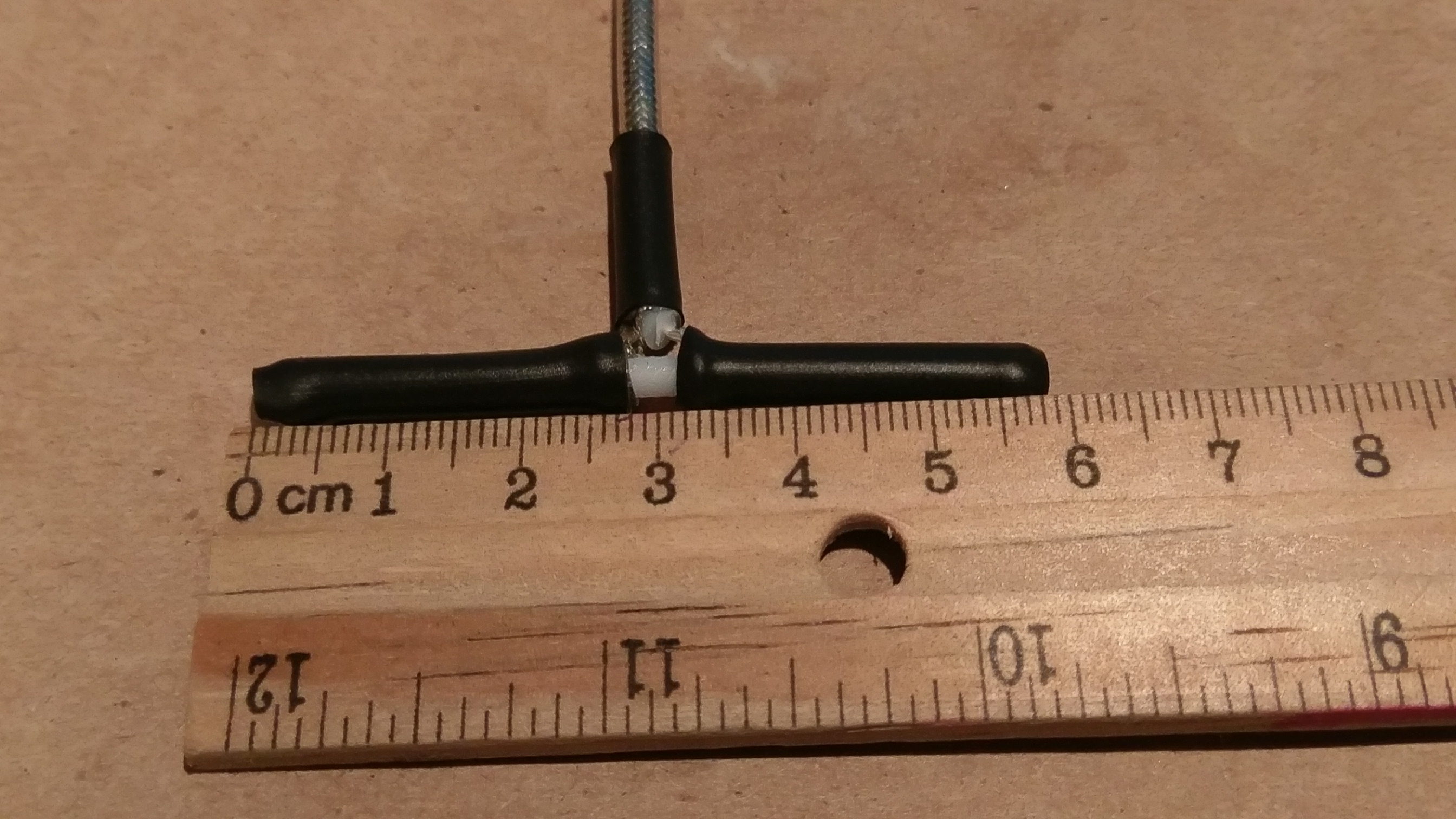

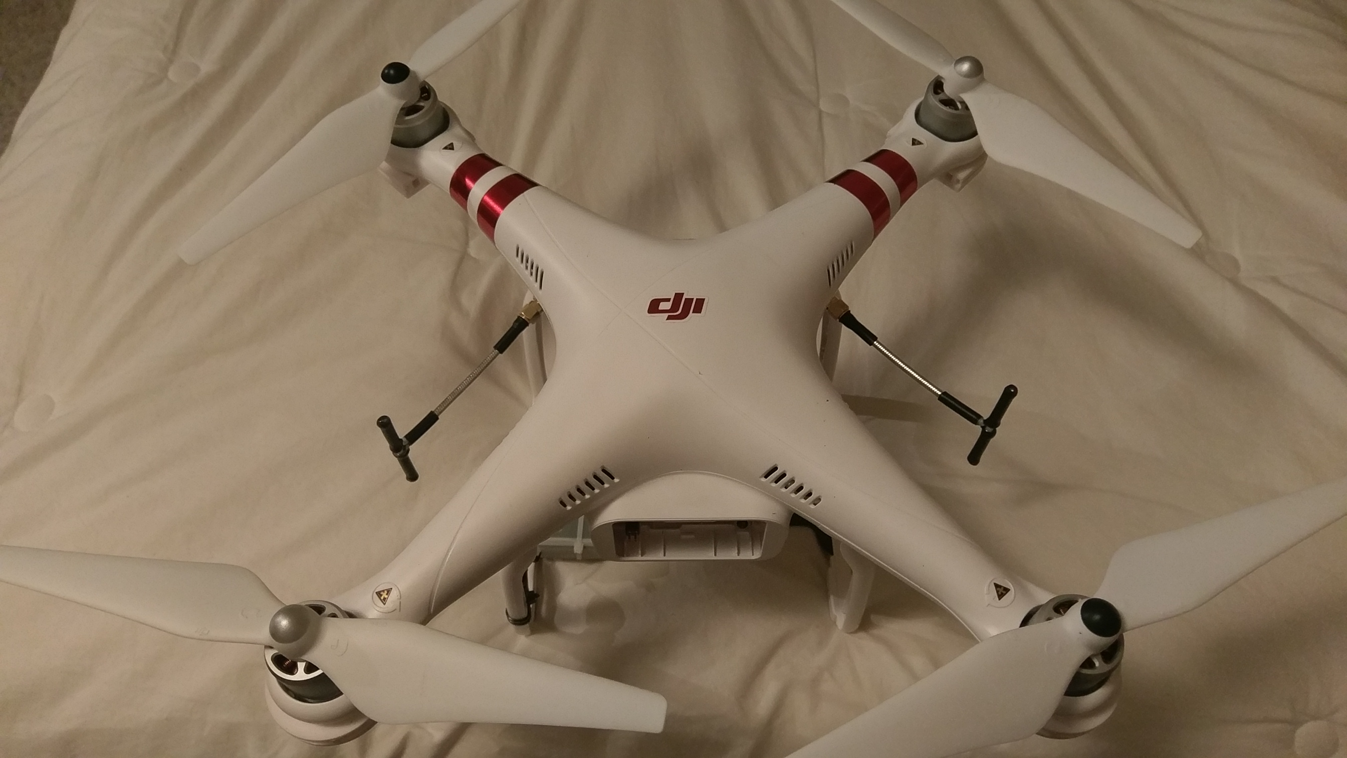

Did this tonight, will test fly on Sunday when the weather should be good.
Got out today for on short test flight, one battery. Hands started getting cold. First off the place I went today was not my best location for a good range test. The first 1000 meters is farmland, but after that it becomes dense residential. Got out to 2172 before I started losing signal and RTH tried to kick in, but that could have been partly my fault as I was having some issues with aiming my DBS correctly. The line on the map (drone to me) was way off at a angel, like almost 45°, so as I got farther out it became harder to be dead on. But in my view the test went great, as I don't think I'd would have made it that far in this location without the new antenna. But we know it sure didn't hurt with range or signal strength till 2072 meters (first error), and again that could have been me.

I'm a little confused about how to access the bird's rf connectors. Are they accessible from the belly by removal of the gimble? I thought you had to open the bird up from the top.
I found a video on Youtube.... it looks like you just pop the 2 "anti drop" pins. Then you take the 4 rubber white dampers out. Then there are 2 little doors on top of the gimbal, each has 2 small phillips screws holding it on. Remove those. Open the doors. Then pop off the u.fl connectors. In other words.... NO.... you don't have to open the bird up. I'll try to find that video again.
