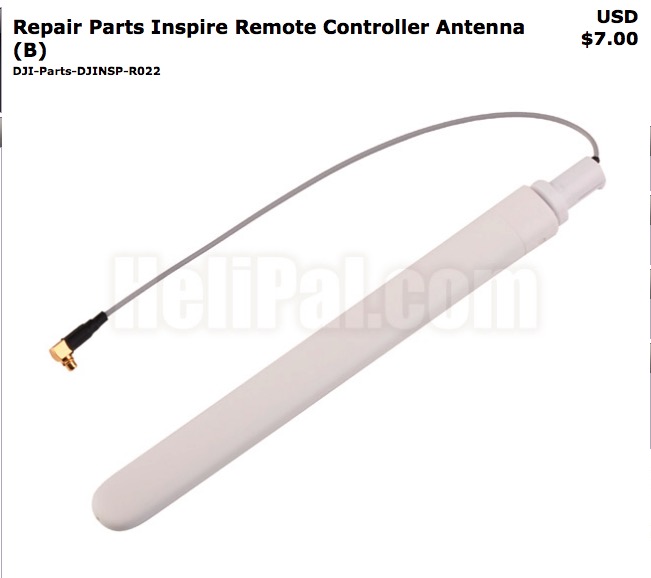

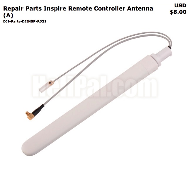

Ok fixed it all guys. Flew to 14,000 feet and back which was the farthest i ever went!
Before i was getting about 4-5k before weak transmission would pop up.
Today i flew to 10k at 40ft alt, weak signal appeared. Stopped, went up to 160 ft and flew to 14,200 ft with no issues until weak signal appeared.
I think if i went higher to 200ft or above, POSSIBLY i would have flown a little further, but didn’t want to risk it, since i saw a low flying aircraft at the beach and did not want to have a chance of an accident so i stayed well below 200.
I’m super happy, did it alp myself, was easy as a cake and replaced with OEM 2.4 ghz antenna from inspire one, got it from ebay shipped from hong kong for $10 shipped and it arrived quickly as well!
