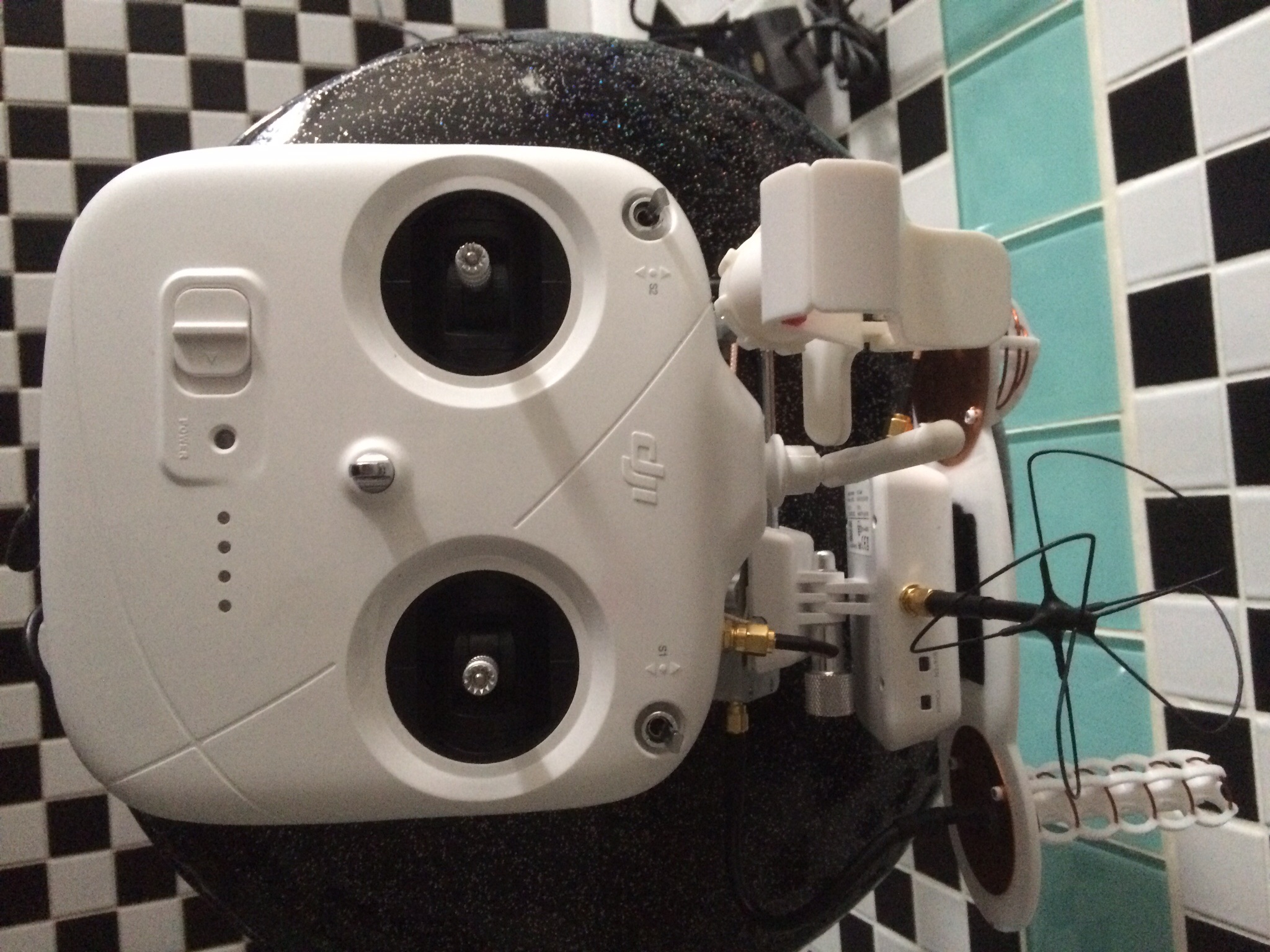

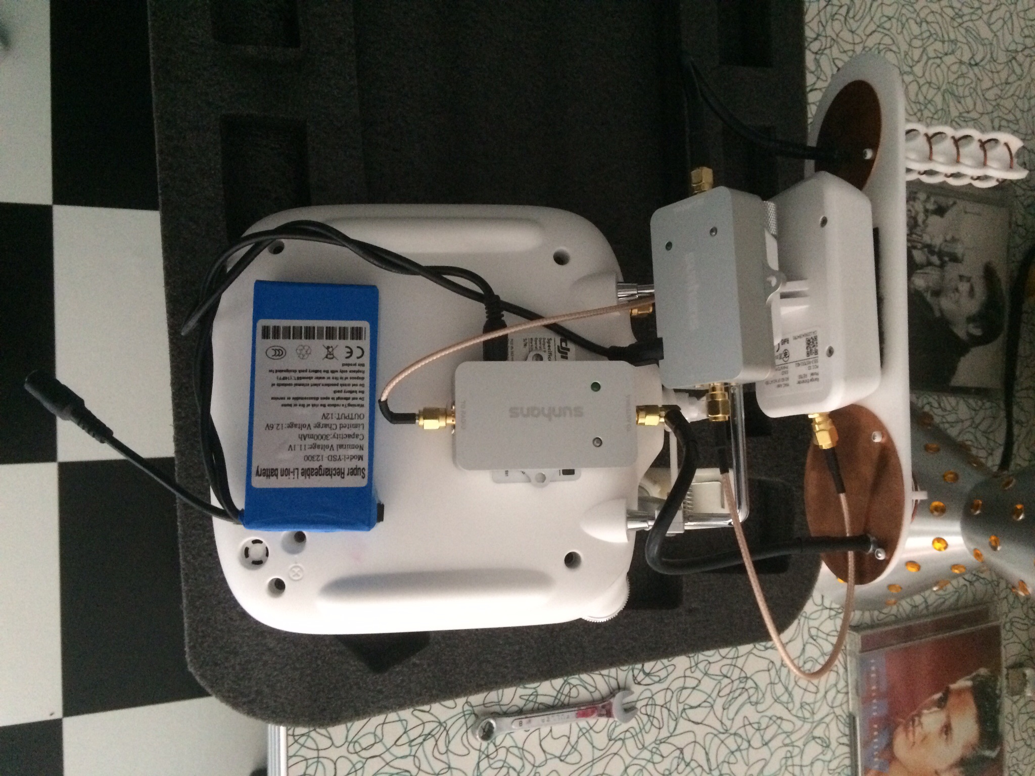

Just received my installed Stage 4 from Fpvlr. Dji app. saying " broken connection " even before I take off. Now camera just stopped tilting up and down. Any advice would be appreciated. I'll try to include my controller connections. View attachment 17081View attachment 17082
Re-bind the range extender and then once that is done power cycle everything and try again
