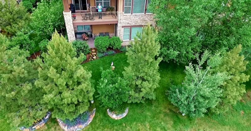

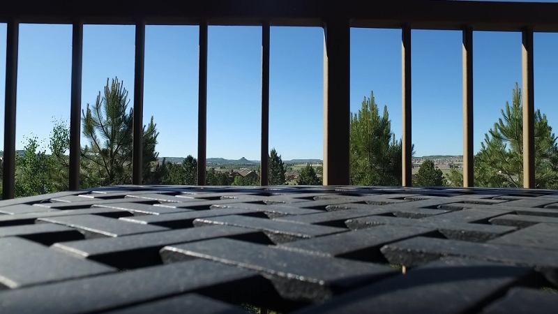

I've been flying from my covered deck for more than a year with no problems. I prefer using it because I have line of sight for miles. Below there are too many trees to see around.
My launch pad is an aluminum table that is next to a wrought iron railing. The aluminum is ok, but the wrought iron could certainly present a problem. In my case, it has not. I always confirm there are no odd readings before takeoff, then up and away from all the metal. I then reset my home point mid air for a clear landing area (remember it's a covered deck.) Upon returning, I hover in front of the deck and hand catch it. Easy peasy, hundreds of times. Never if it's windy though.
View attachment 84401 View attachment 84402
LOS is key! Whatever it takes to get it! :cool:
