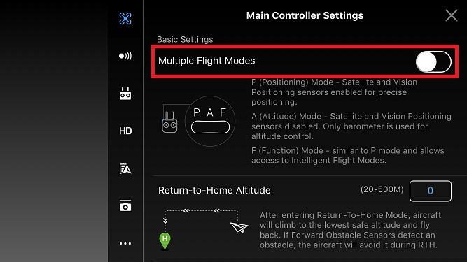

Hey,
I'm not sure if this is due to a recent update to the DJI Go app and/or the firmware update on the P3S I recently did, but the S1 switch isn't working on my remote. It is stuck in GPS mode, and the switch to change to Atti or Intelligent Flight Mode do absolutely nothing. I'm a little stressed because I just recently got this drone. Could it have a hardware problem already?
Any help would be appreciated.
Did you enable Multiple Flight Modes in DJI GO?
It's an old setting. You should double-check your settings after installing new firmware since they are reset to the defaults.
