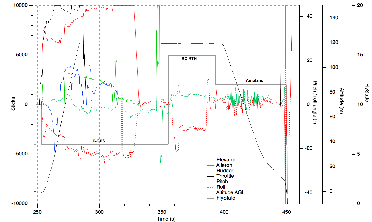

I got an "RTH cancel failed" error on a flight. Hit it again and regained control.
Next flight it RTH'd into a tree despite my hitting the DC button to cancel or trying to stick right to dodge the tree. Guessing lost contact to the remote but don't see that in the log.
RTH cancel fail suggests that there was no connection to the controller and so there was no way for the cancel message to get to the Phantom.
The flight log attached shows you never lost full control signal and it does not show you cancelling RTH.
When it crashed, it was still in autolanding.

Looks like all the errors probably happen after the impact of the tree?
Possibly, just did a quick glance without going in to ms analysis....
Not sure what to say about that log. It appears to describe an RC-commanded RTH that descended into a 30 ft tall tree at 449 s, with only a very brief and half-hearted effort to avoid. What am I missing?
You're probably not missing much. I was pretty freaked out. Maybe I didn't hit the button long enough; or too long so the RTH didnt register.
Night wolf I’m still just learning these logs but to me it looks like it was still in auto land mode at the 30ft impact. I’m not questioning your assessment just want to know how you came up with it. Thanks for your input [emoji106]
I agree from the log about 30'.
