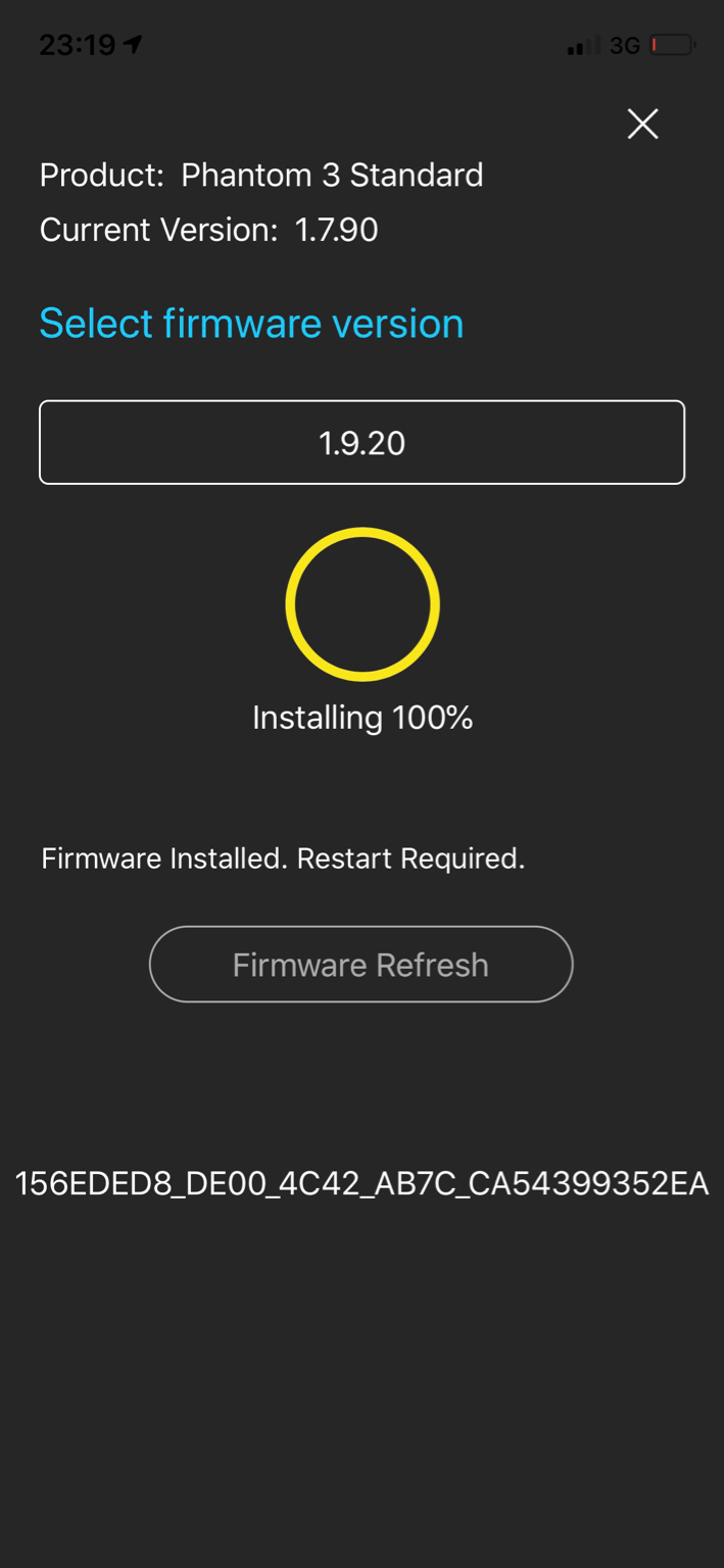

I get this message after trying to update.
It says successful but I'm not sure.

Does anything work now after the update?
Don't think it updated. Couldn't see any lights above camera, certainly no green to red flashing # no sounds after half an hour.
