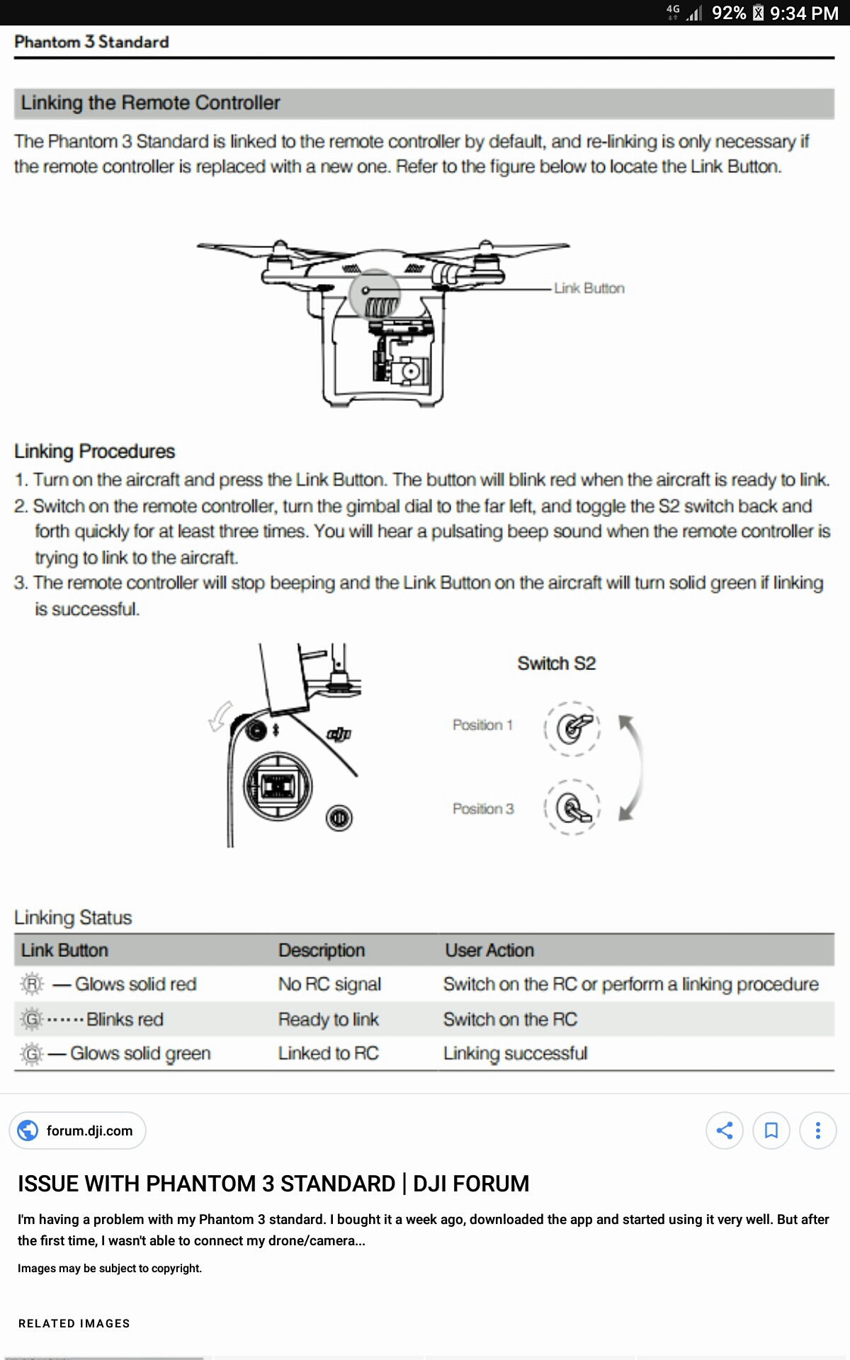

Try manual link,,,its wifi so cable wont work ,,front lights always red,the rear tells you what goes on

Just to make sure the Link light on the Phantom is the light in the same hole as the link button, nothing to do with the lights on the arms below the motors.
