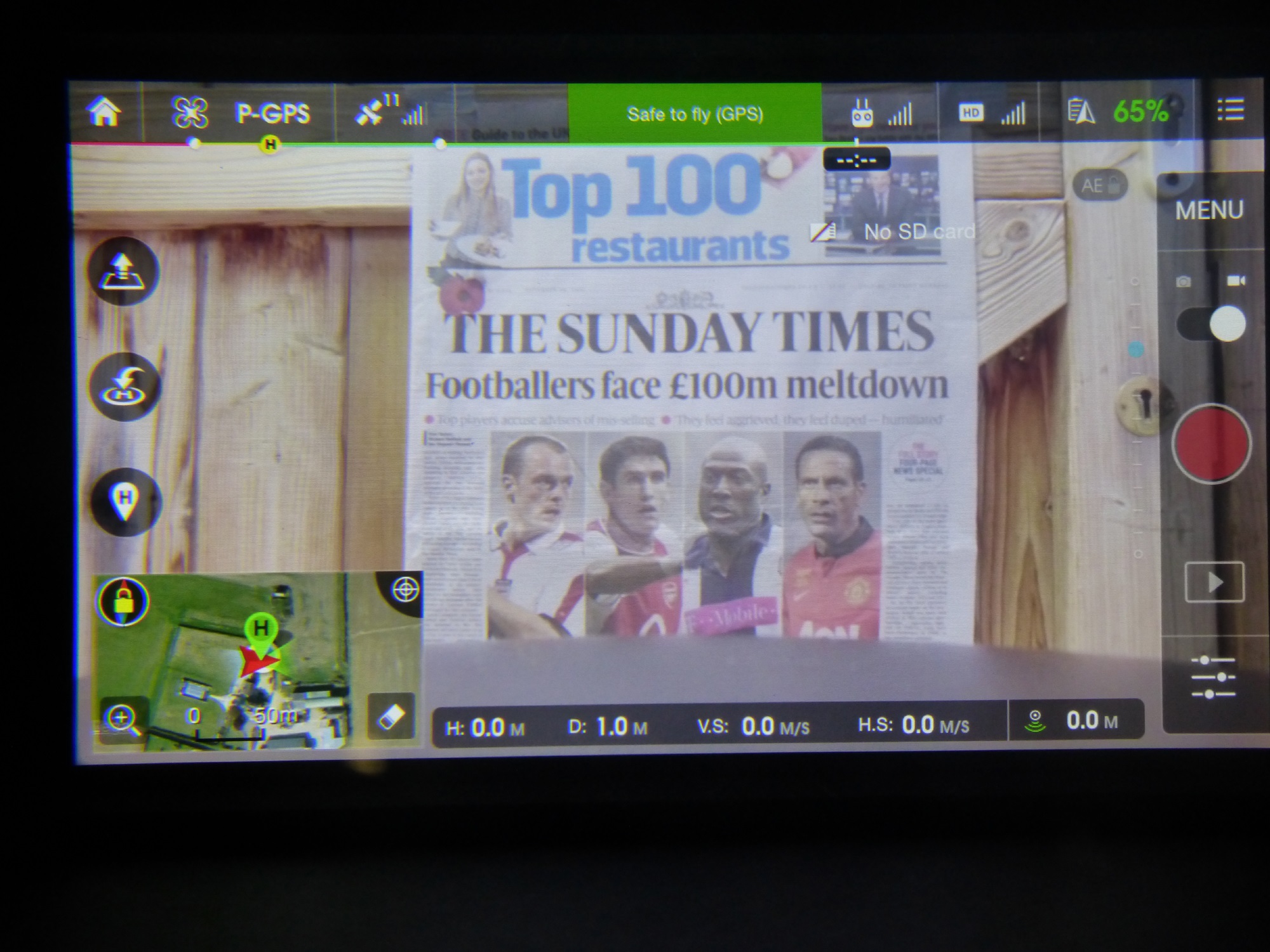

View attachment 35367 Here is a snap shot through the lens of my homemade fpv goggles. This model uses a single 3 x glass lens.
As you can see the clarity and definition is good, certainly better than anything else that I have seen so far. Fresnel lenses will usually distort this level of detail. A newspaper is a good test for definition.
This is a P3P at 720p fed to Iphone 6 and then photographed as the user would se the image through the lens of the goggles
You don't have to use the fresnel lense on the HP setup... on mine I have the optional professional optics... they are a little too crisp.. :-)
