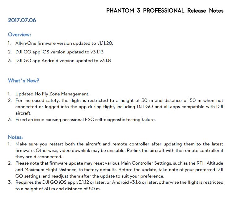

Note - this post is specific to the P3A and P3P, though some of it applies to P3S FW 1.9.20 as well.
With the release of FW v1.11.20, two things in particular need close attention. The need for Re-linking is expected to be common following this update, and this update introduces forced flight distance restrictions (height of 30M / distance of 50M) unless specific steps are followed.
If you don't remove the flight restrictions, it will feel as if you are stuck in beginner mode.
Re-linking
The release notes (see below) this time specifically suggest relinking if the RC and AC are disconnected post updating. It may not always be needed, but since DJI called it out ahead of time they clearly expect a disconnect will be relatively common. This has proven to be true since we have seen many disconnects reported here on the forum even though the release notes already suggest a fix. Note: some have reported general connection and video issues which have also been corrected with relinking after this update. Some have also reported that relinking has helped after updating to the latest AC FW even when they already had a green "linked" light on their RC.

P3P release notes for 1.11. The P3A notes are the same:

I'm surprised that you could not find any info on this. We are getting multiple posts per day like this one since the new FW was released. The release notes specifically suggest relinking, plus the restrictions announced in May are in place requiring a log out and log in of the app.
Once all installed, you'll need to go online with the app, sign out and then sign in again. This is a one time thing. Some have had to delete and reinstall the app. Don't forget to sync flight records before deleting the app or they will be lost. Once reinstalled, resync and your records will be back.
