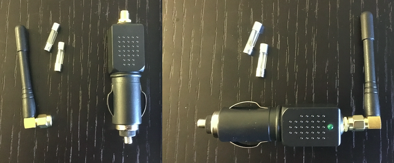

Are there any vehicles near where you fly. It is possible that someone has a jammer fitted in their vehicle.
ill work on shrinking down the area to discover the cause , there are a group of buildings of only 4 or 5 floors and a group of houses, am hesitant the jammer theory cause i flew at different times during the day so its not possible the jammer is always on!! it seems some thing related to telecommunication is causing this big trouble.
It is quite possible that a jammer could be on 27/7, depends why someone is doing it where you fly.

Anybody operating a transmitter of some sort at those frequencies will interfere or jam the signals.
What country you in,,I just read its illegal to use drone jammers unless it's a federal department in all of United states of America but they out there,,,they sell for as cheap as $ 50
no am not in the US, ill check the internet provider in the area an engineer told me they might use such bands , and this should be a very new change they have done i only noticed this less than a week ago!
