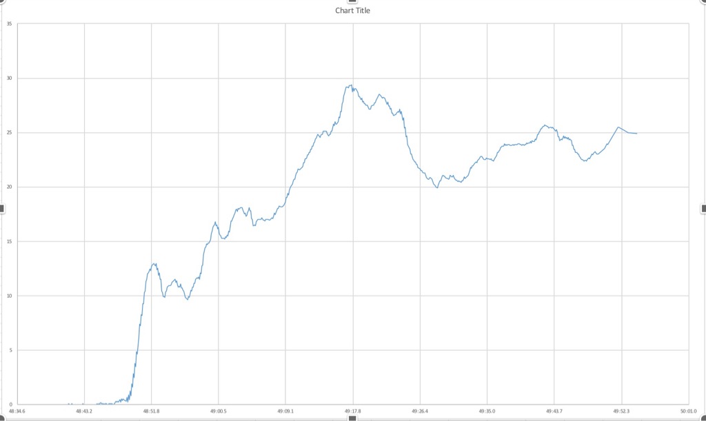

@flyNfrank...I don't see a great change in those values. I am thinking your chart might be exaggerating the slope due to the fact that the last few pieces of data are 1.2 seconds apart (where most previous data points are .1 seconds apart). Is your X axis a function of time? If not, the last few data points might be inappropriately compressed...exaggerating the down slope. Speed and altitude don't seem to be varying much, when you take time into account.
Here's a chart of speed...charted as a function of time.
