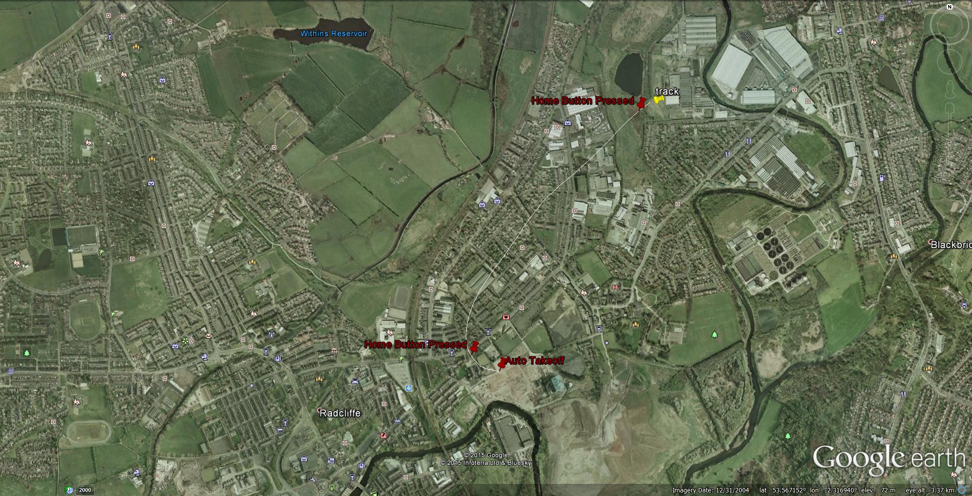

Leon, I've been following the post and trying to figure out what happened from the flight log. Very puzzling !
I did see that a second push of the home button occurred just before the data ended. Here's a view of the significant events along the flight path. It seems too much of a coincidence that the data ended just after the second home button push. Did you accidentally shut of the controller at that point ?

I definitely didn't switch the controller off until much later.
As for the home button, I'm sure I pressed it several times once the drone was out of sight. Why? I didn't know what else to do.
I think the worry here here is that by pressing the home button once it is activated it can be turned off by pressing the button a second time. Note that I have no idea if this was the case.
The drone was long gone by the time I would have done that. To be honest, I'm surprised that it shows a second RTH press on the log. I'd only noticed the single press once I realized something wasn't right.
The log shows just two presses under the column APP_TIP.tip as "Go to Home button pressed".
The abrupt end of the data with no warning messages logged is what makes it seem like the controller go shut off. Were you able to see video all the way to the end of the flight path? Perhaps someone blasted it with a shot gun.
