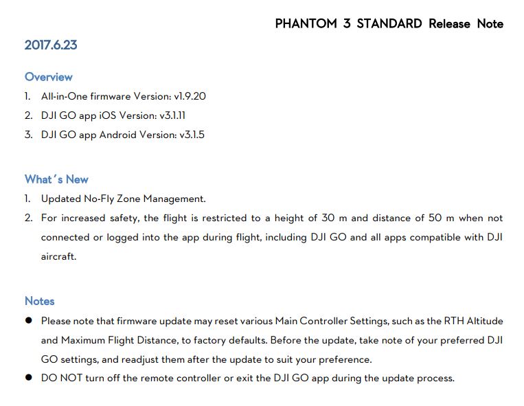

After installing the latest firmware and getting the latest DJI app you are limited in height and distance unless you sign into the app, after that it will release you from these restrictions. Attempting to change these settings in the app does nothing....I spent a few hours swearing at mine until I signed in.....

Help my PS3 will not go as far as it should it act like its being told not to go any farther Tried to calibrate the compass which ive never done before What could be the problem Thanks
Once you are up and flying , let the drone hover , goto your dji go app click on the dji symbol to go to the camera connection screen click on the ( me) section it should have a red dot to say your signed in click on the cog symbol on top right of screen scroll down and log out , then log back in again typing your email and password then go back and click on the drone symbol and reconnect to camera and it should lift the restrictions , so in short you need to sign out and back into app while in flight , hope this helps
This is a update issues that affects some people if it still persists youl have to refresh the firmware using sd card method instead of using app but to lift restrictions youl still have to do the sign in and out method , hope this helps , there are dji youtube videos on sd card method
did you get it fixed ....there was a firmware update some weeks ago ...you need to log into the dji gocreate sight ..theres a video that covers it on youtube

delite dji app then put new 1 then log out acc then back in I did that and my 1 is ok now bob
