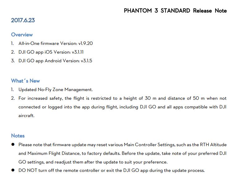

The FW release notes mentioned the flight restrictions and warned about checking settings. Even without the warning about settings, its a good practice to always do that anyway following a FW update.
READ THIS POST FOR MORE INFO ON THE FLIGHT RESTRICTIONS.
