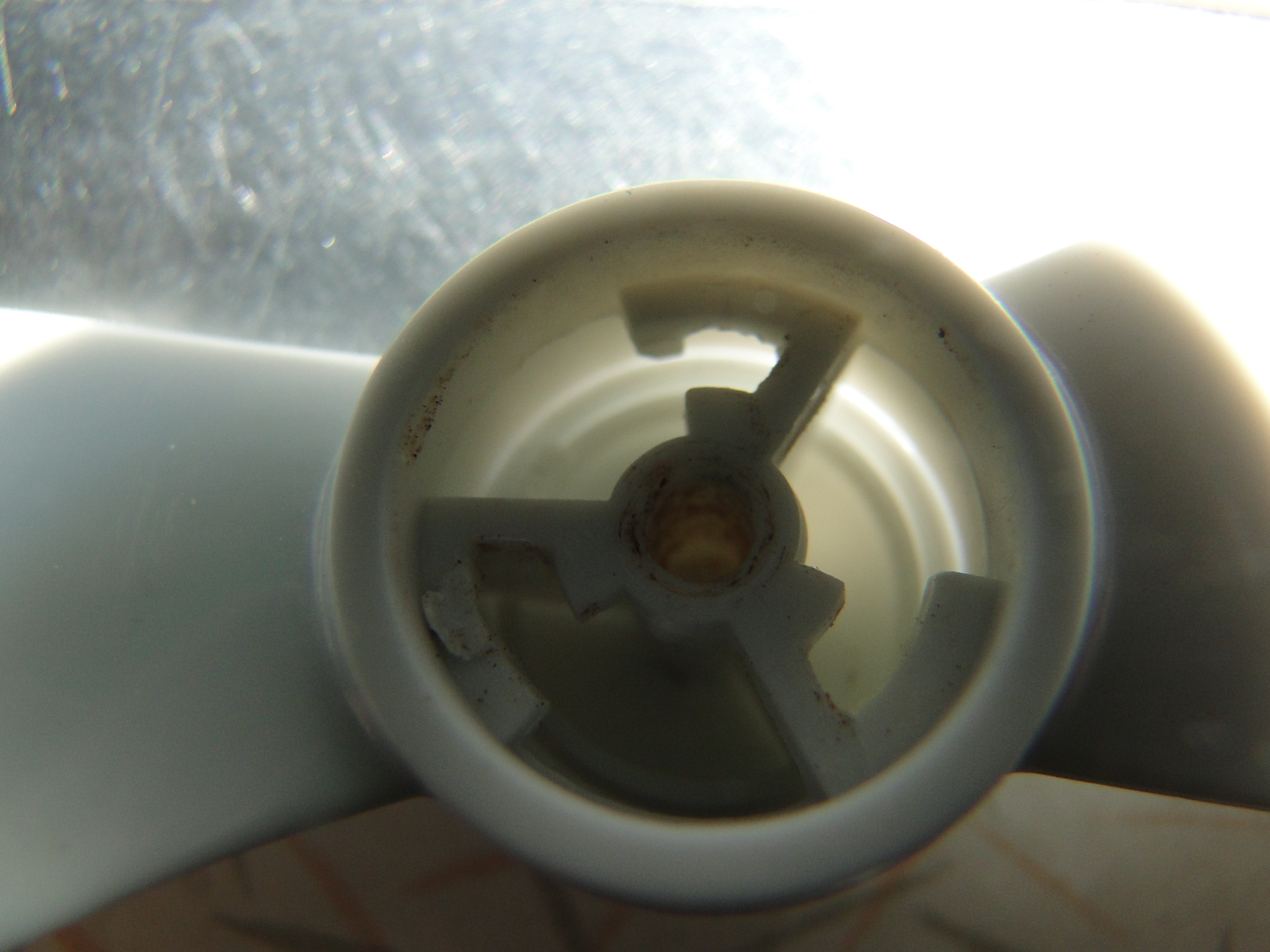

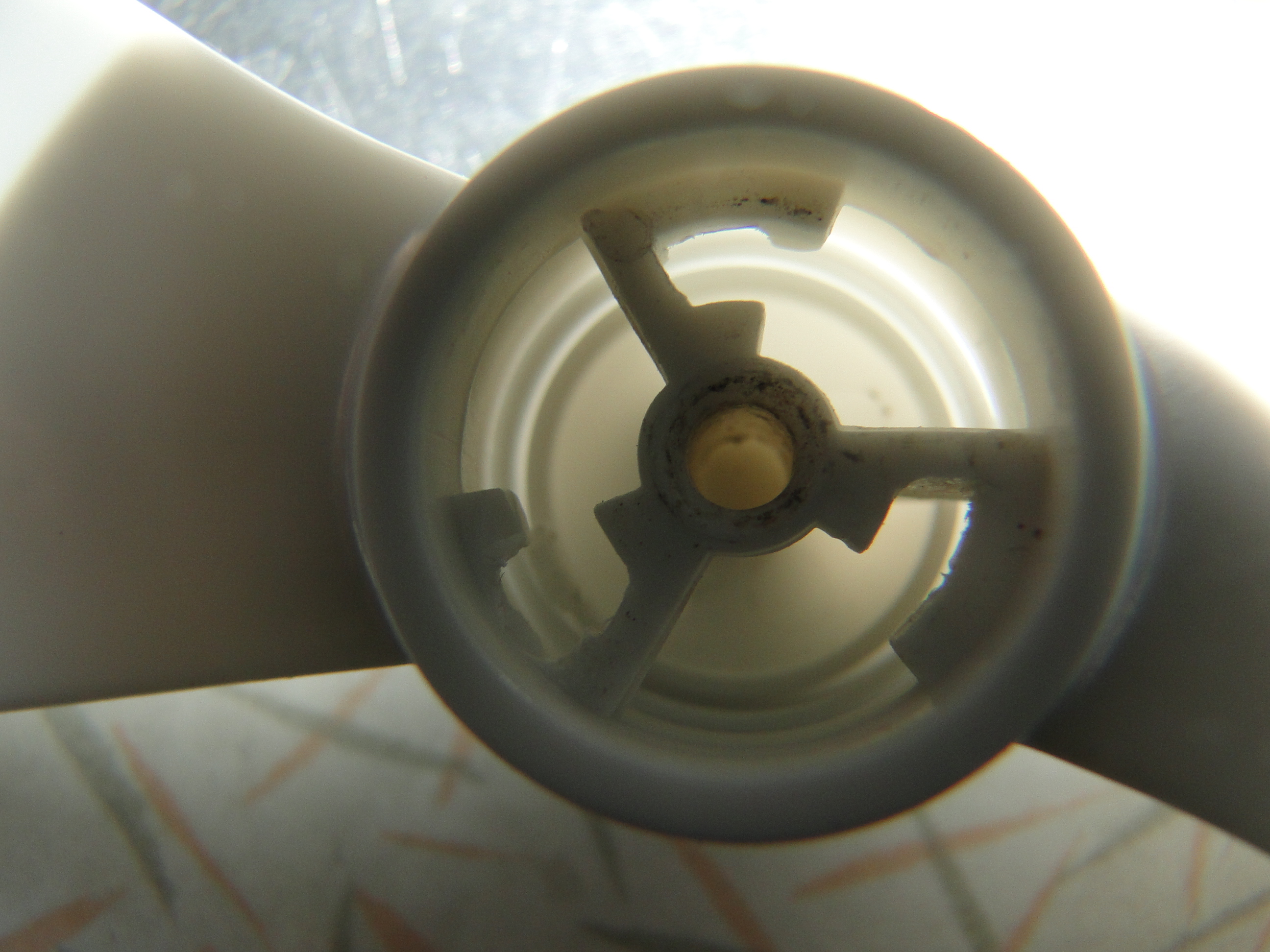

Crash survivor - Prop 1:
Crash survivor - Prop 2:
FWIW, one of these is the prop I used in my test. While I certainly wouldn't want to FLY on these props, they did pass the spin-up test in the living room.

Those pictures do show rather well that the plastic is prone to some wear but those tabs are still in place. You can get the Prop Covers from are website Phantomrain.org. I will also take a look at the Dat file, thank you.
