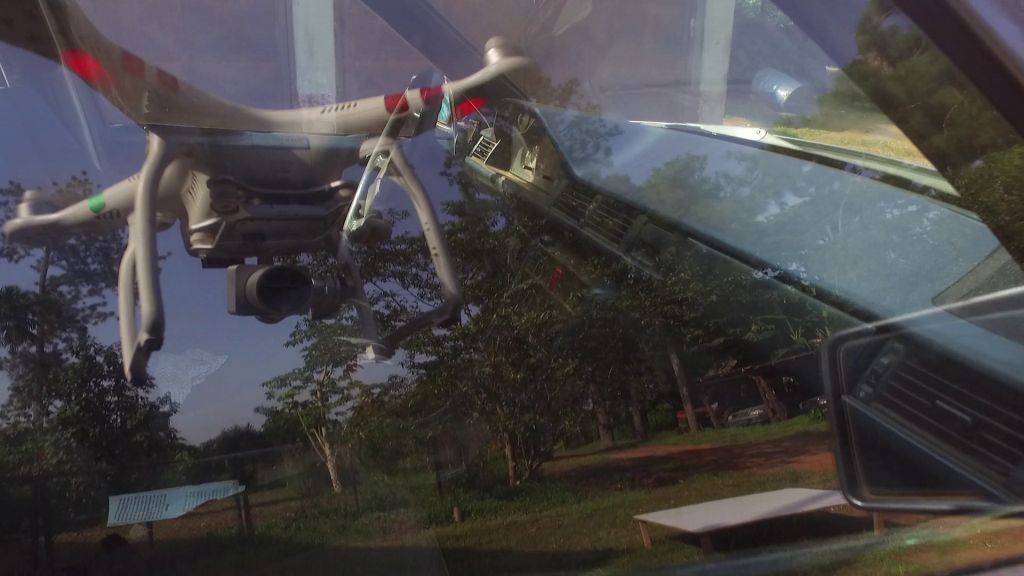

This picture from the video that was rolling during that fateful descent, shows the reflection of the drone as it landed within inches of the parked car. In the background, and less than ten feet away, is the table I use for takeoffs and landings, to ensure the drone never lands on dirt or grass.
I babied this drone ever since I bought it, always landing manually and with the greatest of care, so it just broke my heart to have this happen, all due to a moment of carelessness. The landing would have been gentle enough if the damned car wasn't in the way, and when I looked the drone over, two of those plastic pins that hold on the camera gimbal bushings, were sheared off, leaving the bushings in place.
Replaced the plastic pins, but left the bushings alone as they appeared intact. I also replaced two of the props that were obviously scarred from hitting the floor of the car, yet, for the first time since I bought this drone new in 2016, video footage from subsequent flights shows really bad jello. I'll replace all the props now, but if the jello persists, the drone will have been reduced from a very stable camera platform, to a garden toy whose footage is of little practical use. This is one very costly lesson learned for sure.

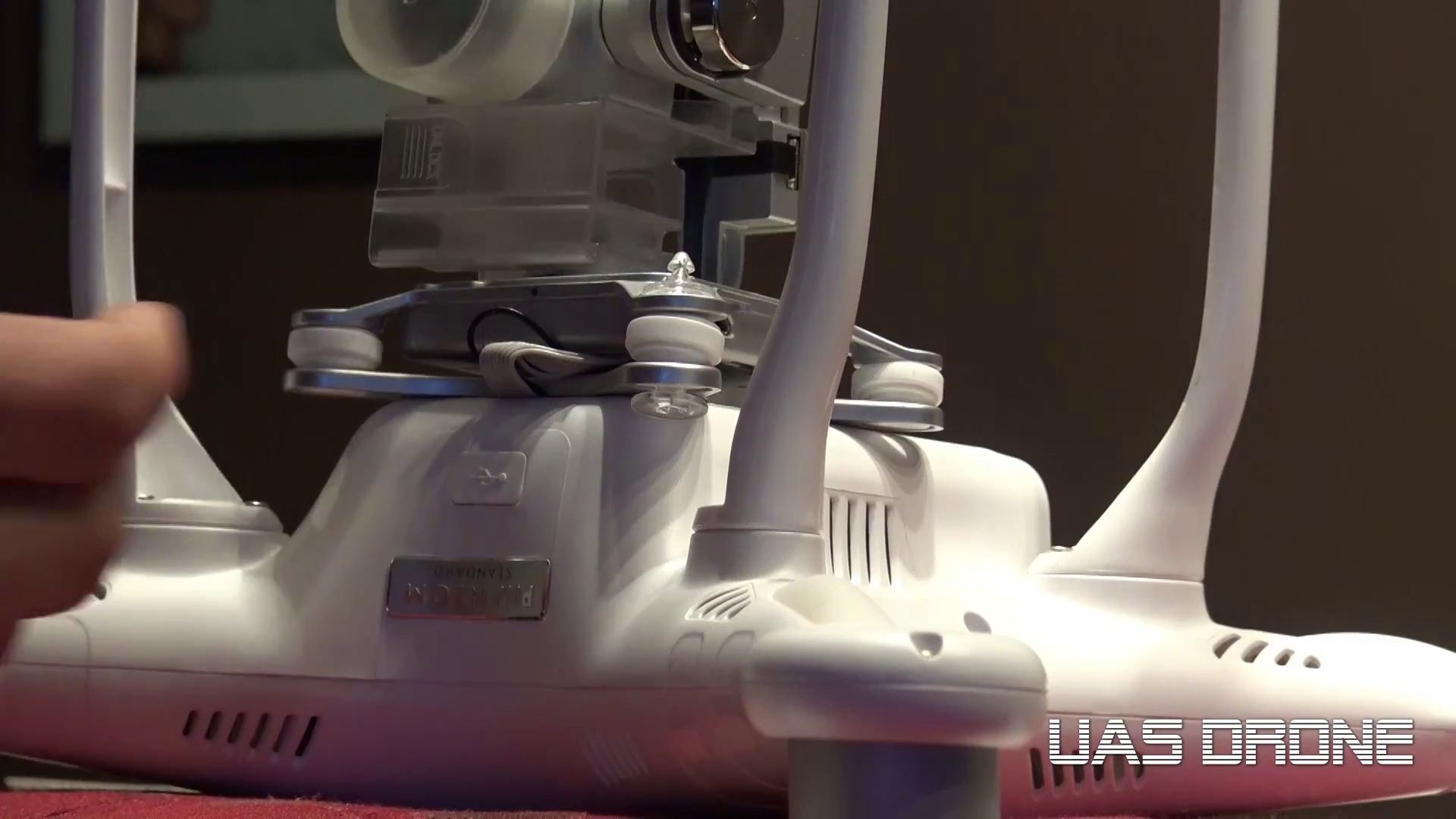

How many pins do you have installed now? Two or four?
I’m wondering if maybe you saw two pins intact and thought there should be four and added two more. If this is the case, take those two back out. There should only be two - diagonally across. When I have had bad jello it was due to improper pin placement in those bushings.
Holy Toledo ! Two pins only ? I just installed two pins in the bushes that had none, under the assumption that the crash landing had somehow sheared off two pins. I'm right at this moment watching video taken with all four pins in place, and the jello is gone completely, leading me to conclude that my "fix" was the cure for the jello vibration I saw yesterday.
Now that I understand there were only two pins to begin with, I am at a loss regarding which pins need to be removed, to restore this craft to the stock configuration. Truth be told, I never did closely examine the pins and bushes on this craft prior to the crash landing, so this clarification is very much appreciated. I'll now need to look online for some closeup pictures of the camera gimbal, so I don't remove the wrong two pins.
Now I know why it is that I didn't see any broken pins on the ground, when I looked over the area that the drone landed, having moved the car away to get a better look. The pins never existed in the first place. Most likely, it was incorrect pin placement that caused the jello, as you have observed in the past with your drones.
Despite having logged over 70 cumulative miles of autonomous flight with this drone over the past month alone, my knowledge about its design, is still very limited. One thing for certain, is that I don't expect to ever crash this drone again, knock on wood.
Ok I went over my library of youtube videos, and found a closeup picture that clearly shows which two pins to retain, and which to remove. Much thanks Bill, for this timely caution about a design feature that I almost certainly would have overlooked as I bumbled along duking it out with the jello monster.
Maybe look closely at the picture of the reflection from your video before the crash. And remember it’s a mirror image.
But my guess is that it doesn’t matter as long as they are diagonal.
Ok I went over my library of youtube videos, and found a closeup picture that clearly shows which two pins to retain, and which to remove. Much thanks Bill, for this timely caution about a design feature that I almost certainly would have overlooked as I bumbled along duking it out with the jello monster.View attachment 120678
Glad to help.
