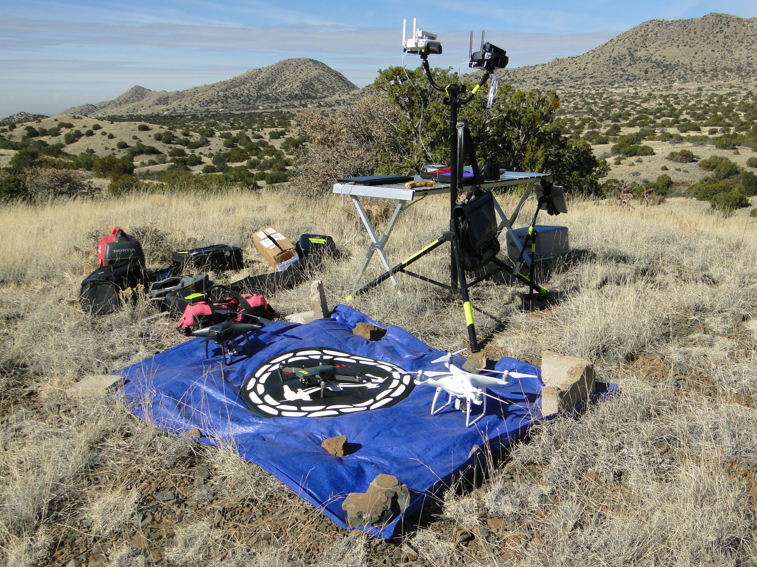

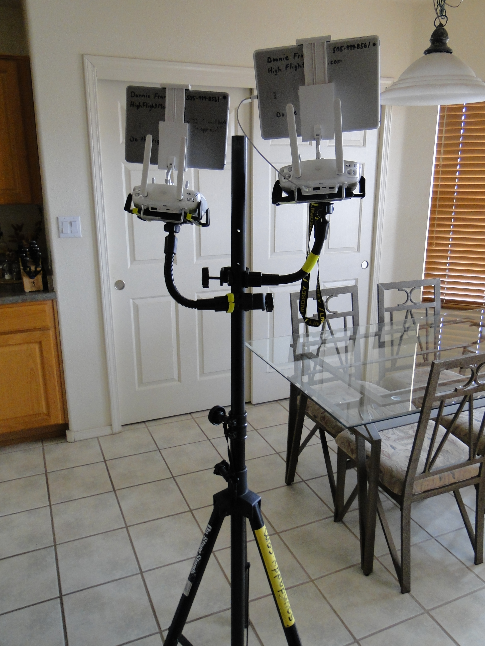

I'm including a couple photos. The first is of the original mock up, and the second is actual field use. as you can probably guess, this rig allows for multiple birds. And at full extension, the controllers get about 9' high, which really helps with reception. And the wide foot stance is very sturdy. The stand is all aluminum, so it's very lightweight, too.
Ironically, it's a very wind resistant set up. I say "ironically," because we don't fly when it's windy...LOL...
I'll put "video of mapping rig" on my list.
Original mock up in my girlfriend's kitchen...
In the field...
Donnie
