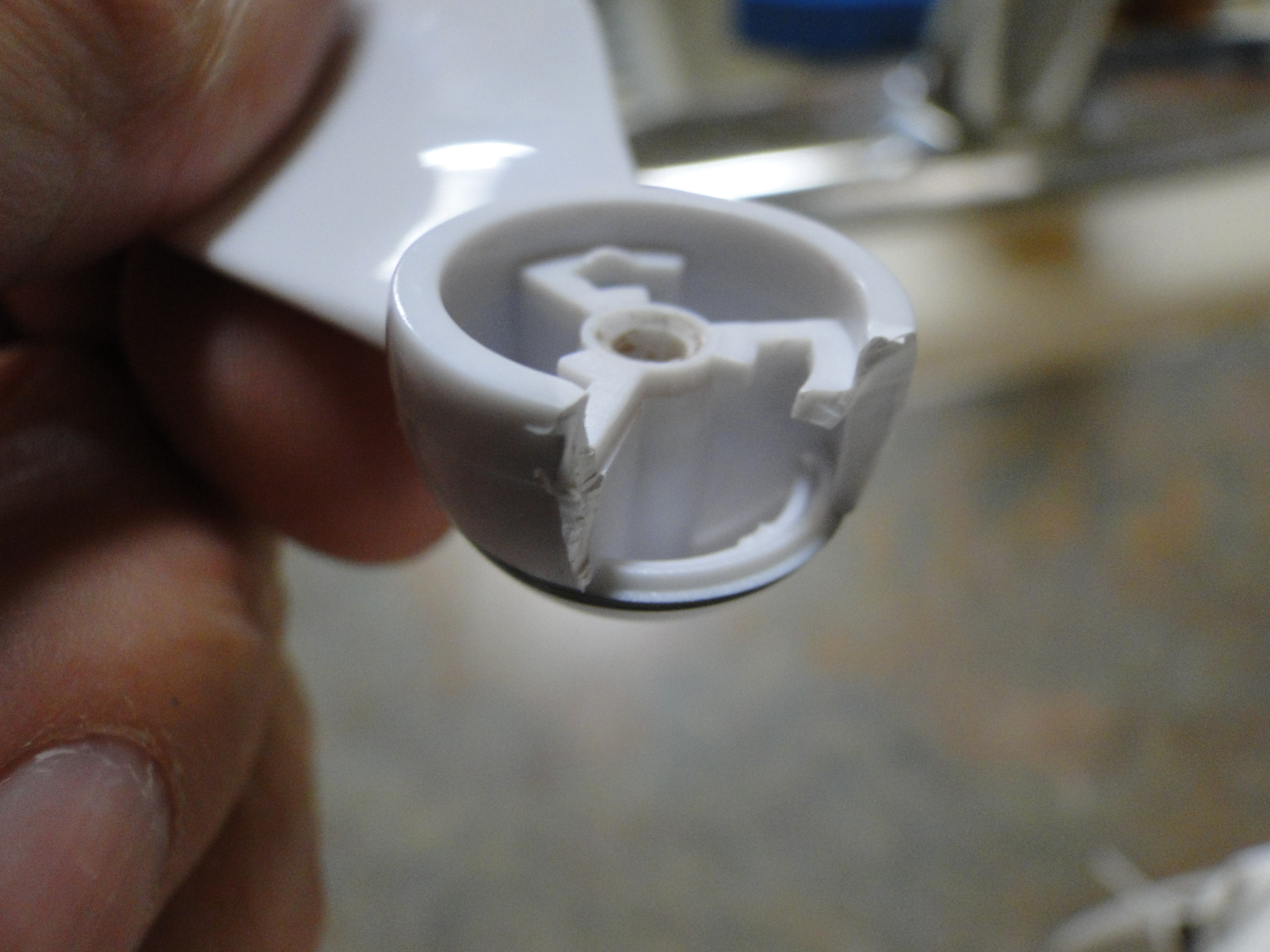

One big difference I have noticed in OEM propellers versus third-party is where the horizontal section of the propeller comes in contact with the propellers center hub. This area, known as the fillet, is the rounded area where the propeller will meet the center hub. If the fillet is nonexistent or very shallow, I can see where a blade could tear off in midflight. I have taken a good hard look at my DJI drone with the OEM manufactured props as compared to a set of carbon fiber props that I have yet to use. The fillet on the carbon fiber propeller is much more pronounced. I have also looked at my son’s toy drone, and the fillet on that propeller is almost nonexistent. So I am thinking that is probably the reason that the blade self-destructed in midflight.

I did not know of any of that, but WOW! You would think that something so simple and inexpensive would be a no-brainer to include as a quality control check. I guess it is my days as a machinist that makes me check on things like this. The first crankshaft I ever milled down (back in the late 70’s) came back to me with one angry customer. I inadvertently cut the fillets to shallow, and the crank snapped in the first 100 miles. Lesson learned, and never forgotten!
Check out this photo. It doesn't look like the fillet failed. It looks like the hub itself failed.
The first prop was never found, suggesting, again, that the hub failed.
Thoughts?
Thoughts?
Kinda hard to tell what happened without both pieces, but that break point on the right side looks like the kind of break that occurs when plastic becomes brittle. Likely causes could be heating the plastic to high temperatures and cooling multiple times or the plastic becoming brittle due to age or UV. While tempering steel uses this exact process to make it stronger, plastic undergoing heating and cooling makes it brittle. It could have been a defect in the plastic too, but without an inspection of both pieces, anything would be a guess.
