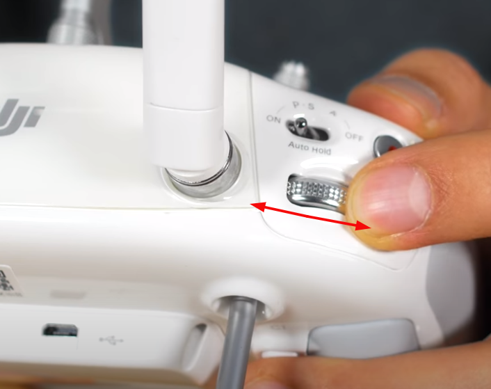

Hello my friends. I got a used remote control and I want you to tell me how the scroll wheel works for gimbal. I turn it left or right and it makes a very minimal return to the previous position. Is that how it should work?
Yip it should do about 1/4 turn each direction,it will be electronically reset to middle on the dial regardless how far you move it,,,,,
Is this what you mean----,,if it feels spring gone stretched you might need to open to check what visibly is happening,?...........

Yes, the wheel does not reset as it should. I have to open it to see what happens, as if stuck. Is there anyone tutorial for help?
Does the stick calibration, including the wheel, function correctly? Does it make a difference afterwards?
