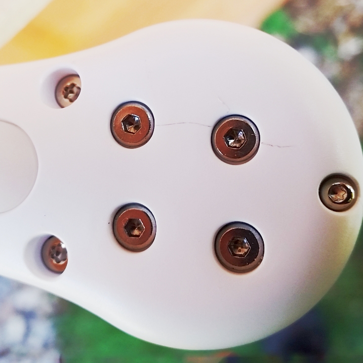

First picture p34k front left arm,,,
and right rear arm,or vise versa,depending which way pic comes out,either way I don't fly this no more,p3s got no cracks and more kms than all my drones
Oh yes.... PLEASE check the tightness of the bolts, mate, and back off where necessary; they really don't need to be more than just a bit more than finger tight.

I had to have a new body fitted because of stress cracks by the motors.
My P3Adv HAD NEVER BEEN CRASHED!
