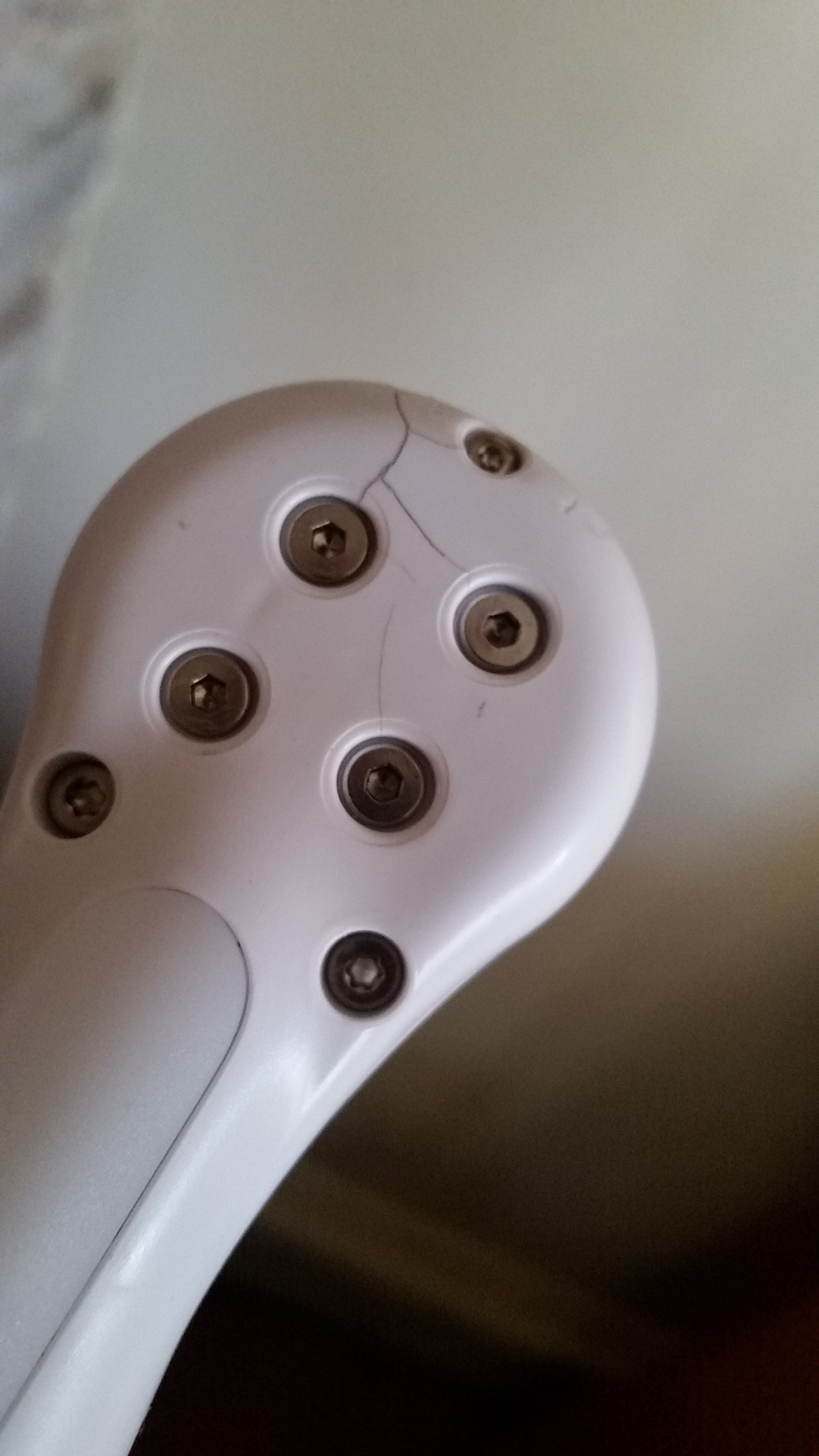

P3S cracked under rear motors.
I do not know when the cracks occurred as I just happened to be reading that people were seeing cracks and I decided to have a look. Had less than 6 hours of flight time - nothing radical as it was spaced out over ten months or so.
Sent the aircraft to DJI and it was covered under warranty. They did not replace shell but sent a new (to me at least) P3S in its place.
* also installed plates under motors as warranty has run out - will see if they work *
