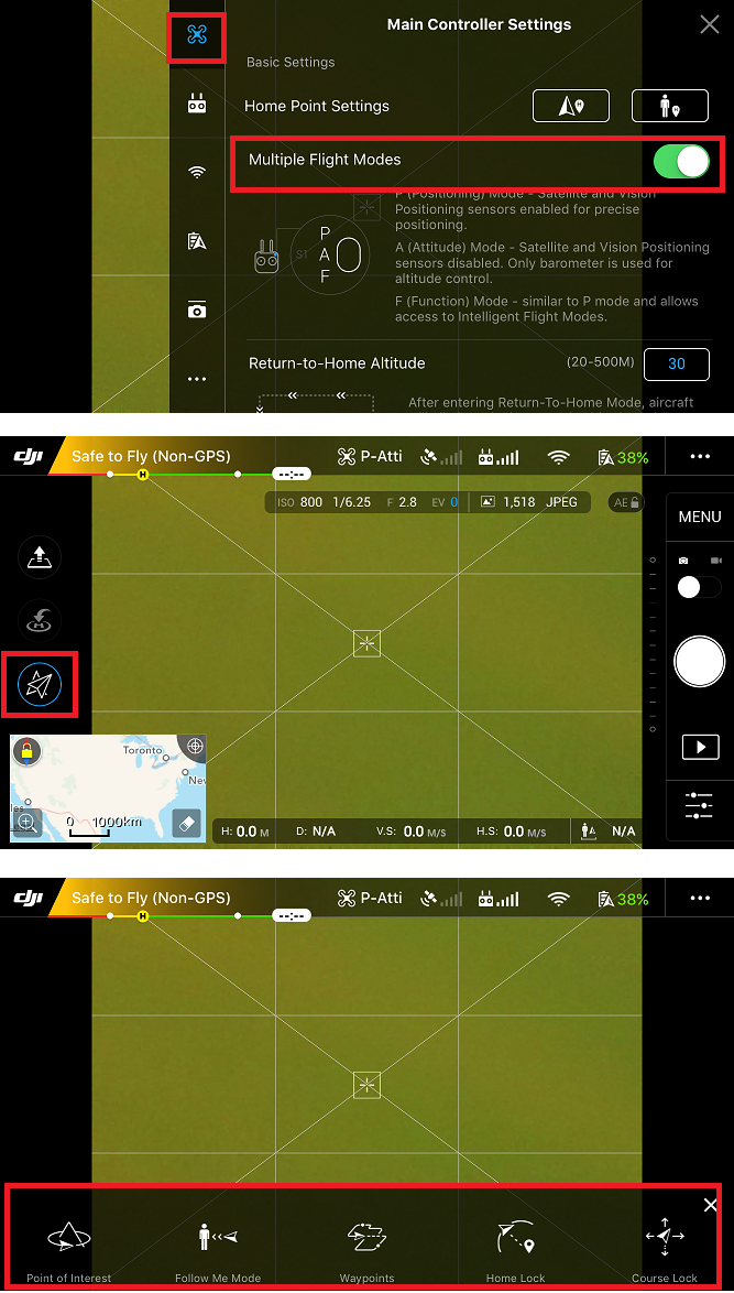

I see my pp3 asking for update but read somewhere that you dont need to keep updating.but when i flick to f in paf i dont get the prompt sign saying poi,follow me,etc .i have tried several ways to get the poi on screen it might be me i haven't had it out for a while due to weather but i am still learning .i have tried numerios buttons and scenarios and the poi doesn't com up on display.

Try this:
If I remember correctly, you have to be in the air before you flip the switch from P to F, then follow msingers snapshots above.
Got it thanks.bare with me i have a bad bad memory i look at this ten times over then go to a spot not being able to check how to on phone because using it on controls i put up drone then i just fumble about pressing buttons getting frustrated because i cant remember what i had just watched or read .must get out more often.cheers again very helpful
