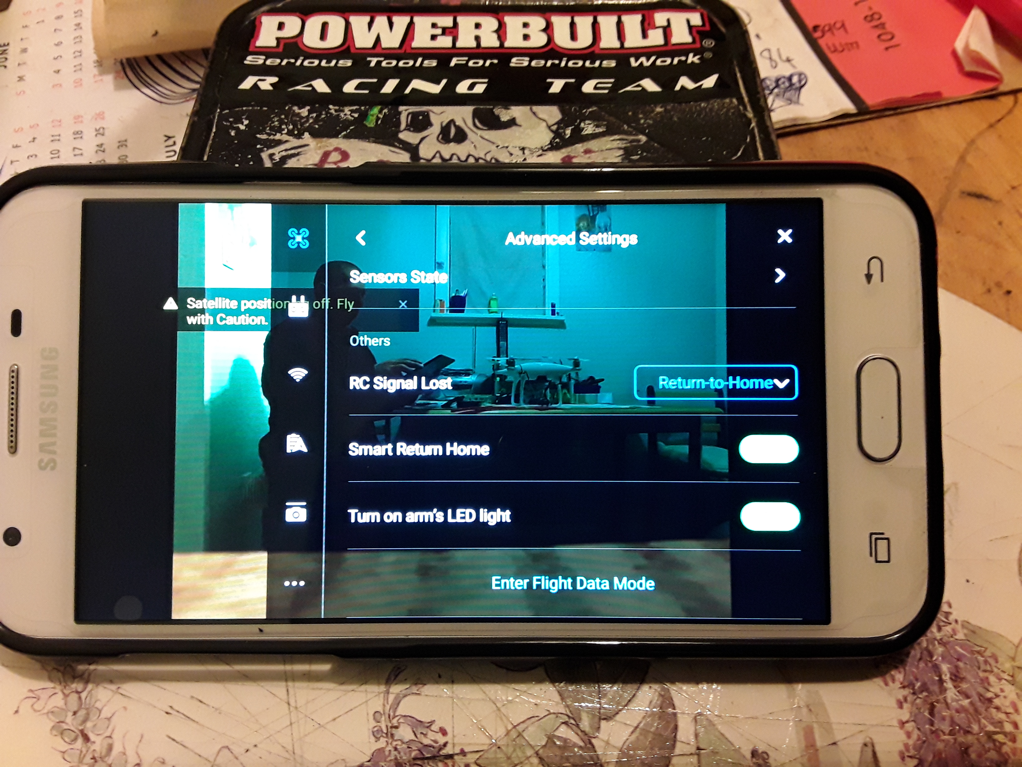

you open app and press top right which gives you this then press top left which gives you this picture go down to enter flight data mode and press,,it ask you a question press OK :)

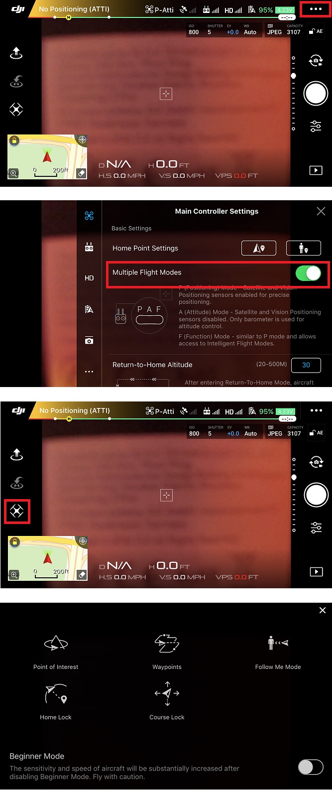

The intelligent flights modes are accessed like this:
icon on left side of screen under return to home is now picture of remote control
It's still a picture of a Phantom as shown in my screenshot above.
Yes, it's different on iOS. Here's a screenshot from an Android device:
They don't want to make it too easy for us ;)
