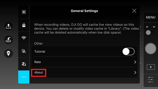

skatemurai, you need to be running firmware version 1.4 (or higher).
skatemurai, you can find your installed firmware versions in the About section of the DJI GO app.
It'll only show your Phantom firmware if it's running and the DJI GO app is connected to it.
I'm running the latest firmware. It's up to you whether or not you update to the latest.
It is running (without "wings" attached), everything is ON, but no firmware version is not shown :(
Which version of DJI GO are you using?
Well, if you don't want to go beyond 1.4, then trying installing 1.4. If it's already installed (I'm assuming not), then it won't install again.
