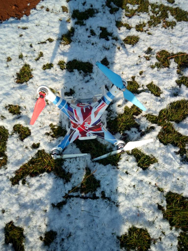

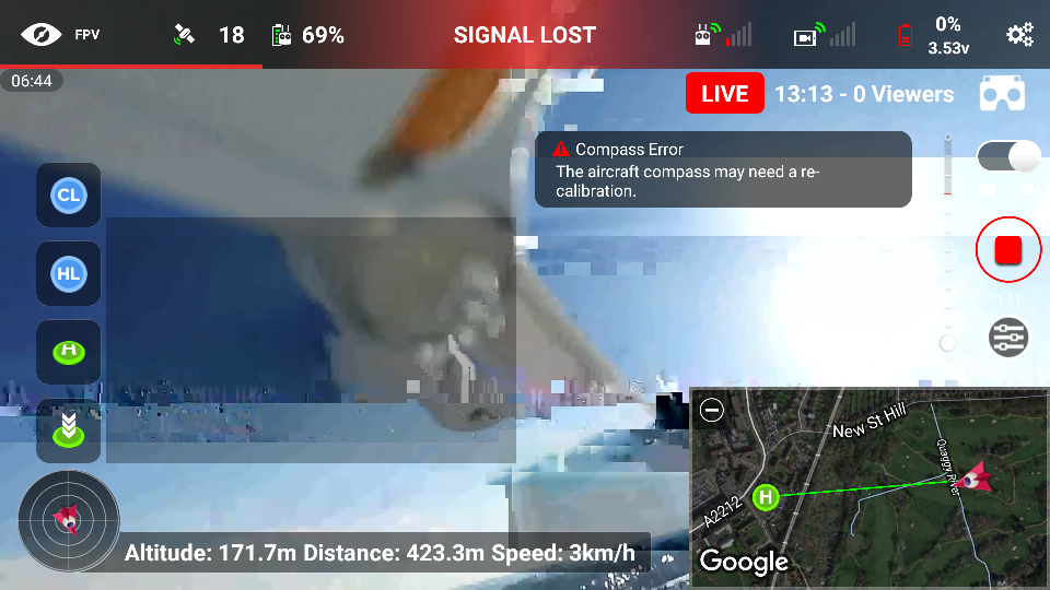

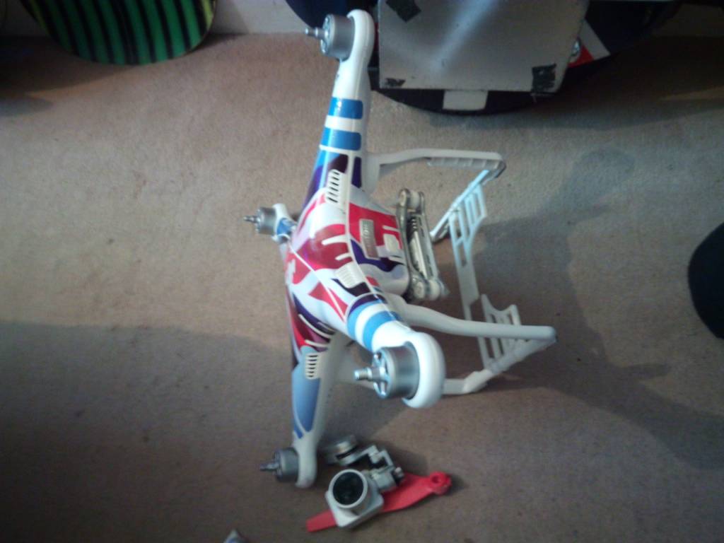

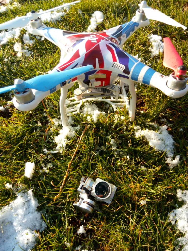

Had a great day flying. Snow stopped, sun came out so launched on a full battery. Coming into land at around 150 metres when I get compass error. Then it dropped from the sky and landed on a snowy empty golf course. Camera snapped off but shell is in a good condition. Not even a crack. Using litchi but wondering how a compass error can happen so high up.
Can anyone post a link on where to upload my DJI files please. I am only used to doing litchi so haven't a clue. If its compass error and a failure I take it DJI will repair it for free despite it being over a year old?
If not then I am done with drones. Thanks anyway guys and will upload the DATA as soon as someone will put a link on here [emoji4]View attachment 95592View attachment 95593View attachment 95594View attachment 95595
