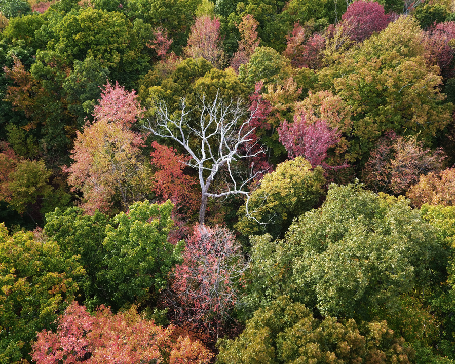

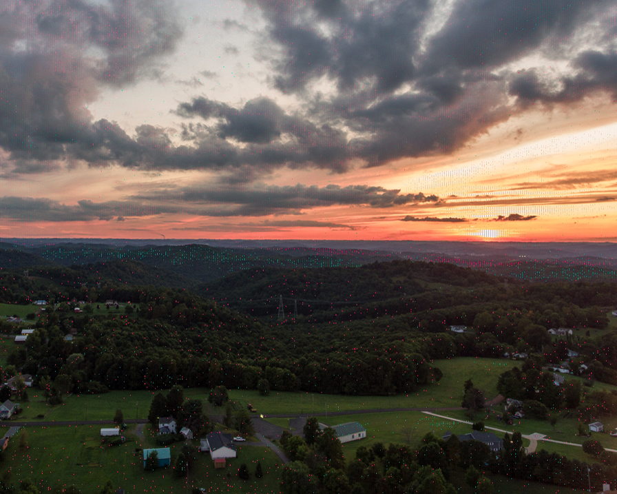

here are the photos i found online, any ideas??? also i can't see dots or overexposure when i switch to picture mode, i know how overexposure looks like but it's turned off and camera settings are reset

So you are saying these are not yours?....The first one is most definately overexposure. The second is also overexposure, but it appears also to have bad pixels. If these are not your's it doesn't help a lot to post them.

As I said, if you post your own we can give you a better idea of what is going on. Those images have two different issues, and are obviously overexposed on both. Bad pixels will show up regardless of exposure, and are generally in the same area of the image. If, as you say this does not exhibit the issue in still photos, we would need to see a short video clip and know what your camera settings are. You should eliminate all of the general issues before resorting to hardware, firmware or other changes. You are asking for more issues if you don't.

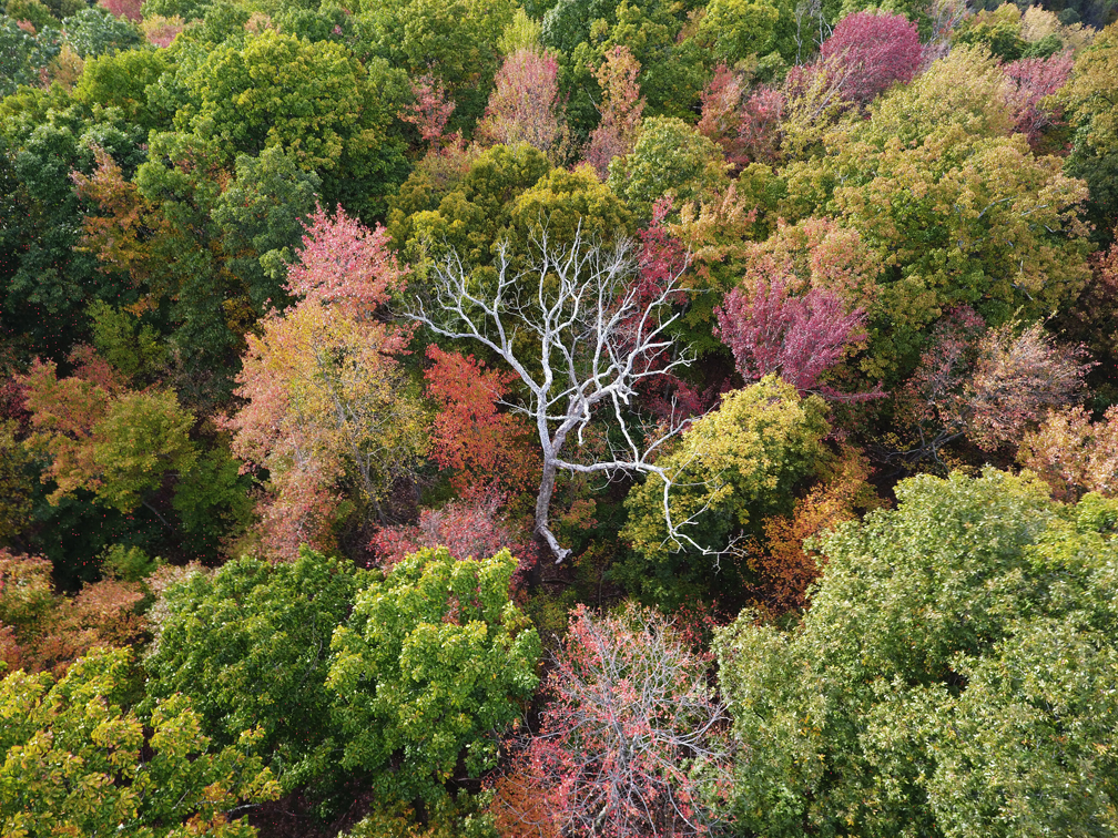

Here is 2 shoots of the same tree. First one isn't too bad. Second one is bad. Look in the dark areas to the left.

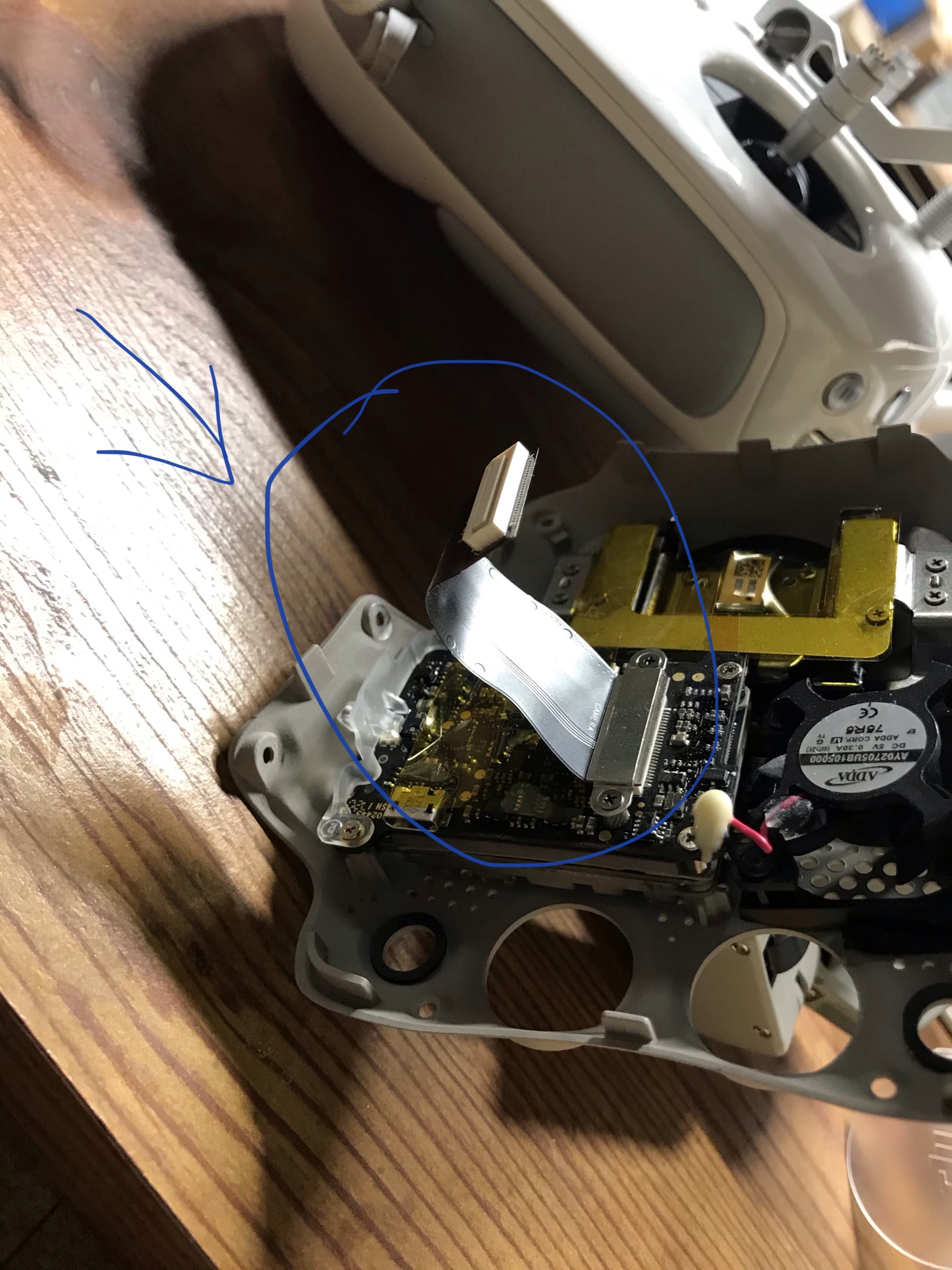

When you say the camera ribbon cable, are you talking about the cable under the camera assembly? Because I’m having the same issue.

We're referring to the ribbon cable that connects to the gimbals/camera on the drone.
