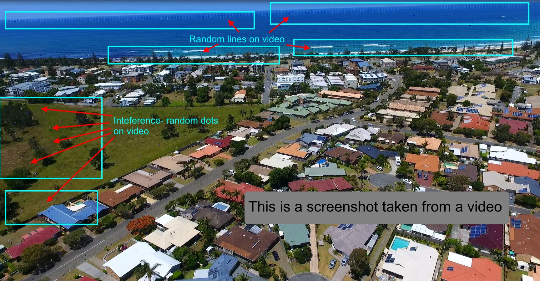

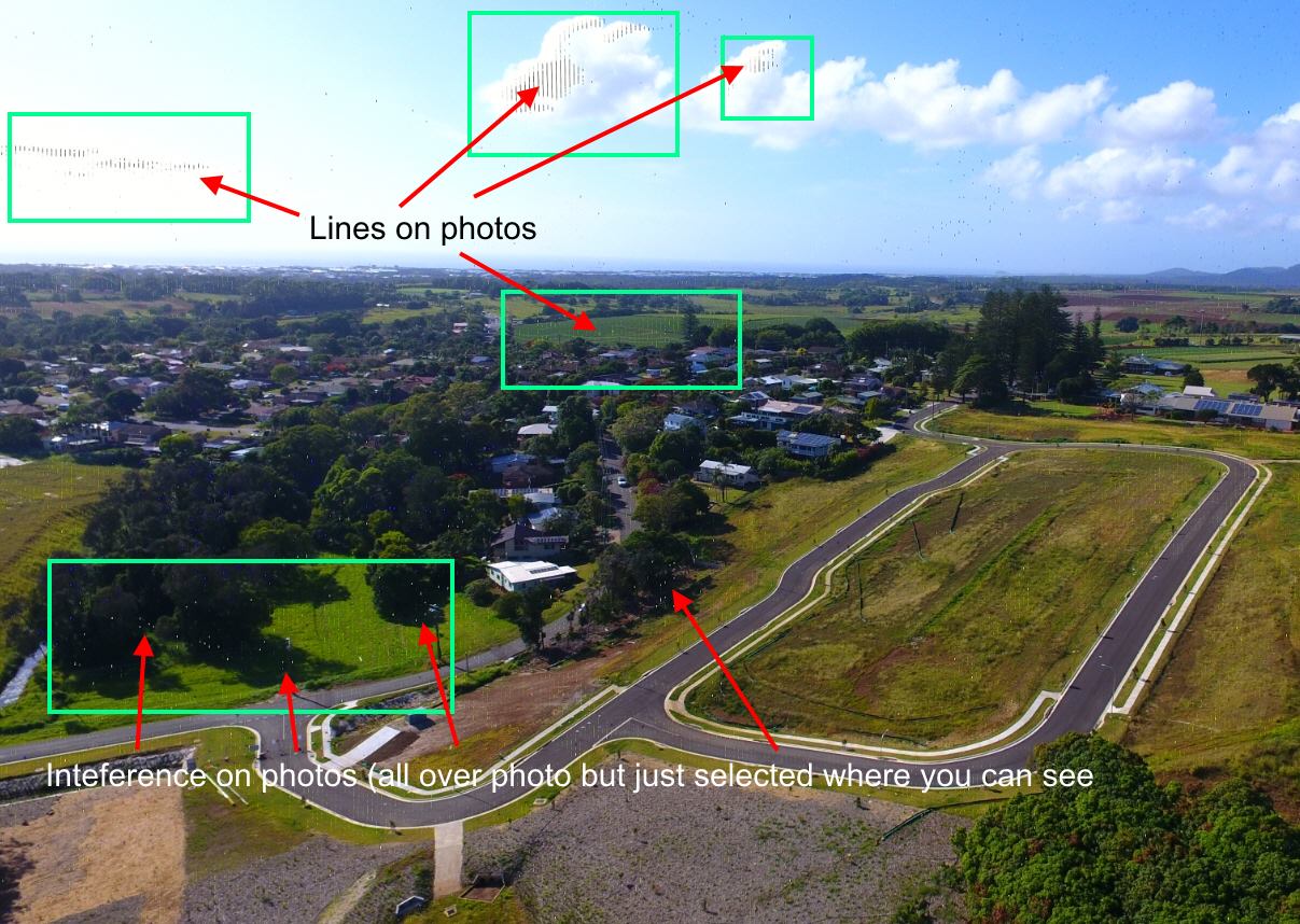

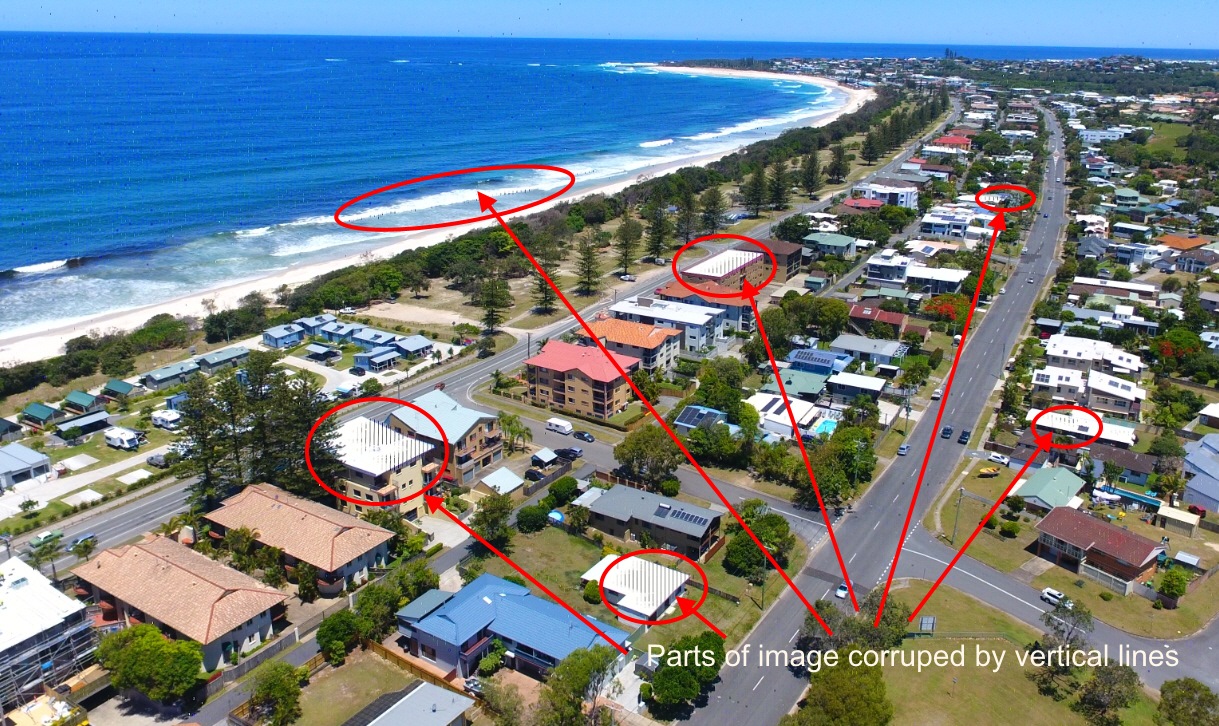

Have had my phantom 4 for nearly 3 years and its had heaps of use by using it for aerial photos and videos in my real estate agency. Our P4 would have taken thousands of images as well as probably many, many hundreds of videos and we use the drone whenever its good flying weather (every other day). Most recently we have been experiencing lines on images (mainly light roofs) and clouds, as well as lines and static inteference in videos. I feel it might be the cmos sensor failing but does anyone have any thoughts on how to rectify or who can repair or if it is worth repairing. The inteference is on approx 60% of images/ videos (so not every time we use the drone). I also attach screenshots of images and video and highlighted errors that appear. We have never crashed the drone and its been looked after; its just had lots and lots of use.

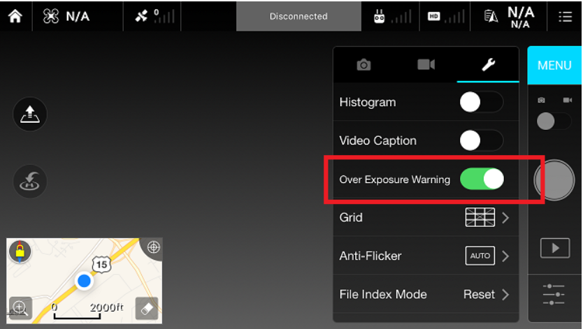

These look like overexposure warnings. Try turning the warnings off...
Those appear to be zebra lines? This is a screen shot of what screen? If you are in any kind of photo or editing program when the screen shot was taken, it could be the software pointing out the over-exposed areas.

Sorry for non reply as its very late at night here/ early morning. I have an earlier p4 so that was the footage taken from the camera, that is not in an photo or editing program. Just the mp4 files and jpeg files taken straight off the camera (and then I used snagit to capture the screenshot of the mp4 file). So not the software. I will try Fly Dawgs reply about turning off exposure warning. Cant try for the next few days as we have 5 days of cloud and rain so I will try after that! However the interference appears on all images, mp4 files that are affected whether over or underexposed.

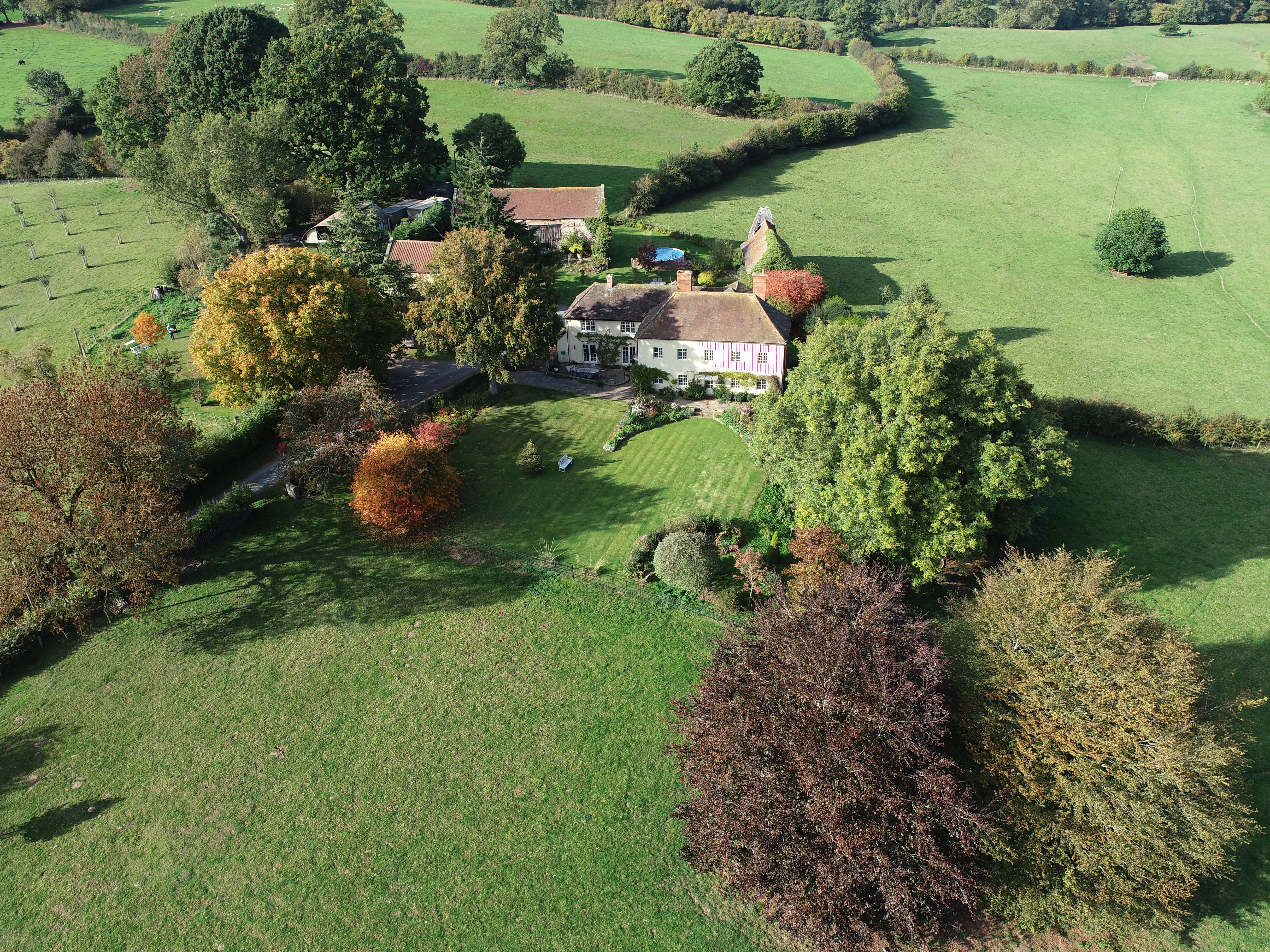

I have been a professional broadcast cameraman for 25 years, and have flown a P4P for 2 years , and have had this problem for the past few months. I can assure viewers, correspondents, that these are not Zebra indicators, and is a definite fault with the camera/Sensors. Zebras show exposure levels and highlighted areas, but they are, depending on the system, either horizontal, diagonal, or a combination of both. These are vertical lines, also on areas of high light concentration, but mine are recorded on the SD card, and cannot be removed. I have spoken to DJI about this, but as I am out of UK warranty, they have not been particularly interested or helpful.
Like I said above, my P4Pro had these 'faux zebra' lines in bright sections and clouds, it was fixed by replacing the gimble ribbon cable - no problem with the camera/sensor at all.
Thanks for your reply and image ! Yes, exactly as on the side of that cottage ! Will order cable straight away !
