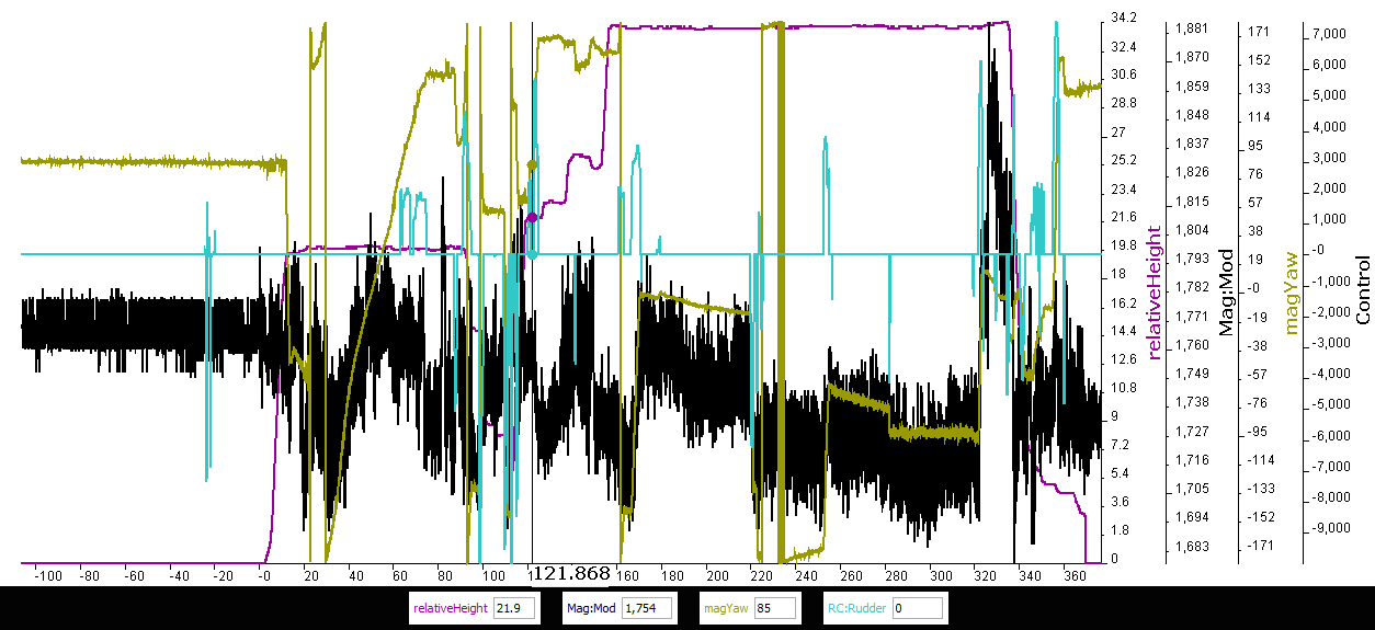

@BudWalker
Starting at 160s, I took the drone up and just sat there. Notice how magyaw constantly moves even though I'm giving zero RC Rudder input. I did several tests (where relative height is at 33)
So the question is, is this being caused by compass or IMU... Probably going to box it up and exchange it at best buy tomorrow. I want a gremlin free drone, not one that always wants to point west lol.

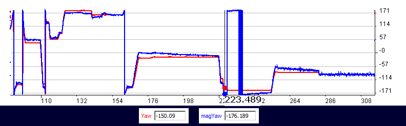

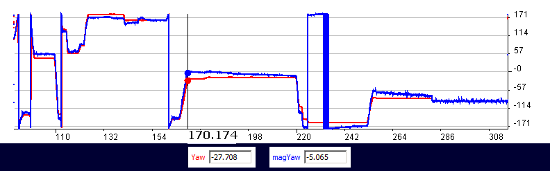

The reason that the P4Pro rotates on it's own is that it's trying to eliminate a Yaw/magYaw separation. Seems to be a problem with compass #0 which is the one that it's using. I don't think it's associated with pointing west. At time 170 there was a Yaw/magYaw separation that caused the P4P to fix by rotating while holding Yaw fixed. At about 220 the separation was eliminated and the P4P stopped rotating at the heading -27 degrees.
The same thing happens at 223 secs but stopping at -150 degrees.

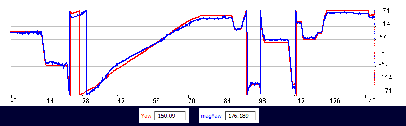

There is an indication that the compass isn't calibrated as can be seen while the AC is rotating from 28 secs to 78 secs
There are several points in the flight where this doesn't happen, it's only after 45 degrees or more that the Yaw/magYaw separation happens followed by the uncommanded rotating to fix the separation.
