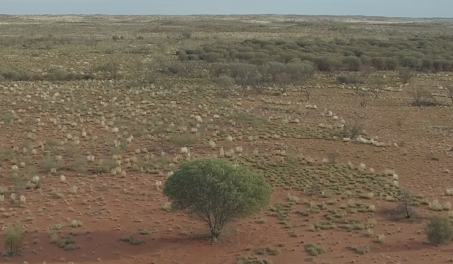

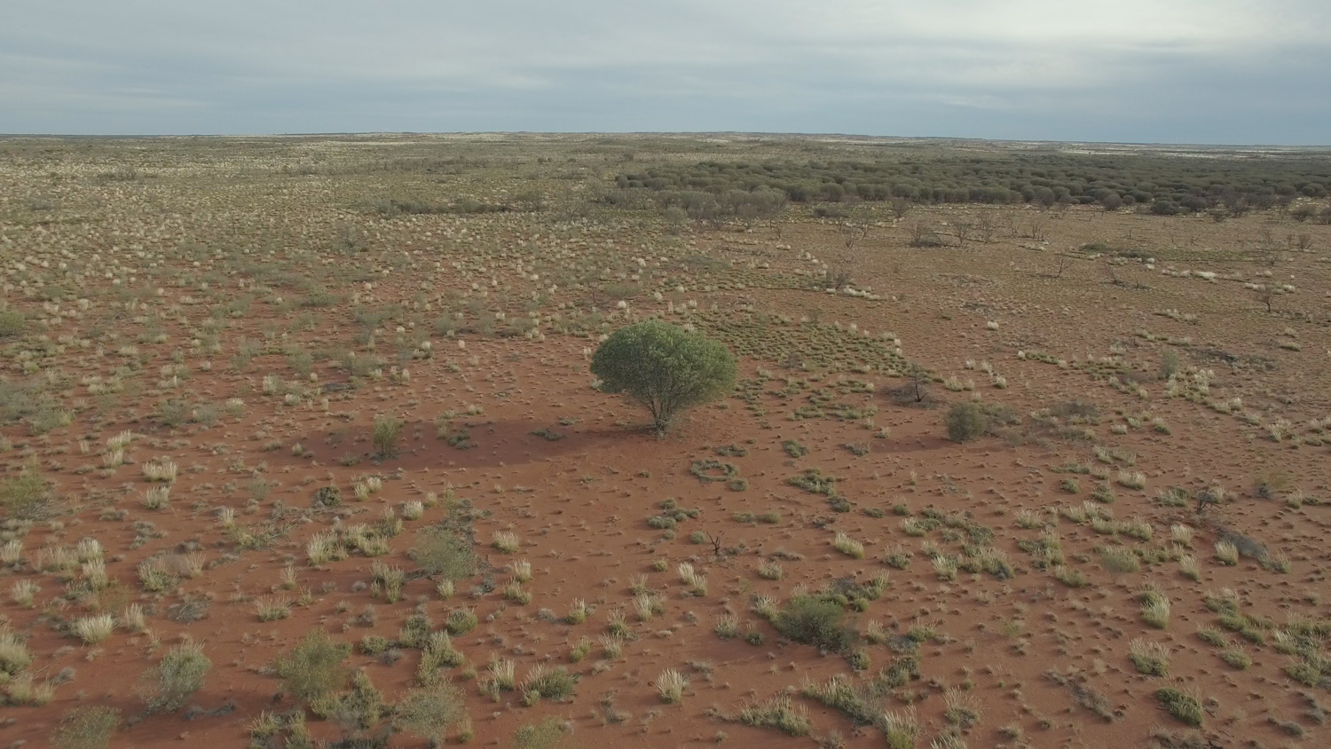

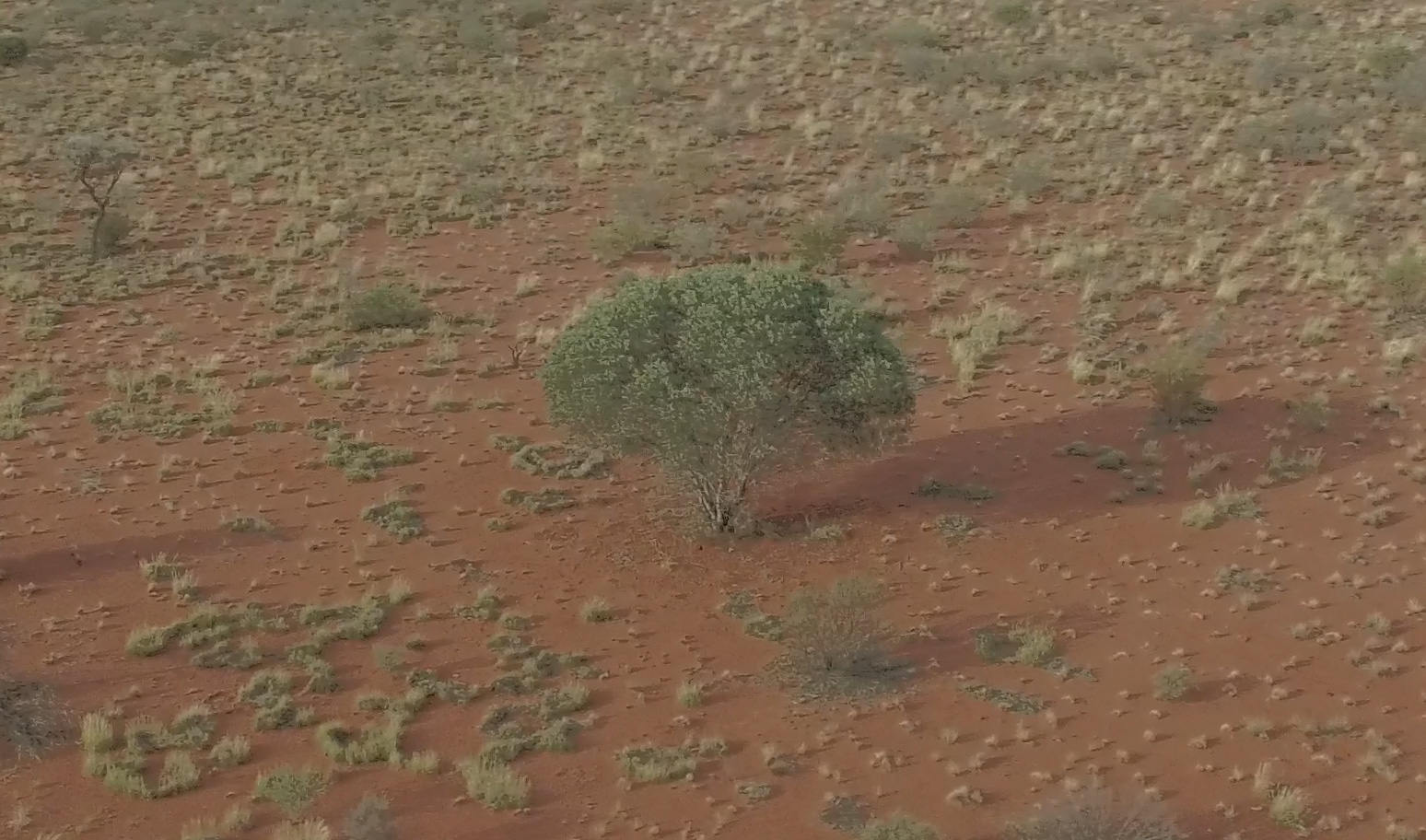

Additional images of a tree that I did a fly around...
100% crops below one is the full shot from premiere
Thanks Dave
It is very frustrating sometimes its better and other times it looks very muted and smudgey.
I am also very particular with my footage (I also do photography and videography as my career) I have shown others that have been "looks ok" and I'm guessing that what the company I purchased from is going to say as well.
Maybe I am over analyzing though :(
.View attachment 54810 View attachment 54811 View attachment 54812
