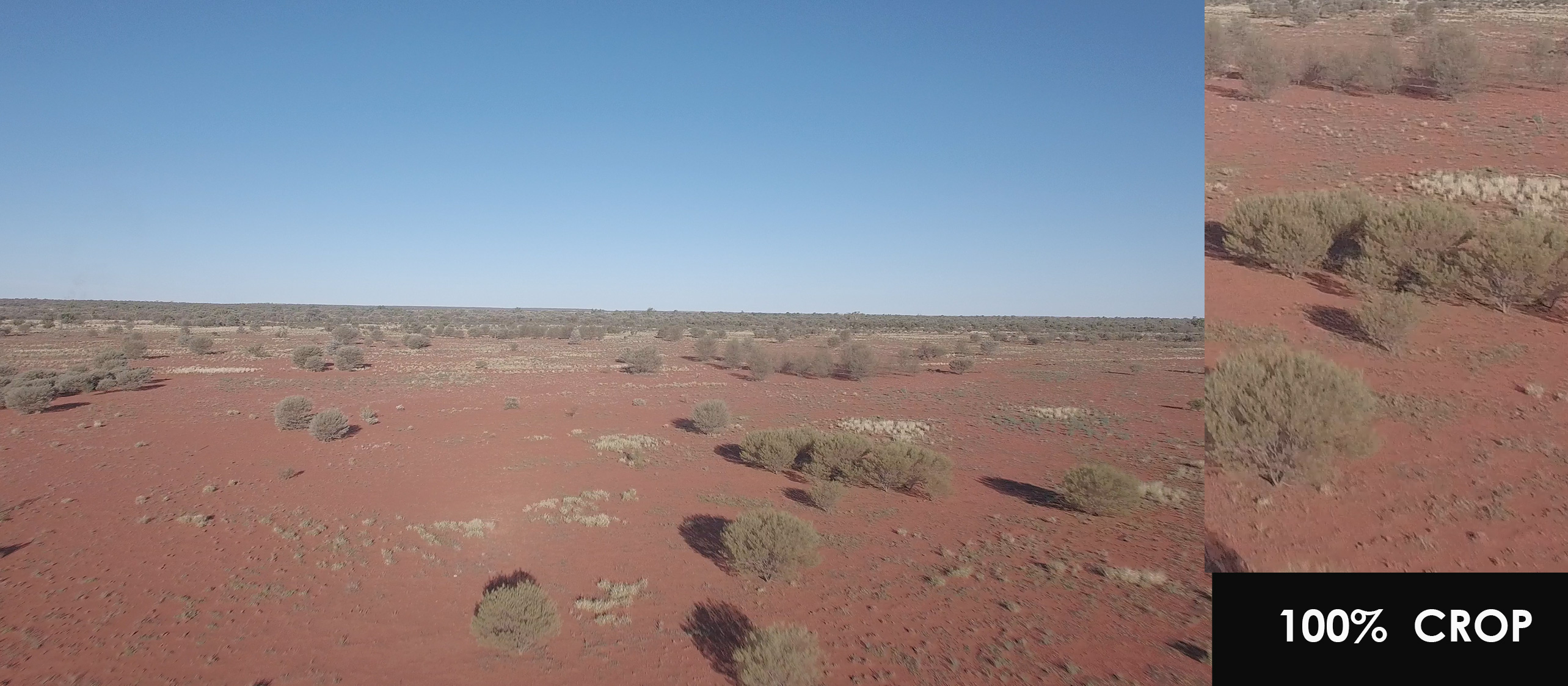

I've been testing my Phantom 4 for the last 2 weeks, and all I can conclude is I must have a 'lemon' or bad copy of the camera. I hope.
For context, yes I have been using DJI Phantoms since model one on up to the Phantom 3 Pro, so I am very well versed on the settings, flight, and expected quality.
I have very similar results, I've had mine for about 2 weeks had a phantom 2 before with Go pro black so cant compare to a P3.
Can anyone download the footage and tell me if im going crazy of this is a bad P4 ?
The best word I have seen to describe it is posterised, seems like one of those cheesy filters even a bity noisey...I have tested the footage on my surface 4 and desktop 27" 1080 screen both looks pretty terrible.
Also the 1080p footage looks really bad compared to 4K I would say worse than my Go Pro.
Drop box link to the raw footage below
DLOG - Dropbox - 4k-custom-dlog .MOV
None (picture setting) - Dropbox - 4k-custom-none.MOV
DLOG - Specs for footage
  • 4K 30fps
  • Manual camera settings ISO 100 / shutter 60
  • Using a DJI ND 16 filter
  • 3D noise off
  • D-LOG
  • Picture style Sharpness 0 saturation 0 contrast 0 (I played around with these and -1 sharpness just looked terrible)
None specs are the same just none instead of DLOG mode
What I've done
  • Tried playing with all the picture styles found 0 all round to look the best (before and after post)
  • Tried with a SRP ND 8 filter on a duller day
  • Tried with no filter
  • Tried auto mode
  • Tried a different SD card
  • Tried various picture modes none, dlog cine etc..
  • Tried various frame rates and resolutions
  • Taken the footage into premiere and graded, processed, sharpened and exported still not that impressed
I dont have another phantom 4 to compare but the pictures at the start of this thread really look similar to mine.
I will be back in Sydney in a few weeks where I purchased the drone might have to take it back see if they will swap. Unless someone can convince me this is normal ?

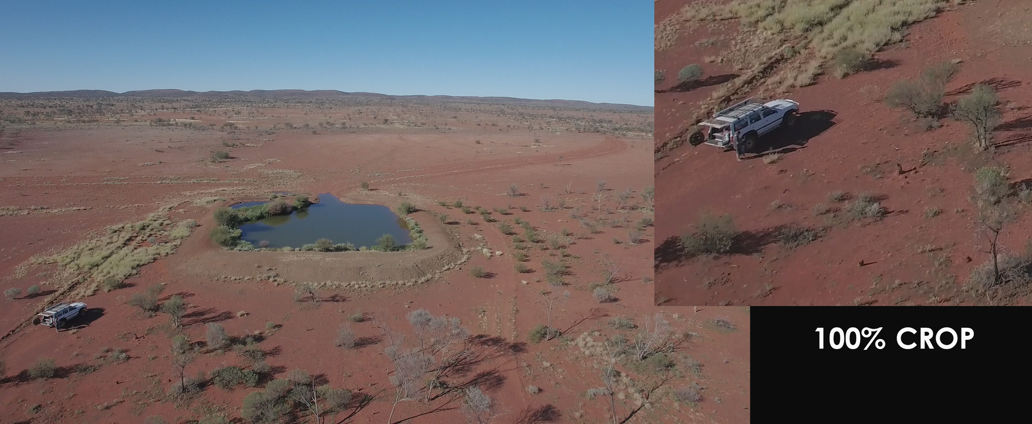

Here are some crops from the dlog footage on different days, one taken from the mid/corner and the other from the center
