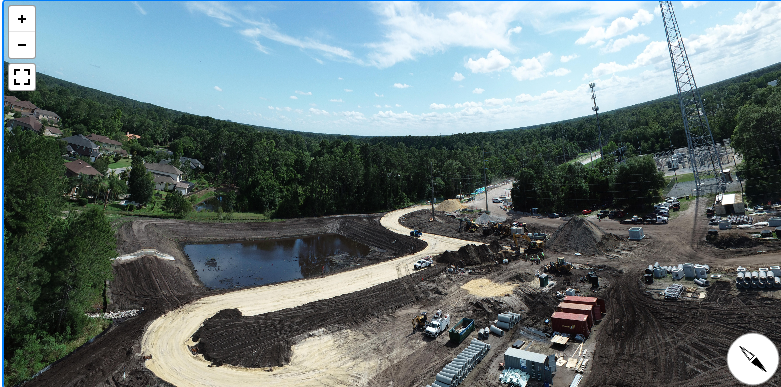

I've searched the forums, but no joy. Using the Phantom 4 Pro's automatic 360-degree spherical panorama camera setting, what is the best software and settings to merge the 34 photos it takes? I've tried Photoshop, MS ICE, Lightroom and others, but been unsuccessful in creating the quality of 360° spherical that the DJI Air 2S shoots and produces automatically onboard. Here is an example of what I am getting with the Air 2S that I would like to replicate with the P4P: Jacksonville Drone Services Aerial Photography | Wavepilot Aerial
Here is an example image of the distorted panos I'm getting:
Thanks in advance - any help is appreciated!

I have certain missions where I want to fly the P4P (like orthomapping sites and Litchi waypoints), and I prefer not to have to launch a different aircraft just for the spherical panos. May I ask what software do you use to produce the 360-degree panos produced by Litchi?

Hello @Wavepilot,
I suggest you have a look PTGUI to stitch your 360 panos ($). Autopano Giga may also be of interest.
I use FlyLitchi to capture and PTGui to stitch. It doesn’t care what camera captured the images, I have used it with P4 P v1 and Mavic Air, will be testing with Mini 2 photos soon.
