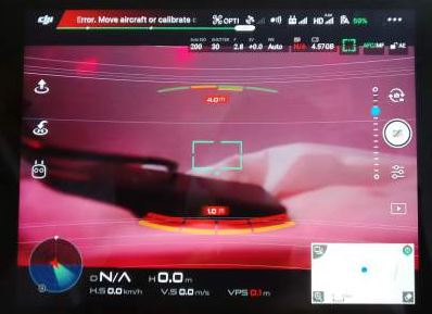

I think I have the exact same problem and this is a phantom 4 pro that has never crashed in all the 1 year and 10 months that I've been operating it, and it suddenly pulls this crap on me... I can see some slightly circular lines see picture (that I got in this thread Phantom 4 Pro - Camera Sensor Error - Hardware Malfunction and I have a similar problem) ... and then I get "Camera Sensor Error" and the visual feed becomes intermittent... I move the camera up and down, but the feed stays the same... then suddenly it's back again... When this happens, camera settings seem to be reset... and if i'm filming, it stops...

  • [New reminder]Phantom 4 Pro-Camera Sensor Error-Hardware Malfunction  DJI FORUM_2019-02-19_02-...jpg
