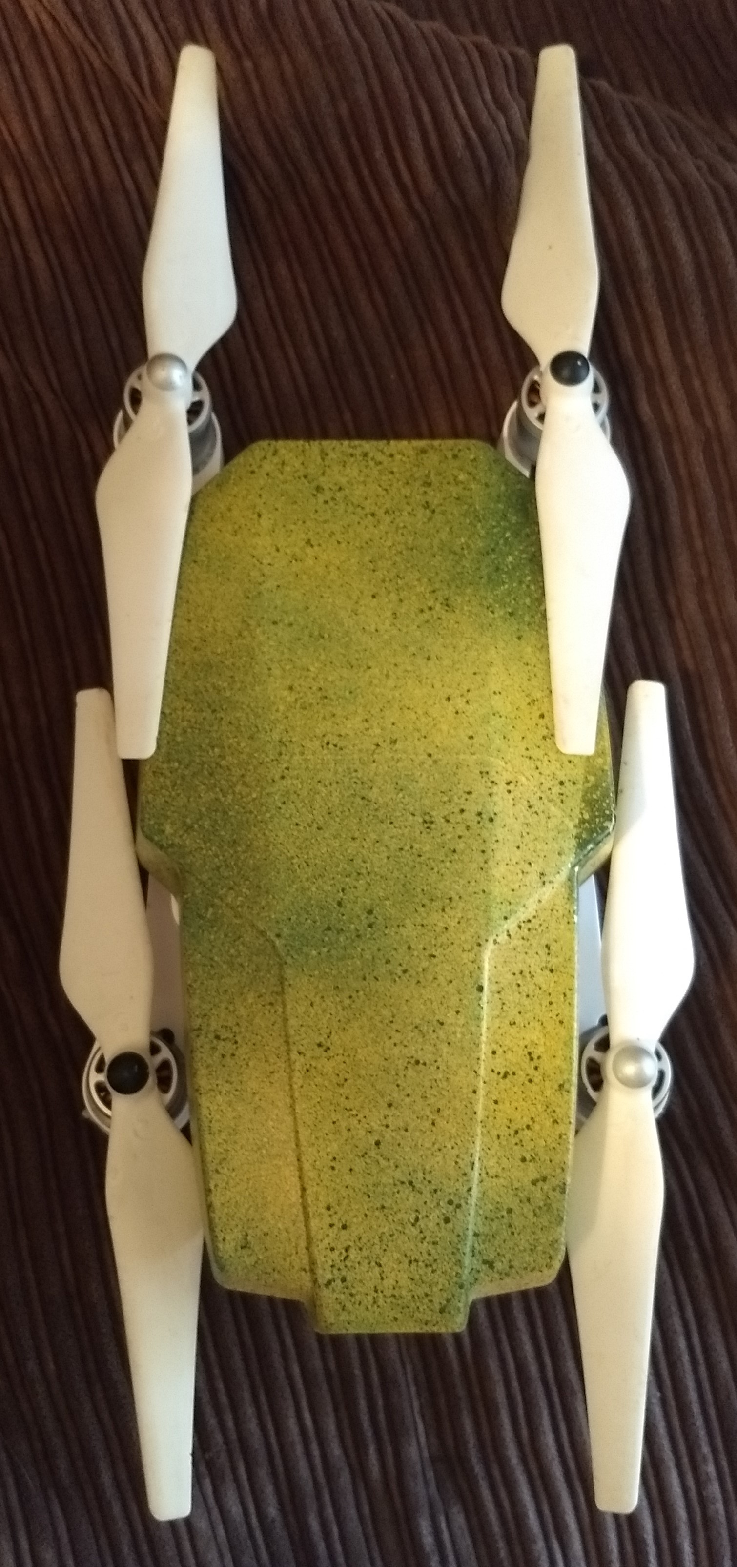

So, here is my build, flew perfect first time up. I am waiting on the new folding props I ordered last week, should finish it off nicely. I need to get someone to print that gimble lock for me. I also think I'm going to open the front arms back up and attach the original led lights to the underside of the front arms, they are thin enough that the arms will still fold up.

Regardless, first 2 flights were great, this weekend will be the distance testing.
Thanks to everyone before me that supplied comments, it helped.
