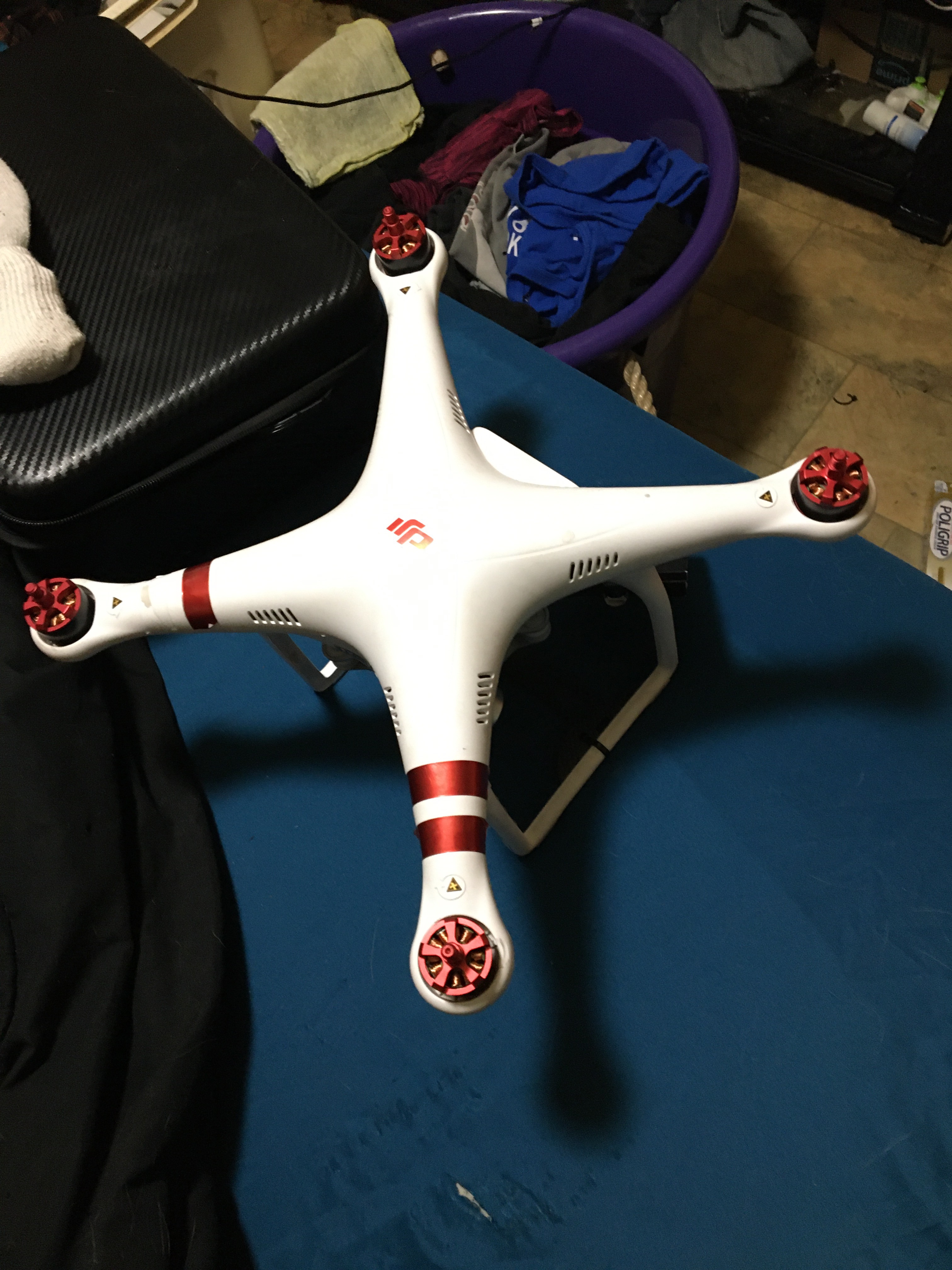

You can change motors I’ve changed mine to dji 2212/920kv motors and love them they spin up faster fly longer and are way quieter. You just got to do your homework and research the specs of the factory ones and stay in those specs
