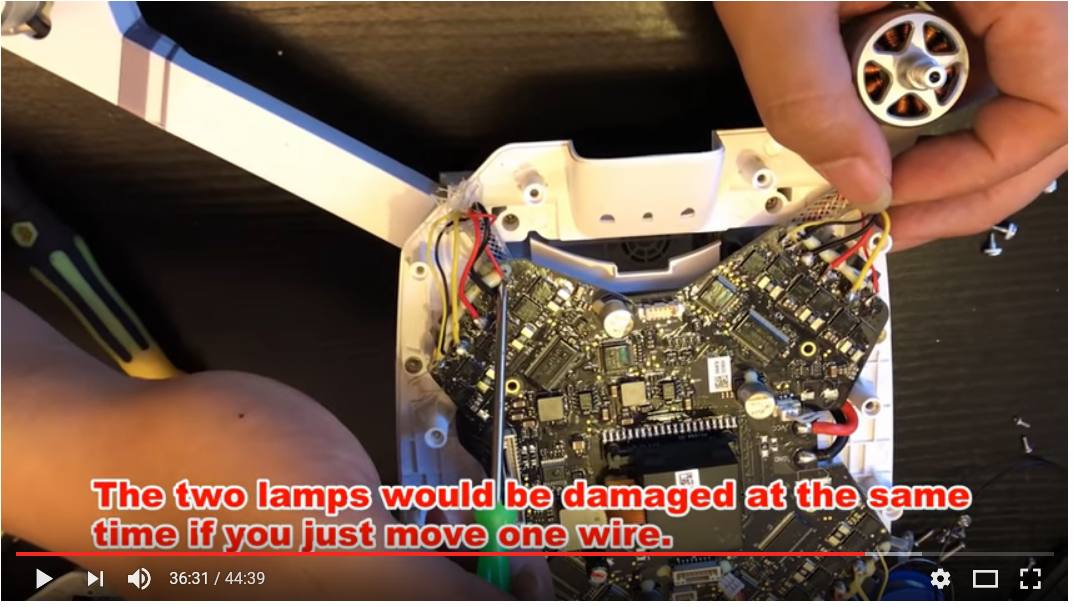

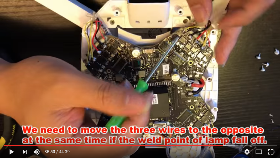

Can someone translate this chinese/english for me? This is my 3d mod and I can't get the leds to light up. I'm thinking these two photos relate too that but I don't understand what it means.

the photos are saying that the power for CW and CWW will be different. LED lines should all be the same. Did you solder to the tiny LED boards already?
Hi Digdat0,
You must solder the LED lines as follow:
V+ = RED, G = BLACK, R = YELLOW.
The V+, G, R are print on the board of the LED.
Initially I made a mess with two, so I contacted them and they send me five of them free of charge. (I paid $5 for postage).
I solder the new and everything OK.
