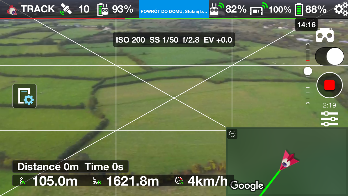

First test flight with 5.8 mod.
Going to tweak something and retest tomorrow. Looks very promising. 85% RC signal at 1.6km.
(without any stupid ar**ek and other fake antenna mods so don't inquire about antennas please)
Firmware 1.7.82
27dBm 2.4Ghz (ojczenasz mod)
30dBm 5.8Ghz (ojczenasz mod)
Original 2.4Ghz inside anntenas.

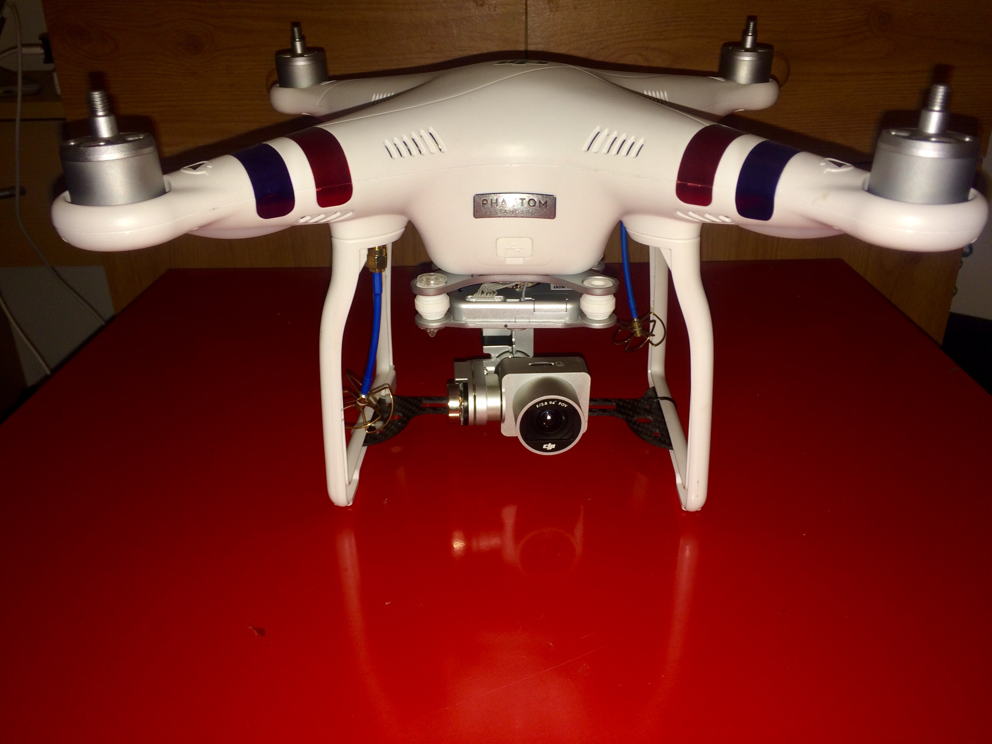

Small clover leaf 5.8Ghz antenna.
The clover leaf antennas on the drone.
Firmware 1.7.82
Firmware 1.7.82

2 km?.......that's a crazy distance for the Standard, bravo!
