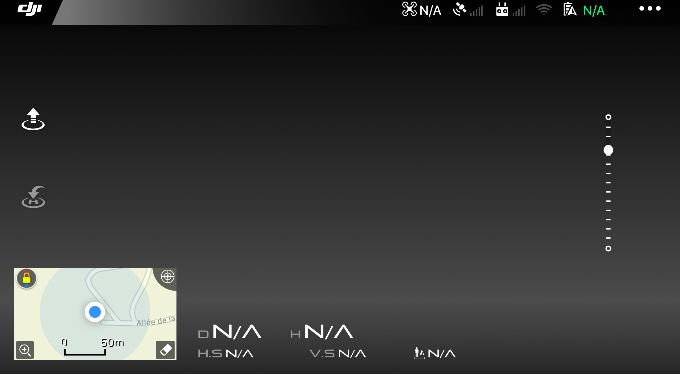

Hey there
I had issue with connexion between aircraft and RC in app
RC solid RED
No information in app , no camera feed , no information, distance, battery...the signal Is N/A
But RC work with aircraft correct
I can control with it and gamble and camera moving but aircraft flying with limited range ( i guess about 100m)

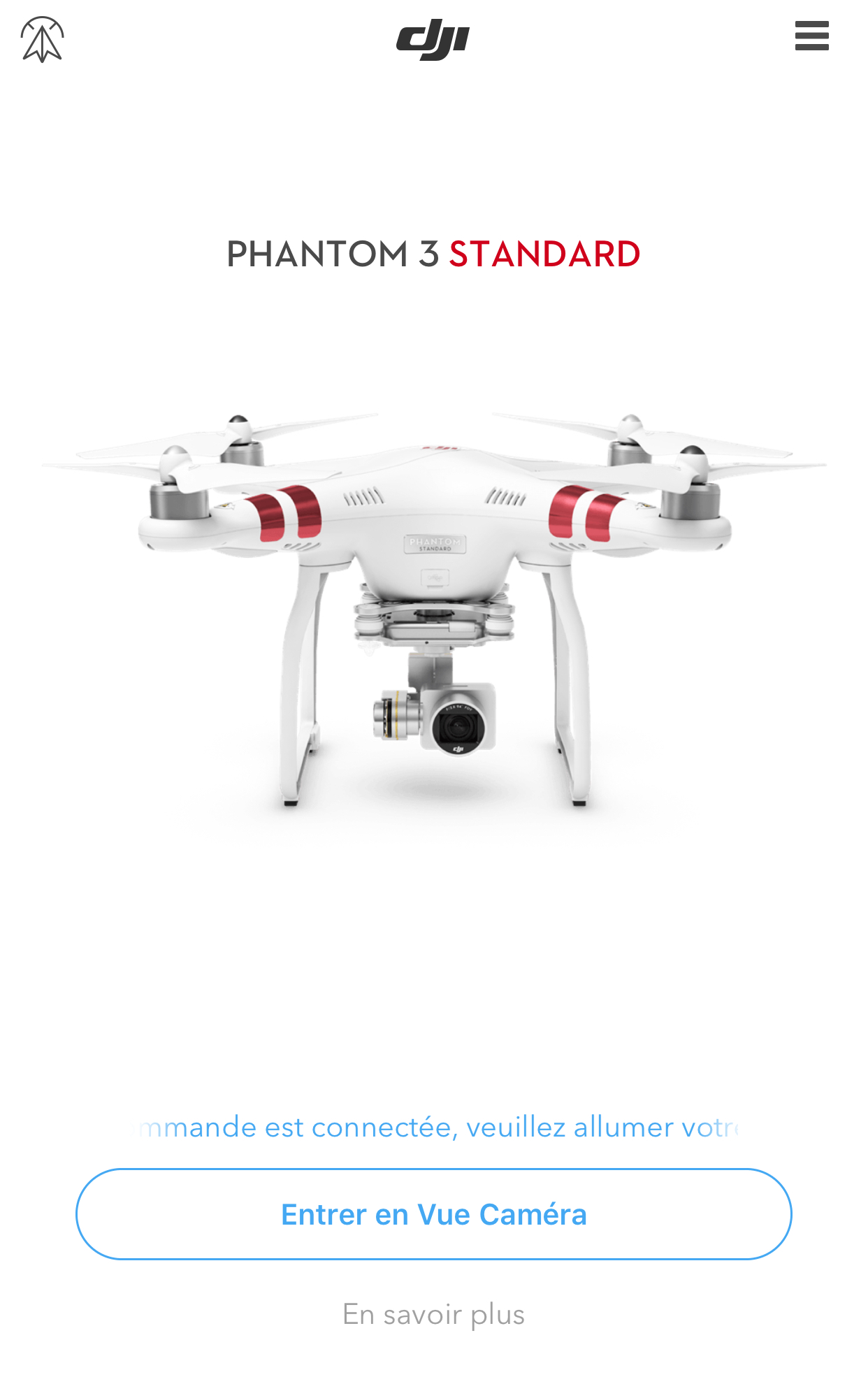

The RC Is connected to App the two in same wifi , view camera active i can enter to app but no infos there

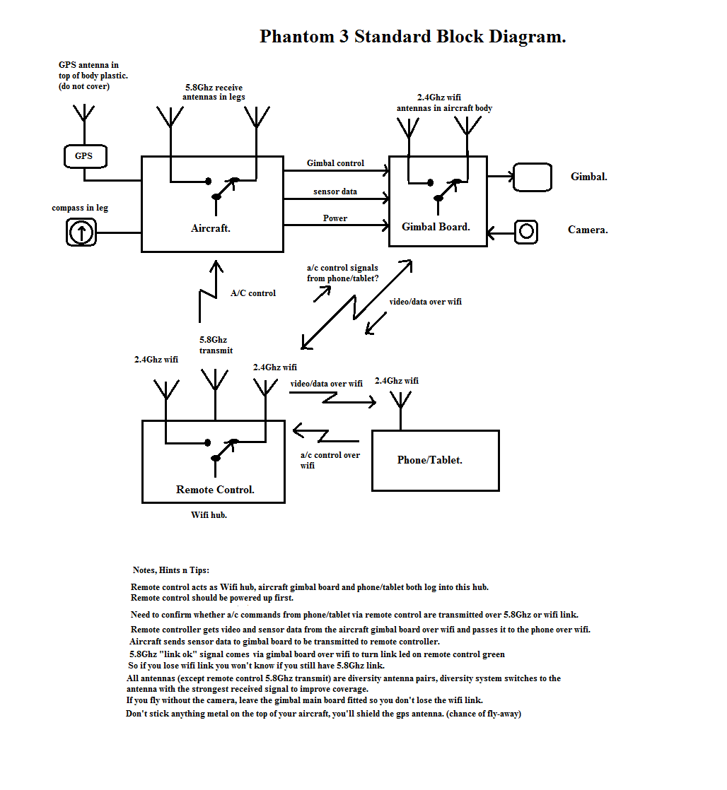

Hey guy, your English is making it tough for me. ;)
"But how RC can controlling to aircraft that thing i don’t understand "
Your Phantom sees the remote, the remote doesn't see the Phantom.
I'm looking for a diagram.
Look at this thread.
Some others recently on linking.
Rod
Found it!
Rod
Reactions: Capt KO

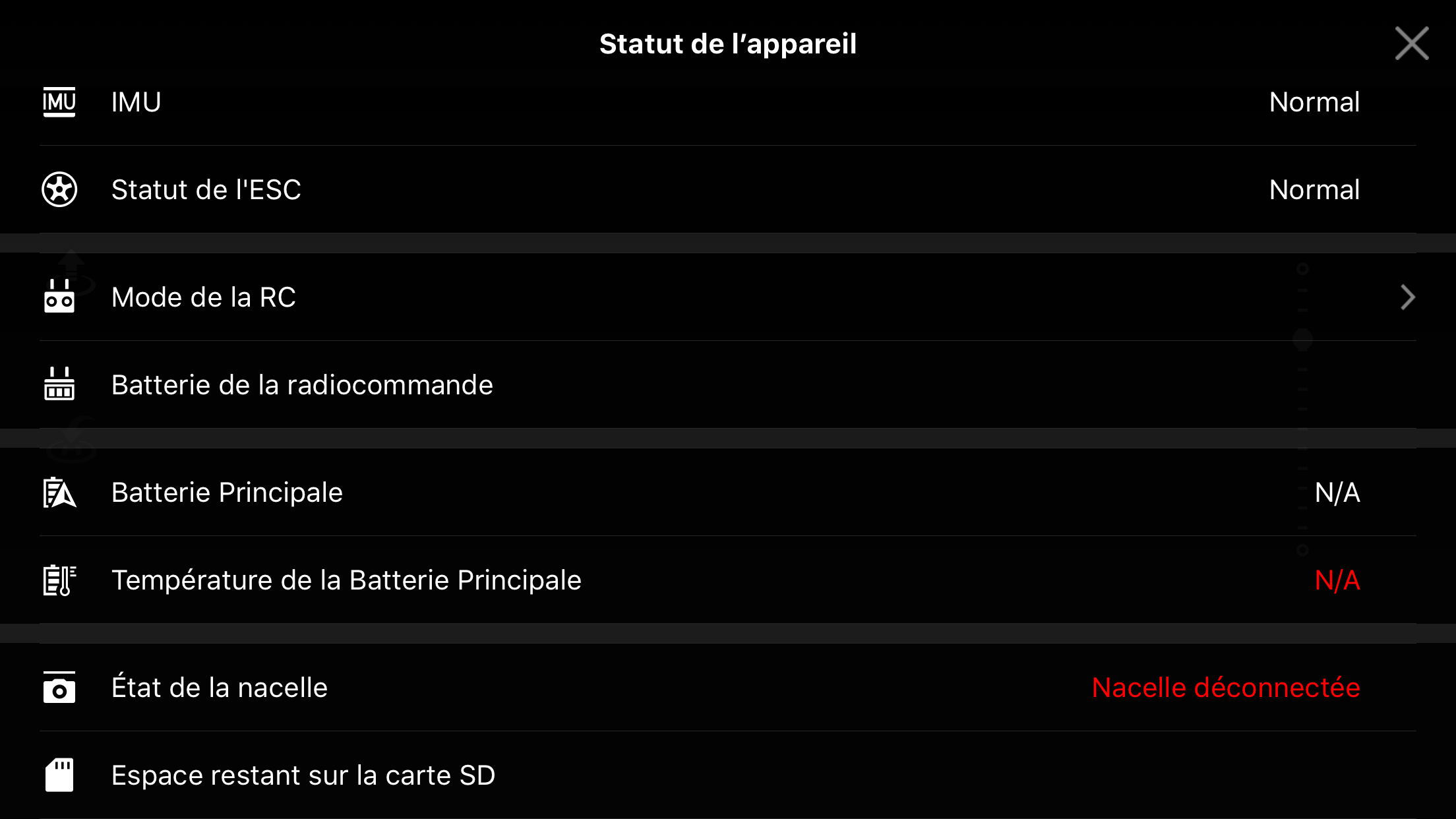

If no connection between AC via RC
So that mean the problem in gimbal board ?

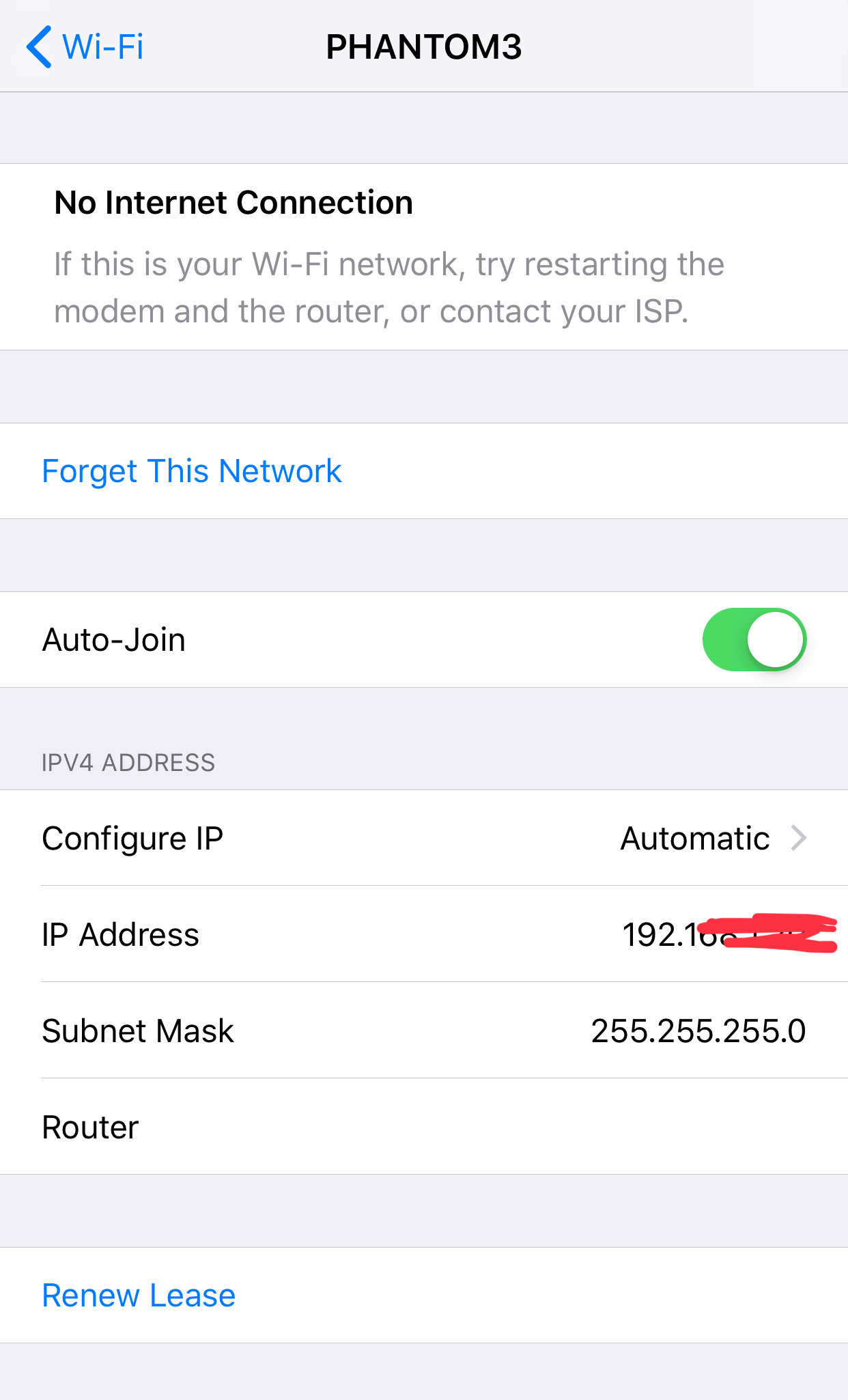

You can do a n IP-scan with a laptop with AngryIPScan installed. Connect the Phantoms WIFI and you can see in that program the IP of the RC. This should be 192.168.1.1 and the AC 192.168.1.2 and the laptop is then the 192.168.1.3. If the last IP address not shown on that scanner program then the bird can´t send the telemetry or a feed via RC to the mobile.
So since I have not used this program, but will look into it.
For clarification, I'm assuming the RC is issuing out usable IP address, the RC will always be 192.168.1.1.
The next connection will be 192.168.1.2 If it is the laptop or the Phantom?
Or is the Phantom always going to be at *.*.1.2?
" If the last IP address not shown on that scanner program then the bird can´t send the telemetry or a feed via RC to the mobile."
This statement will be very confusing to a lot of people, that don't understand IP addressing.
Next question, what IP address would your mobile device be at?
Can it be connected also?
Anyways, thanks for your input!
I will play with this when I can. ;)
Rod
