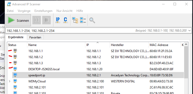

Here is a shot of the ip scan,the P3S IP´s are marked red.The first IP is the RC,the 2nd the AC the 3rd the WIFI daemon of the cam and the 4rth is the mobile or laptop. Through Phantoms WIFI you can connect only 1 mobile or laptop. not more
