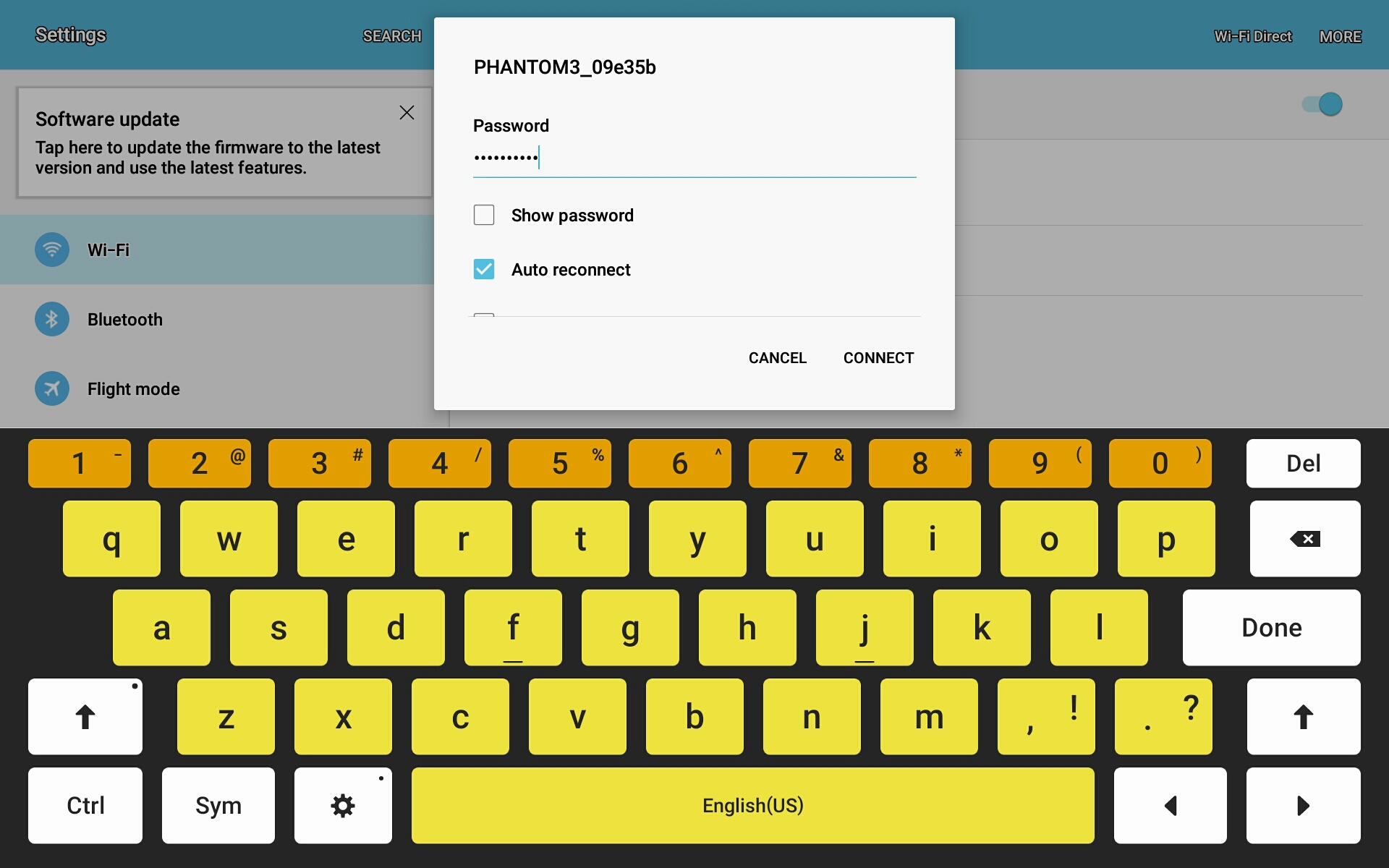

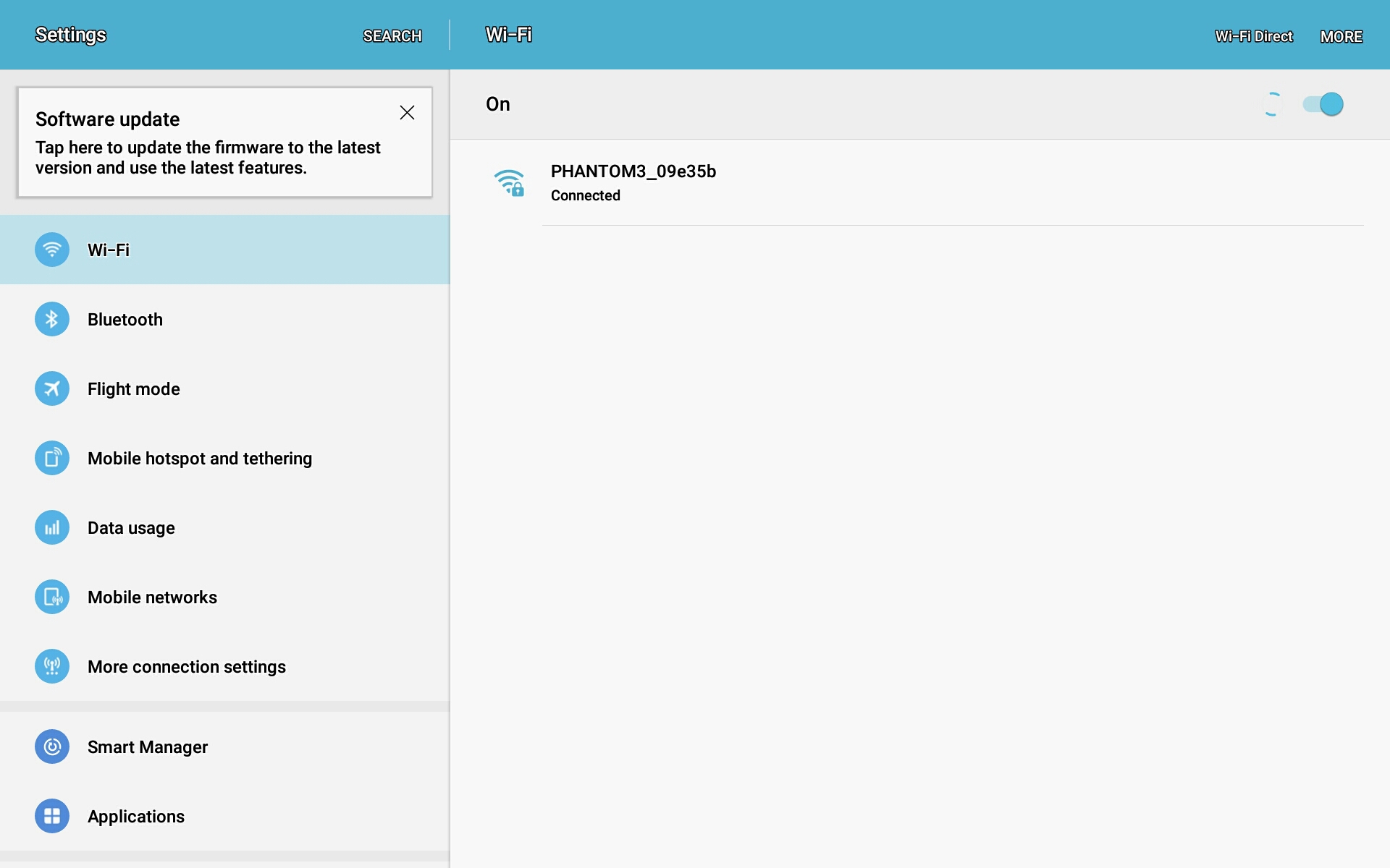

On your avaliable wifi networks have you tryed to reenter password 12341234 and pressed conect,what happens when you use djigo app under rc settings and use link button there,,does it just time out,,,

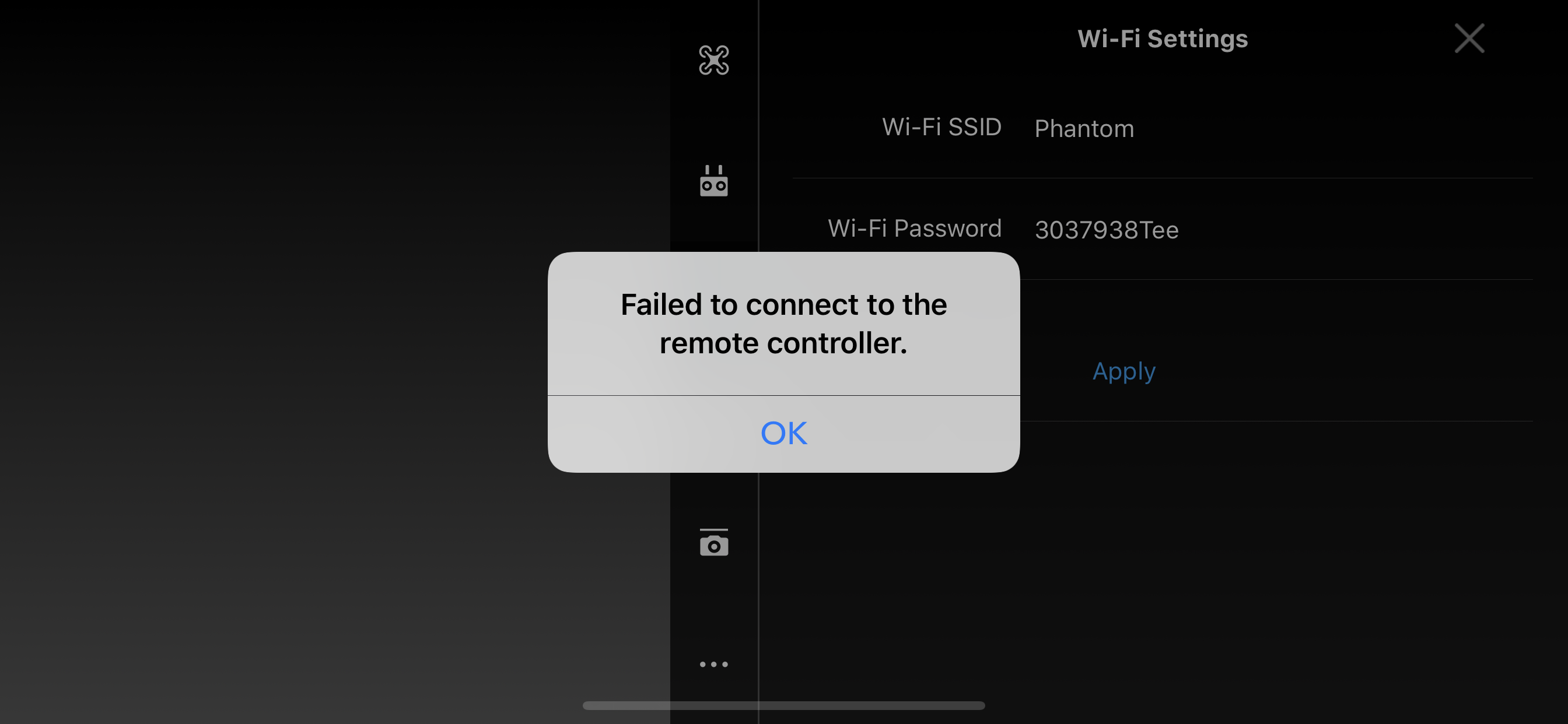

The selection for PhantomXXX isn't even in the available WiFi networks. Yes just times out in the DJI App. The actual app isn't connected to either device so it's no good.

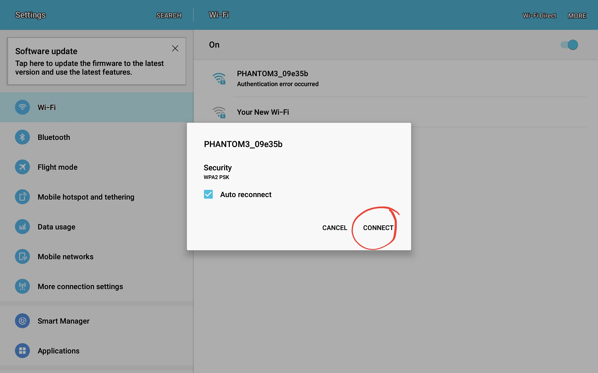

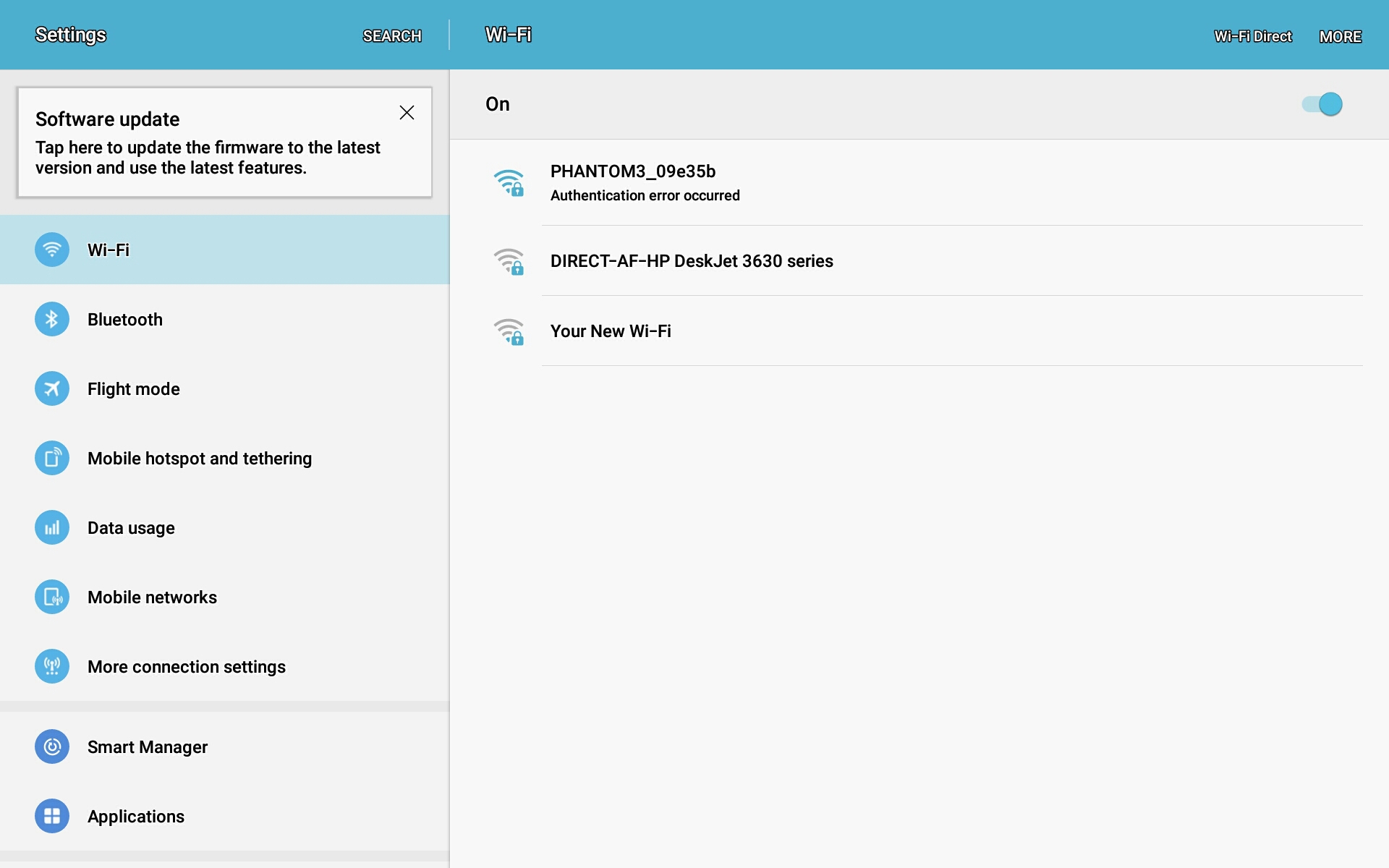

OK you might need to go into your settings like bottom picture ,,when trying to enter do you get authentication issue ,,you might need to reset password and enter it into wifi and press conect ,,,have you tryed this
There is no WiFi SSiD listed when the app is launched. I've tried renaming it and force searched for it from my WiFi setting on my iPhone. Still no luck.

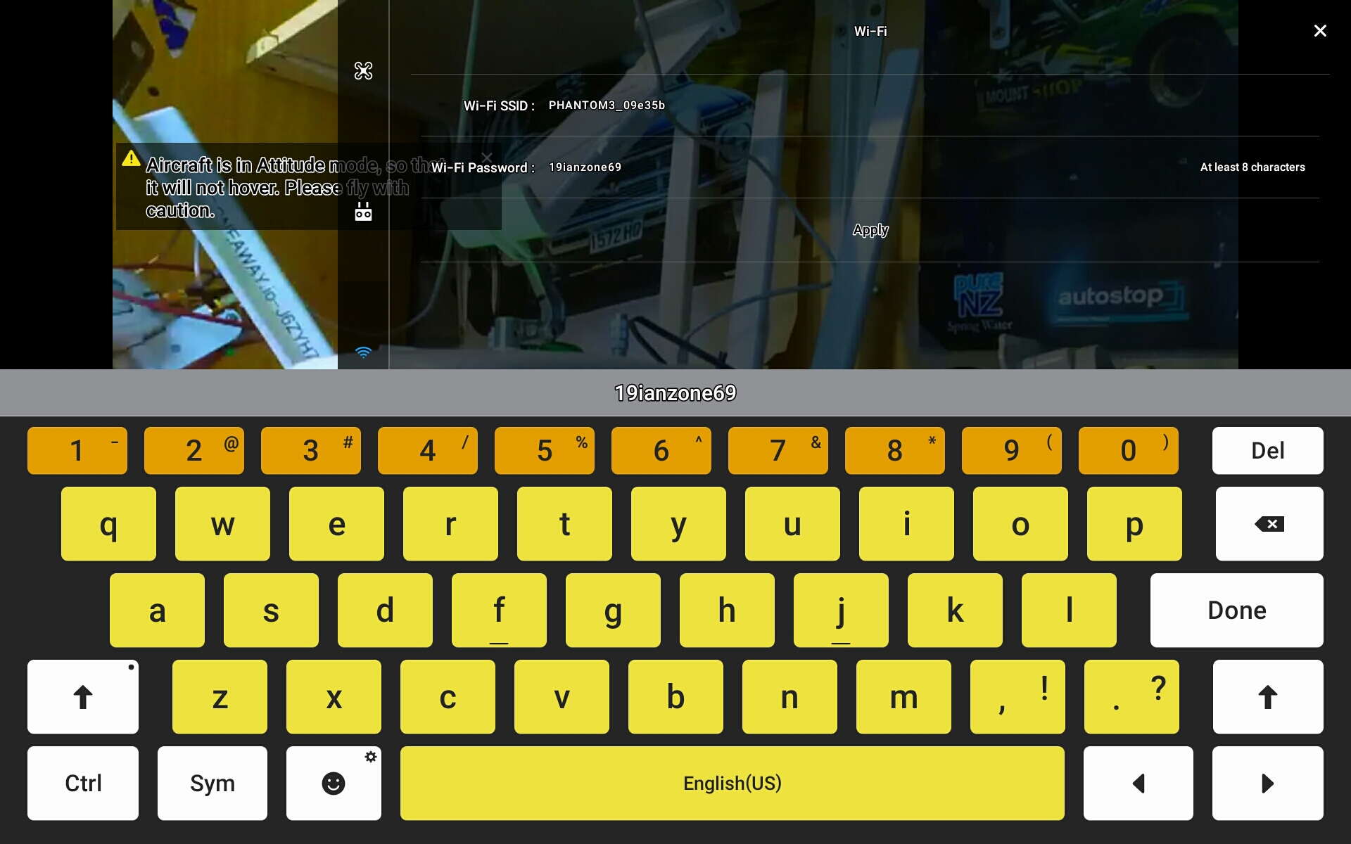

OK me get some pics of my wifi unconnected to help explain,,even if got disconected in app with no cam view you can still set up wifi to make it conect,,,wait one minite

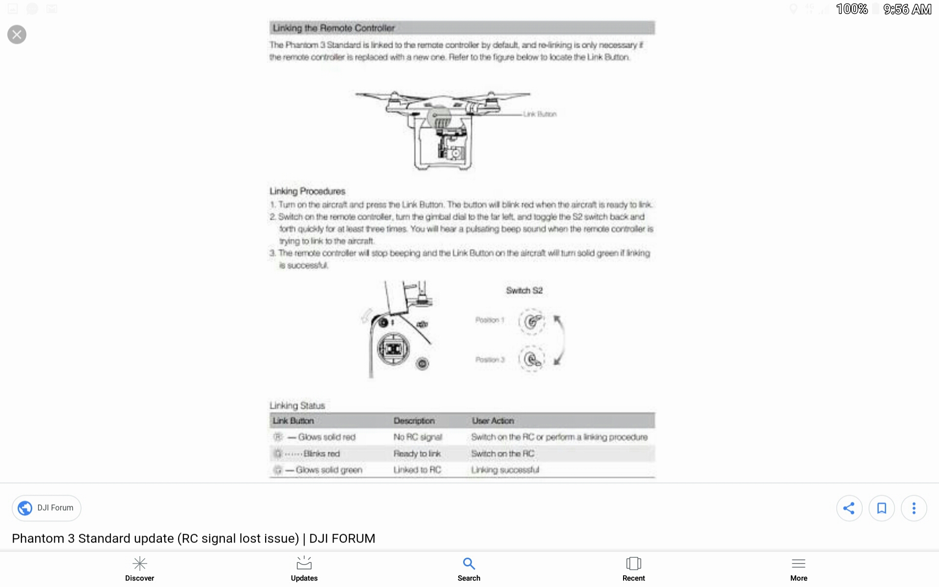

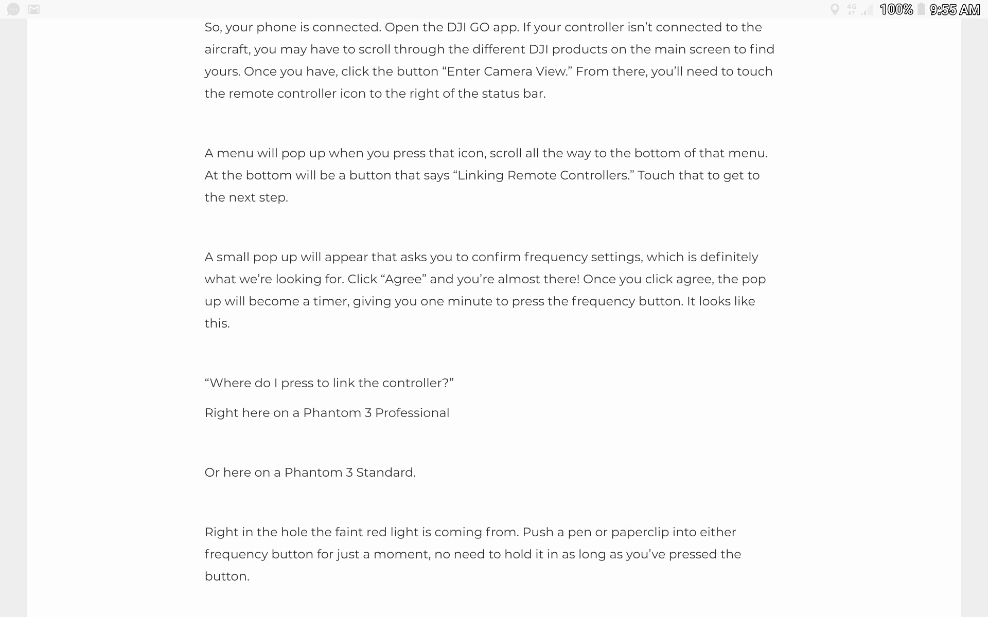

Interesting ok here what I did,,,,,have not seen that failed to conect to rc before,without the app at all do you have red light on remote when drone on,,it should link,I get relink picture for rc incase procedure not quite right

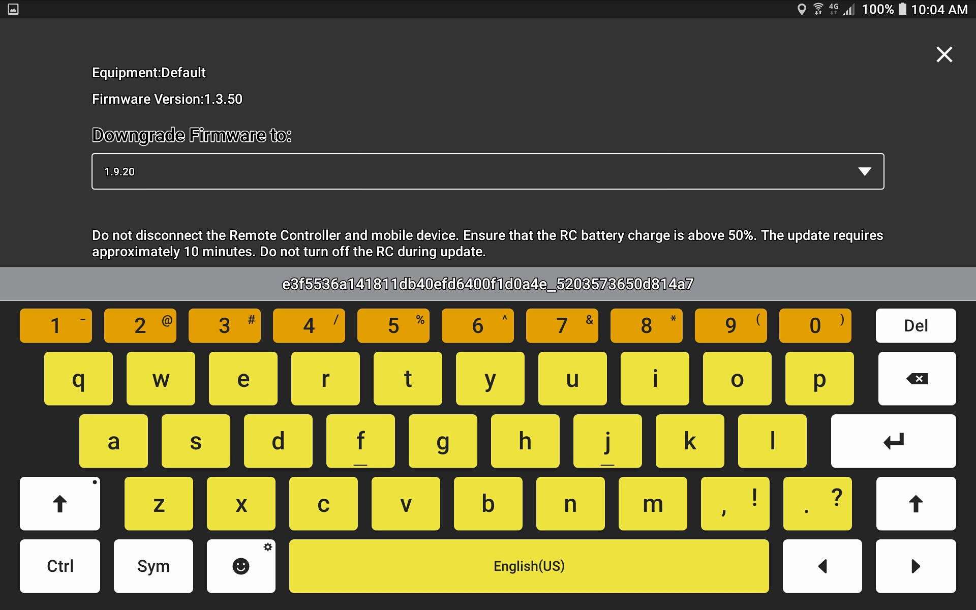

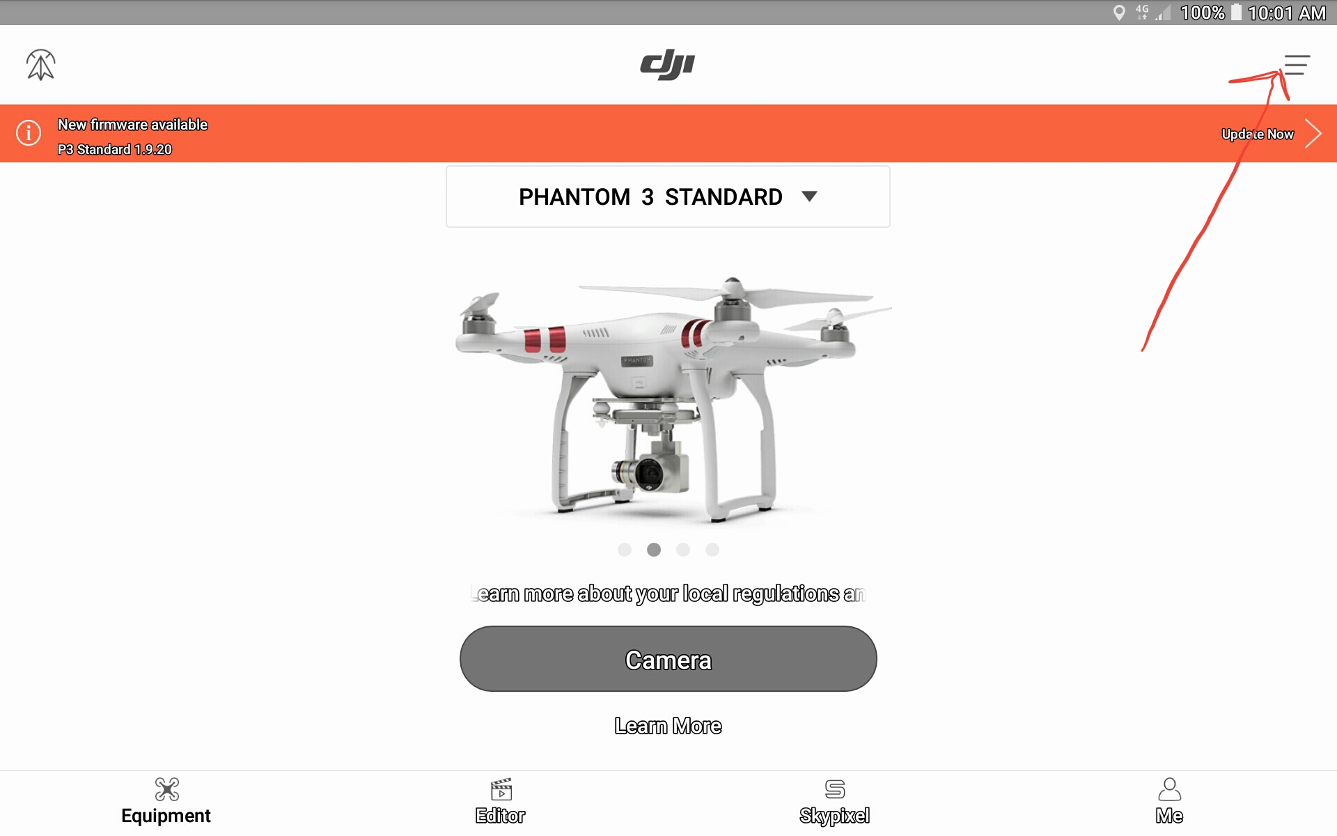

With ac and rc and device on get to this screen and press and hold 3 lines top right it might give you a roll back option on firmware like my pic shows,
It doesn’t have that option when my phone isn’t connected to the unit.

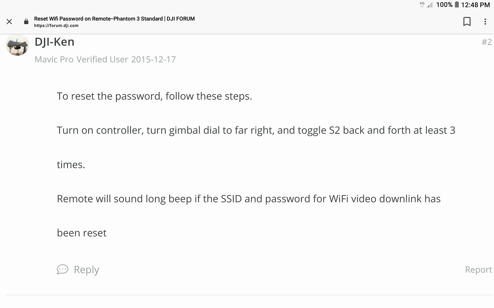

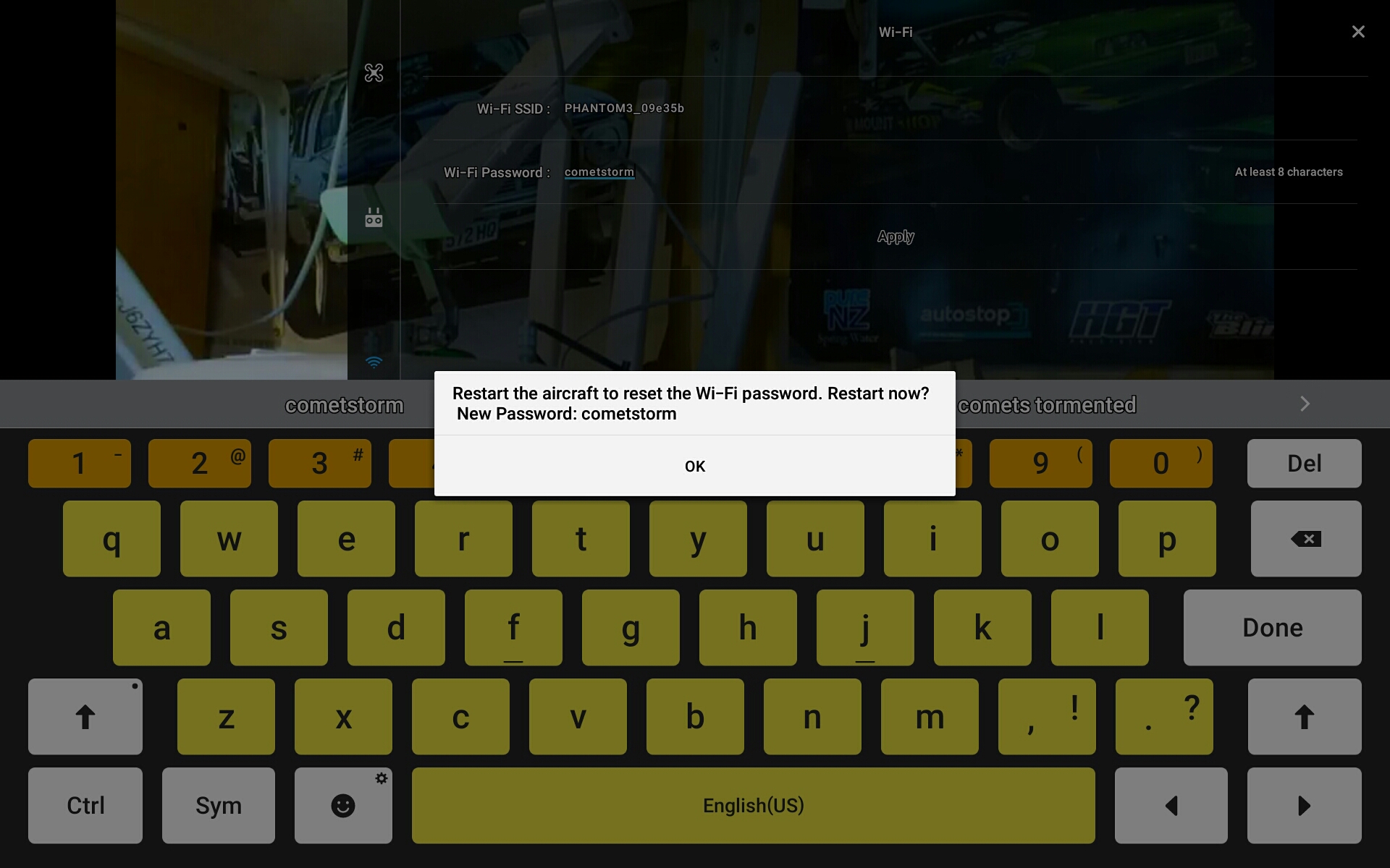

OK found this that might help alot,,,manual reset of wifi password....says here use gimble wheel aswell,,,please try this
