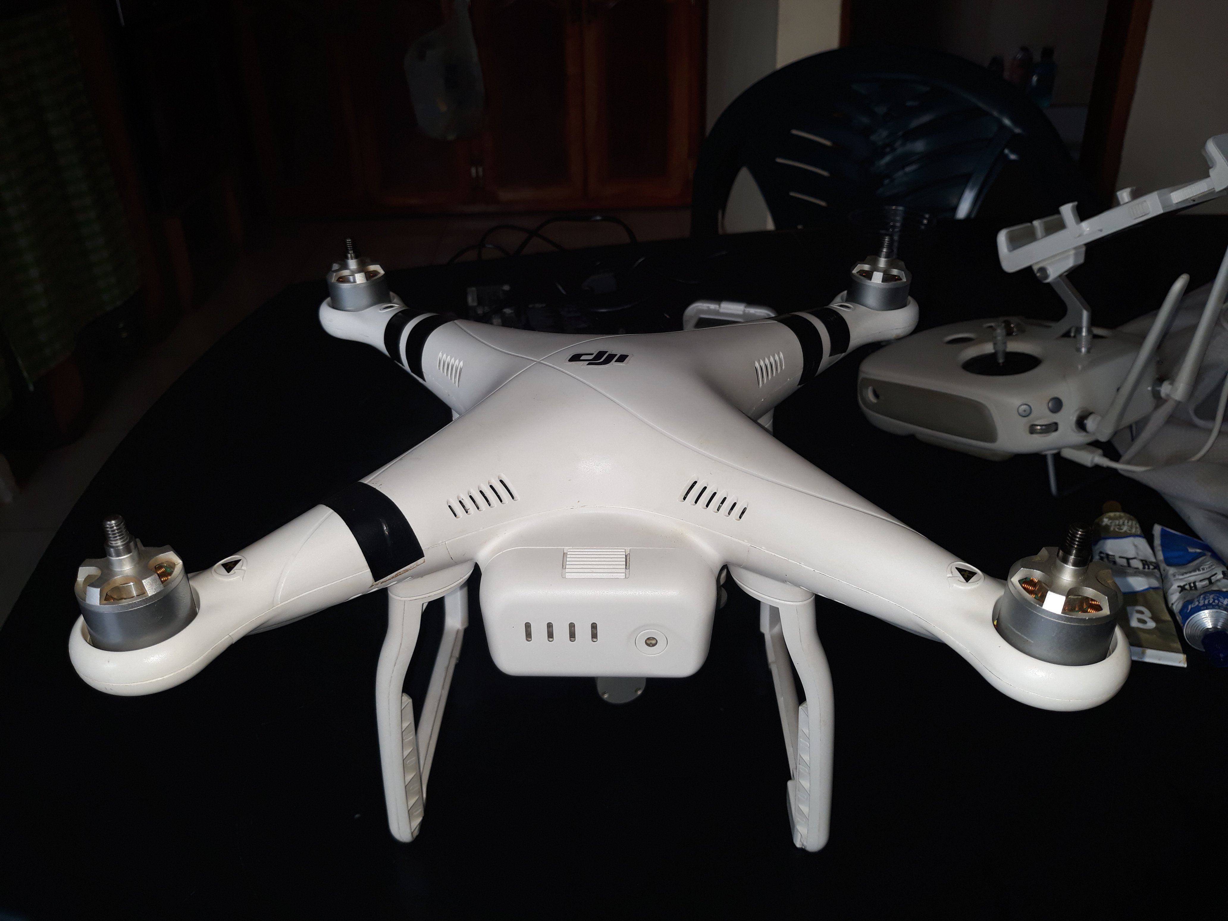

The style placemend off the motor that is a good point, I look for that but I don`t know what is the good style. But I open the upper shell and see the wires are all in same direction, the centre ESC board. But maybe good for inspection and I let show a picture. Spin is good...R/L

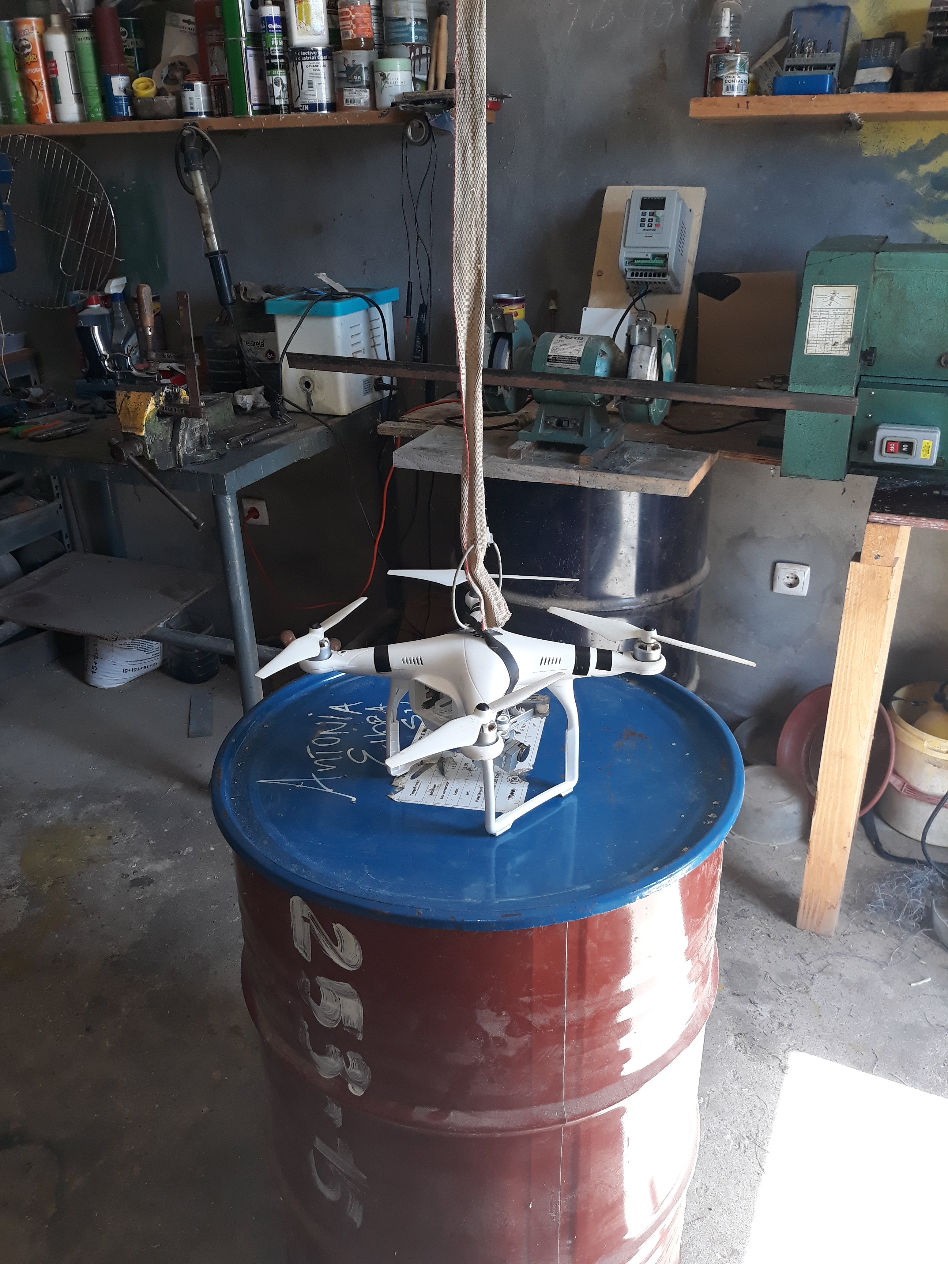

We put the drone on the drum, but the drone wan`t vertical take off. Only sliding too right. I am affraid because here is only mountain with rocks, and I believe the drone don`t like it.
If it were mine, I would never take off from a metal drum or from metal of any type. We routinely warn against doing so.
Missed the metal drum part. Ouch, asking for trouble. Compass out of wack. Almost good it won’t take off.
Do Not calibrate near metal! Or else...fly away and crash assistance.

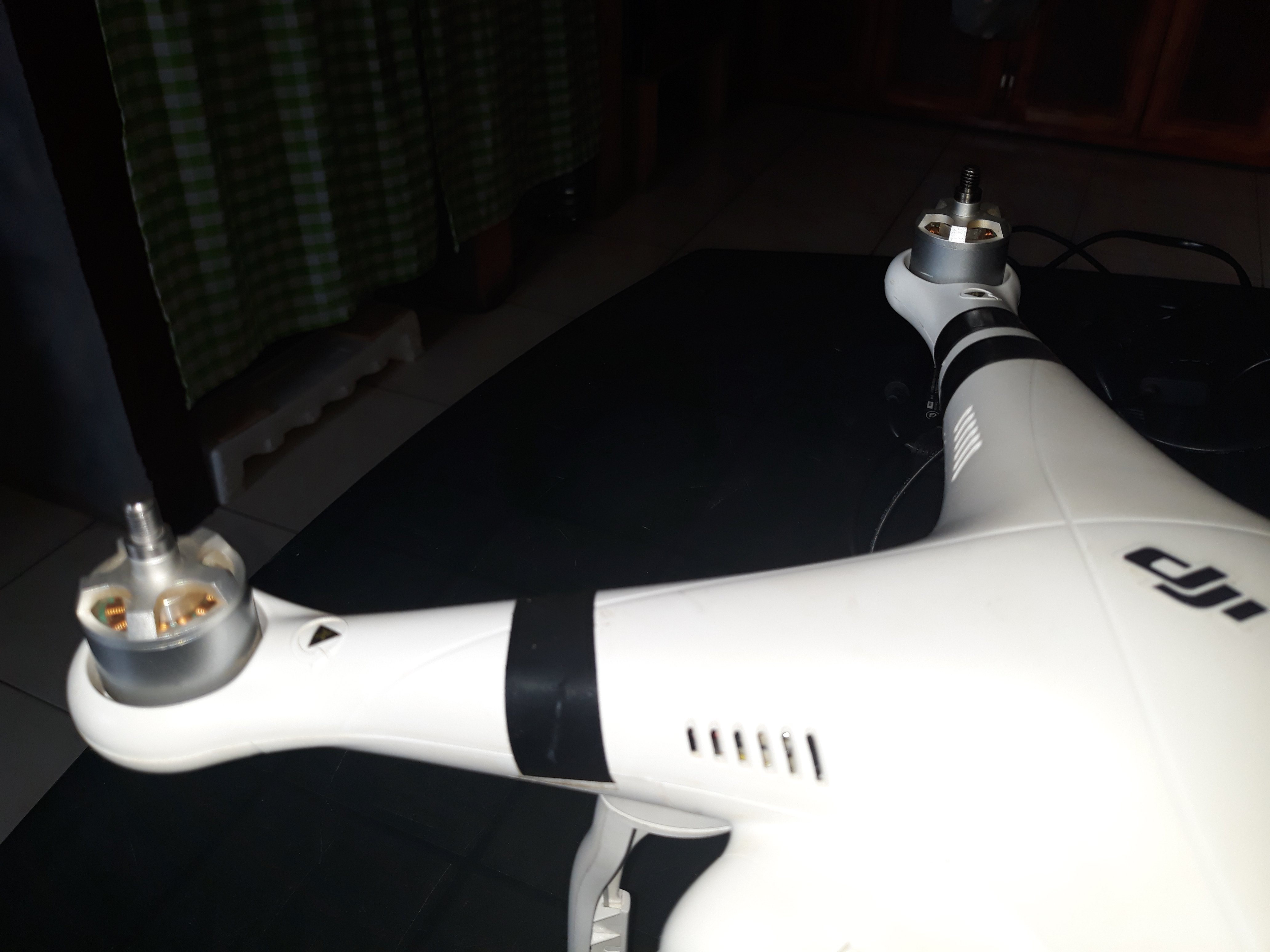

Hmm, by looking at the props, they all have a black cap on them. That seems to indicate that it has two wrong motors on it. Take the props off and check the color of the shafts.
Reactions: JoBe
Yep, the color off the shaft is different. two are more darkner... and the other two more shining. Thats why I thinking changed motors.
And the cap is black and used the second time. The first time I used the grey cap.
It’s supposed to have 2 dark and 2 light. The dark should be opposite of each other,and the same way with the light ones. Are the props spinning on in the same direction?
