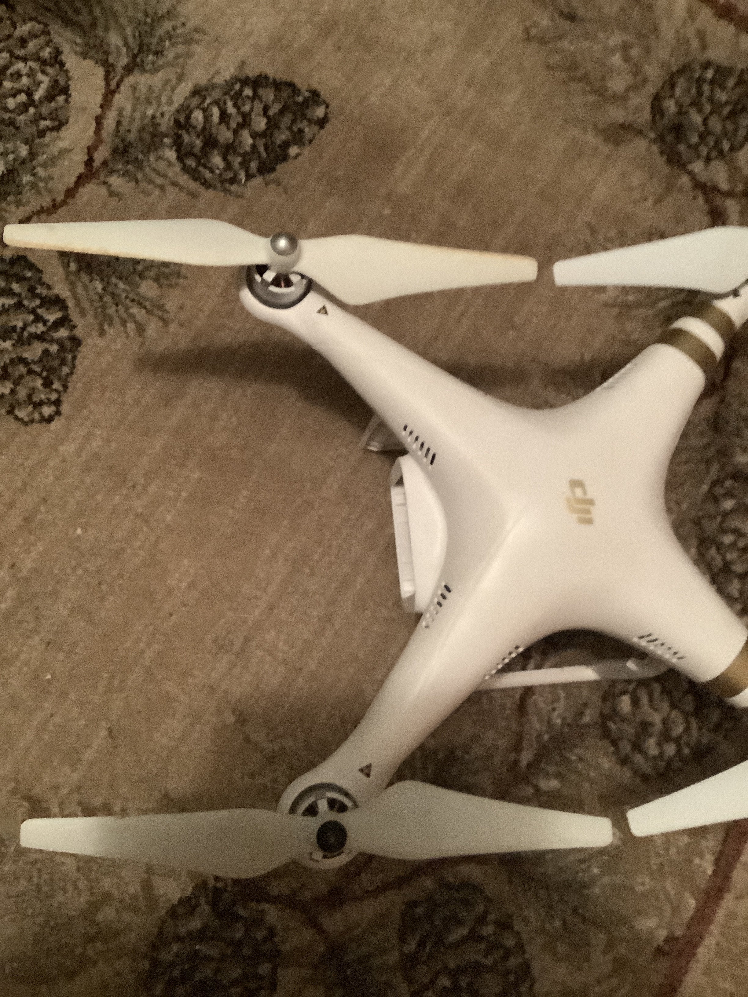

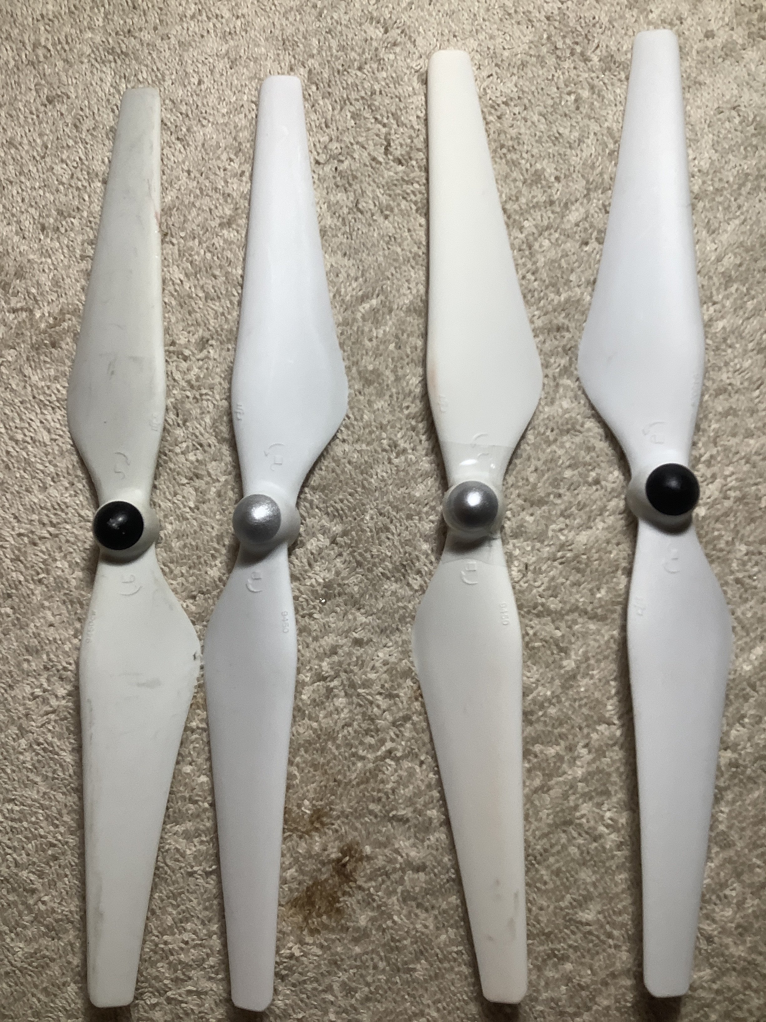

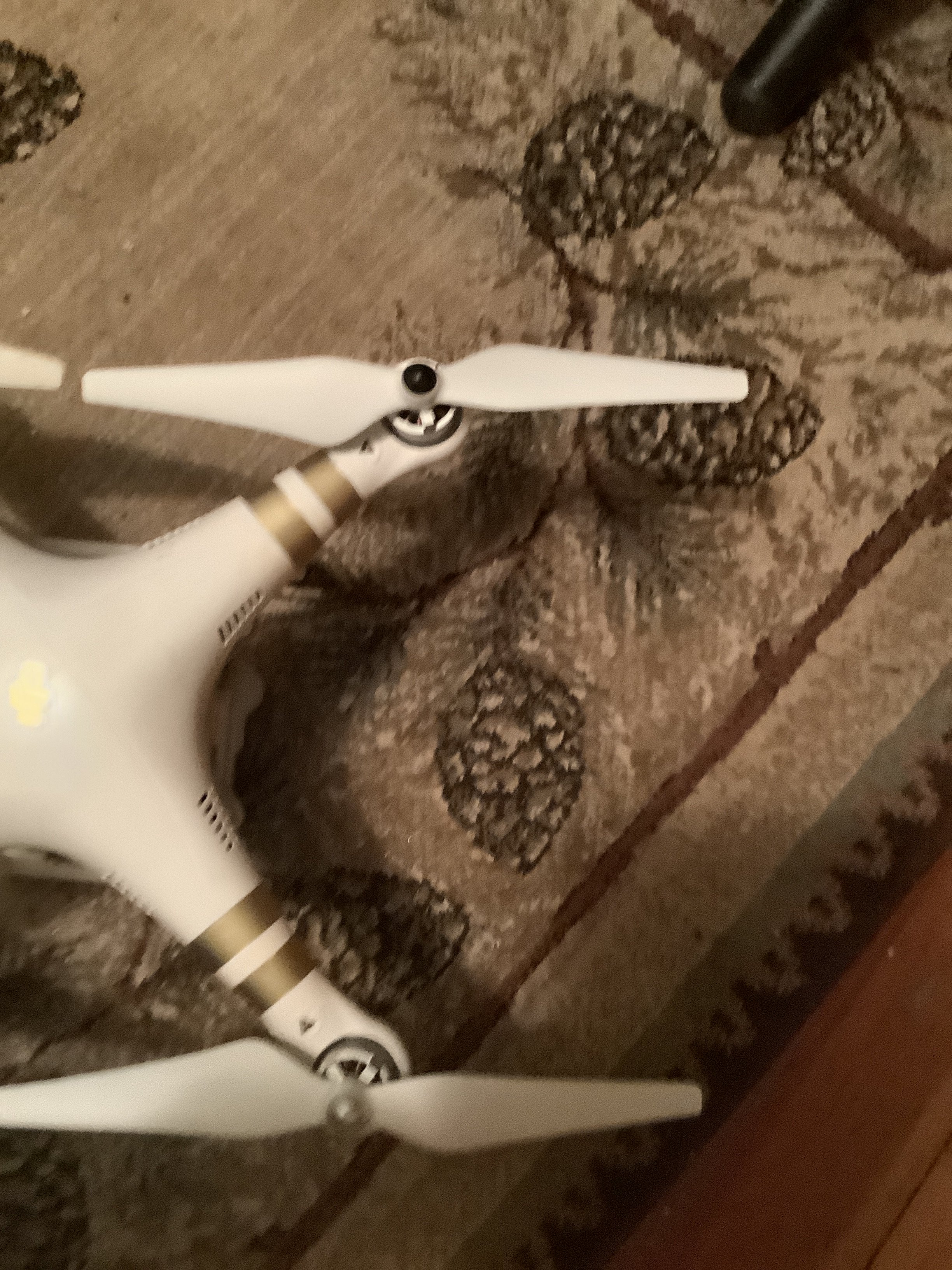

This is what your motors and props should look like.

Look at each of the props while they are on the drone, they are all tilted in the same direction. Look closely at the direction of the tilt of each propeller in my pictures.
Yes, now I understand and see clearly the differents. My fault, it is the first drone in my life .....a Phantom :D.

Your props are all pitching in the same direction.

Two of your props are incorrect. In the picture it appears that they all have the same pitch. The props on the opposite corners of the drone should have the same pitch. The downward pitch on the prop should be pointing in the opposite direction that the motor spins, thus giving the drone lift.
